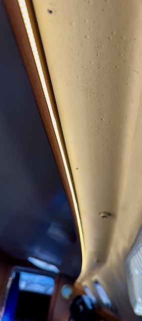

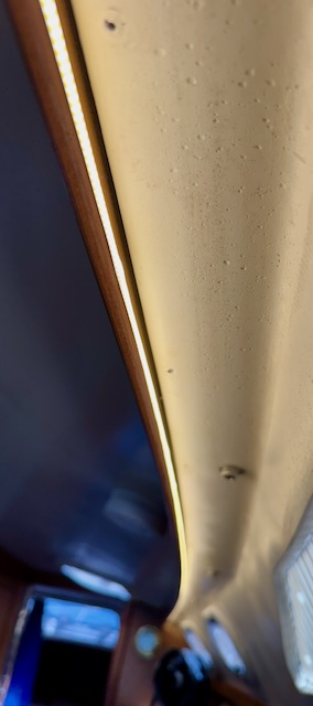

Recently I added two long strips of COB leds behind the top teak trim on my C36. The circuitry is embedded in a long flexible strip so they are practically invisible. In other earlier uses with exposed chips I used the aluminum channel with a cover and the adhesive had to hold the weight of the channel. VHB (very high bond) tape can easily hold the weight. These COB strips just stick onto the boat.
I'm very confident that the VHB will hold up just an LED strip. In my case I put them in aluminum channels and made some custom mounts to get them at the right height and angle. The ones on the mount have limited contact with the boat. I'm guessing each mount will allow for 2-2.5" of VHB. I plan on putting one mount every 12-18". The aluminum channels are very lights so it should hold up. Mine are in a similar location as yours but I went for as bright as possible instead of accent lighting. I have a wireless dimmer mounted on the companionway, 12 to 24v converter (24v system avoids voltage drops on long runs) and the receiver/dimmer module is hidden away. I'll be posting pics in a separate thread when it's complete
