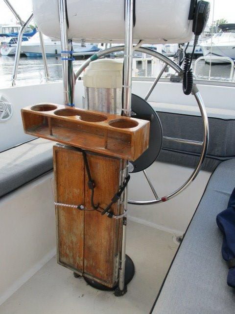

Our first boat is an S2 9.2 center cockpit, and we’re trying to clean and renew some wood before launching in a few months. The teak cupholder is attached to the pedestal guard poles with two cheapo clamps that are causing oxidation. (Galvanic corrosion maybe?) I think the guard poles are 1 1/8”.

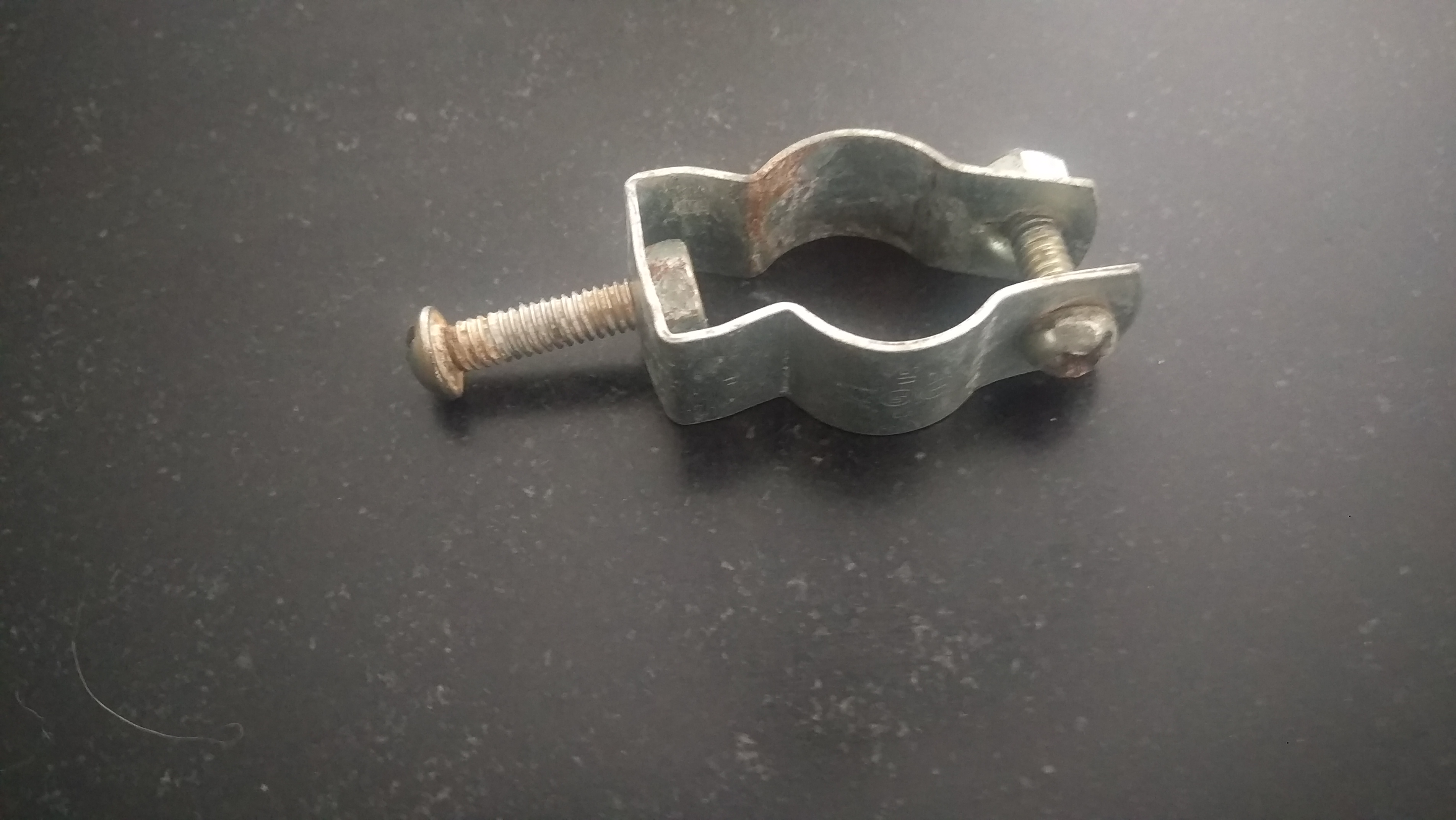

Similar clamps are holding a solar panel on the aft guard rail and they’re quite rusty.
I’d like to replace them with stainless steel fittings, with plastic or vinyl (or electricians tape) where the clamps contact the pedestal guard.

Here is the old clamp
It was holding the cupholder, which I'm trying to renew.

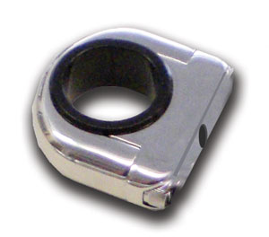

And this seems like a great fitting, but they are over $50 a piece.

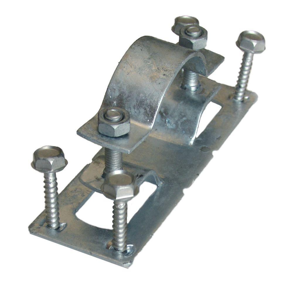

I really appreciate everyone's suggestions and help, and Terry Cox beautiful work! I'm kind of leaning toward a stair bannister bracket at home depot for $1.86 each. They're not what I wanted, and will rust out quickly, but at that price I can change them twice a season for the next decade and come out ahead, compared to the Edson or kuryakyn clamps that are $25 to $52. What would really be amazing is if I can find some stainless steel bannister brackets! I'll keep looking (since I have until April to get the table, cupholder, and solar panel remounted). Any other ideas are much appreciated!
