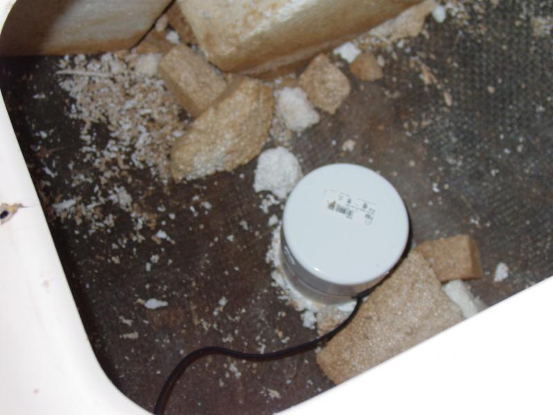

The biggest issue shooting thru the hull is to avoid someplace that has air pockets or a non fiberglass medium in the middle. IE it must be solid fiberglass. Then, for the purposes of a sailboat, they work great.
Since I hate external wires, I'd mount it inside the hull somewhere as opposed to a bracket on the outside, but I think finding a person who knows the hull makeup would be paramount. Of course you'd like it to be on a vertical axis, and nothing but fiberglass in between it and the water.
In the past, I've mounted them by grinding or sanding off dirt and oil, then holding a paper cup in place with a strip of masking tape. Pour in the epoxy and place the transducer in it as close to the hull as you can get. Support till solid. Try to not have any bubbles in the epoxy, they also detract from the performance of the transducer. The cup comes off afterwards leaving a very professional looking permanent mount.
