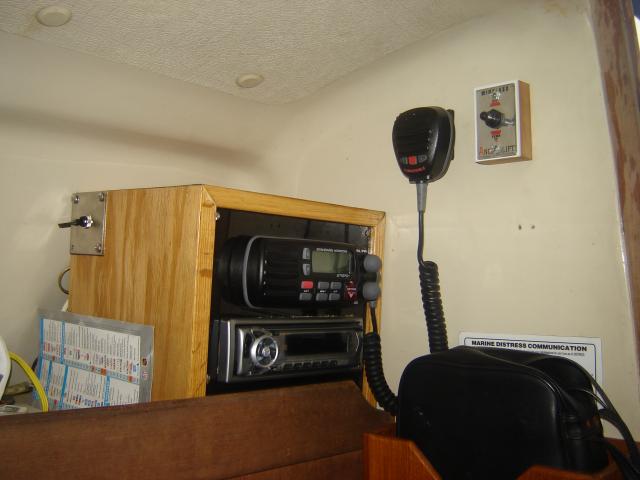

any way I mounted my windlass switch on the port bulkhead in the aft cabin reachable from the helm...there is space between the outside and inside for the wires but you'll have to mount the switch in a surface mounted box
