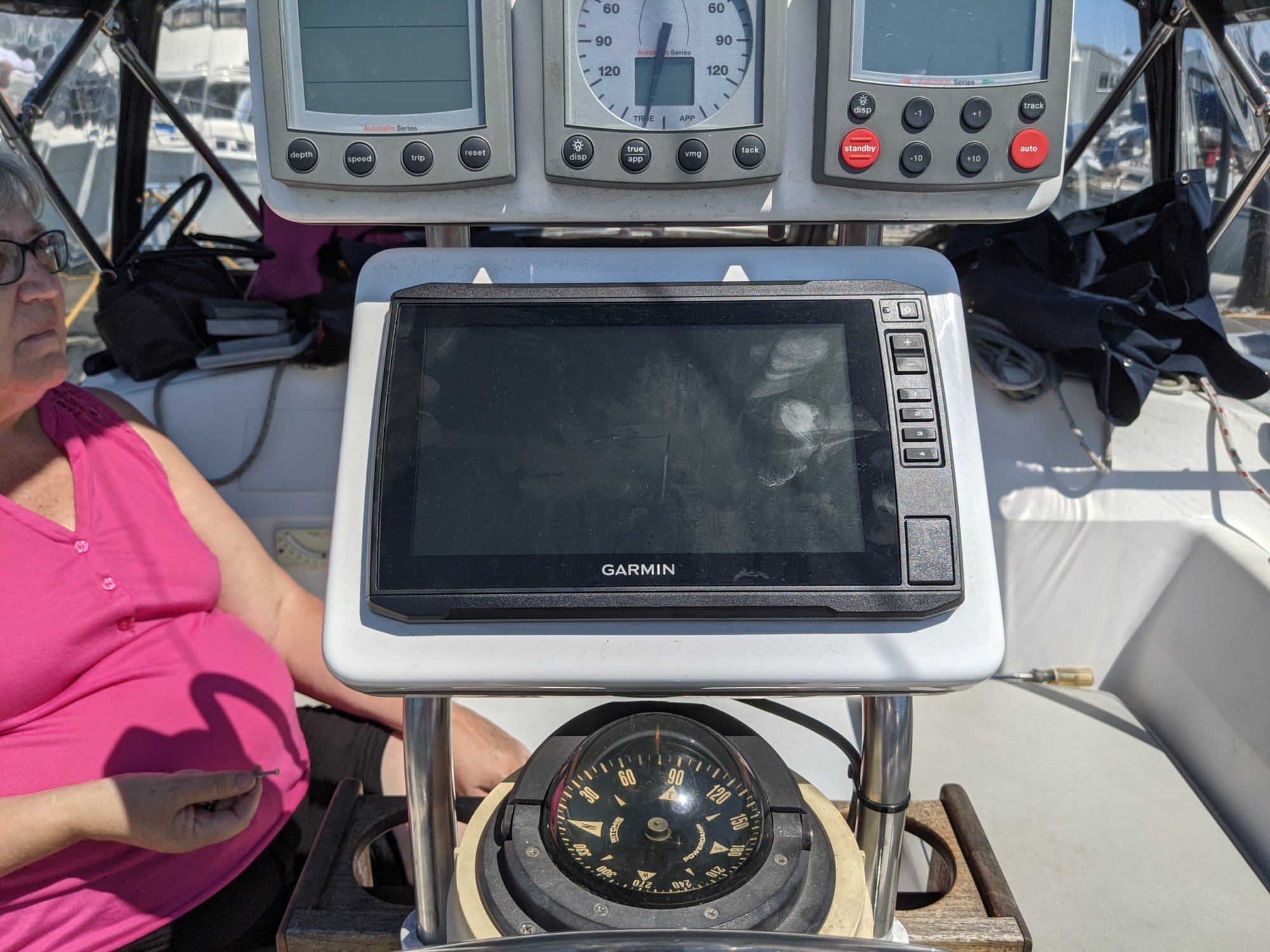

I missed this in my original measurement, and planning. I am making a custom mounting platform for a GPS and control head for an autopilot. I have a Garmin UHD 64 and just noticed that Garmin recommends 25.6" spacing between the unit, and my compass. I don't know about other boats, but I can not imagine any way to install the GPS (chart plotter) at the helm and still meeting this spacing "requirement."
Does anyone have any thoughts or suggestions? I mean if the chart plotter is too far away, it's pretty much useless to these old eyes. In all honesty, I don't see the compass as much use without knowing where I am so that I know which direction where I want to go is.

I am counting an that. The proposed spot for my plotter is almost directly above the front quarter of the compass, about 13" away, and any lines of magnetic force almost directly perpendicular to natural magnetic forces.

Ours is about 6 inches away. I'm headed that way now so I'll take a picture.

I finally got to test the Garmin chart plotter's effect on the compass. I carefully studied all 4 points of the compass. Then I put the Garmin where it is to be mounted, and watched for any variance on the compass. There was none. I repeated this, positioning the Garmin at various points around the compass, but at the same relative angle and distance as if mounted. These alternate positions are unusable as mounting points, but it let me simulate the influence as if the boat had rotated 360 degrees. No detectable compass movement at any point. Then, as a final test, I put the Garmin on the same plane as the compass and got detectable movement at every point around the compass at the same distance between the 2. I am only about half the distance Garmin says is safe, but virtually over head of the compass. My theory is that the more the distance is perpendicular to the plane of the compass, the less the influence, and therefore the less the safe distance.
So I feel comfortable I don't have a problem. If real life contradicts me, I will be sure to let everyone know.
