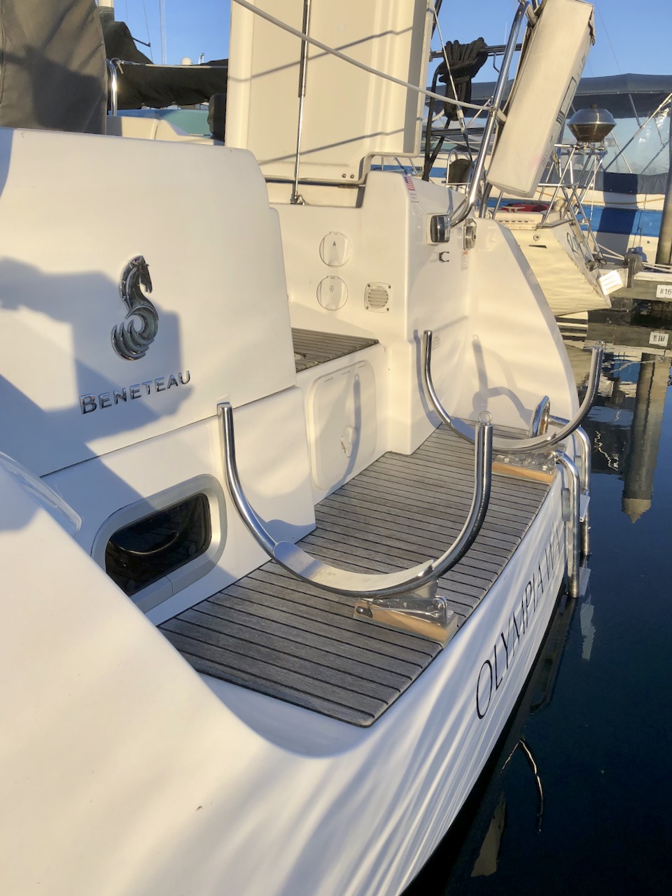

The davits are stainless steel c-rings which attach with quick release pins to permanently mounted brackets on the swim step (they also make a bolted on, non-removable set). I did have the teak surface cut out, and had the brackets raised on teak blocks, on top of a couple of pieces of G10, in an effort to clear the swim ladder on the starboard side. I haven't used them yet, and there may be some additional modifications needed so that my inflatable doesn't rub on any of the hardware on that side. When not in place, the c-rings can be stored just about anyplace that I want to put them. I have a small inflatable with a dropstitch air floor that weighs about 60 lbs.. With these installed, it will fit entirely within the scoop of my transom, and it will not be any higher than the top of my stern rails.
So far, I like them.
