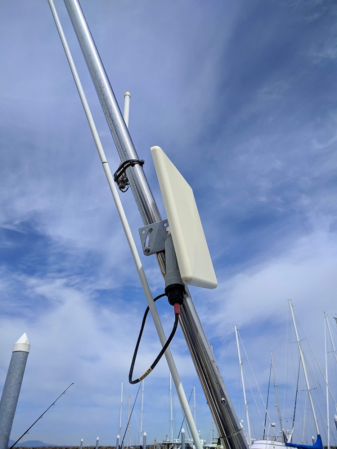

FYI, here's my setup with a Bullet Ti connected to a very directional panel antenna pointed at the onshore station near my home marina. When I go cruising, I just uncap the 8dB omni pictured behind the radar pole and switch the Bullet over to it to pickup guest wifi at the marinas we hit.

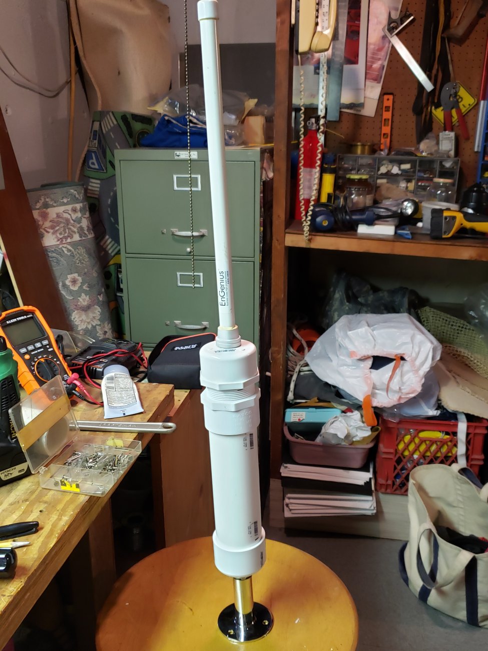

here is what I wound up with. I will mount on spreader and run Cat6 up and through a hole in bottom cap.
Thanks all for the help!

Looks good.. You can also get clear PVC so you can see the lights on the bullet...
