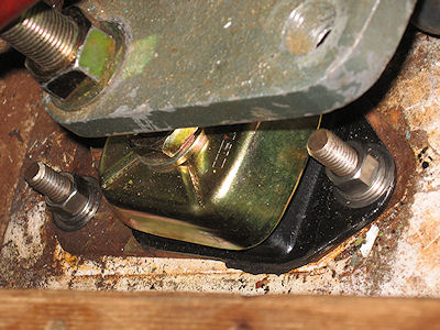

Hello all I am new to Catalina and this Forum. We are looking to purchase a 1988 C30 and just had the survey done yesterday. The issues that was noted starting from what I feel is the largest to the least is as follows:
1. Motor mount front Starboard needs replaced. (for now the engine seems to be in alignment but the mount is shot.

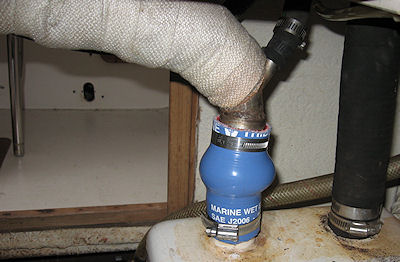

2. Exhaust elbow into the muffler is not leaking but is in need of replacement.

Question how hard / expensive is it to do motor mounts and exhaust elbows? Thanks for any advice you can give me as I have not committed to the purchase yet although we really do like the boat.
