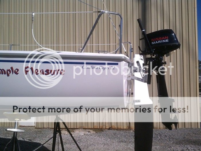

The attached pics show the final Motor Mount Bracket modification/installation on our 2006 Capri 22. The problem I experienced was that the Mount would drag in the water while motoring, not cool! Because, I learned to enjoy "Motor Sailing" when the wind dies down, I had to correct this situation! The mount did not have enough adjustment range, built into it, to lift the motor up enough to accomplish my objective. I did two things, One, I cut two additional slots in the bracket's adjusting arms to increase the Adjustment Range, to find the sweet spot and Secondly, I moved the mount up higher on the Transom to the next hole. Note, I also added a piece of 1/2 thick Starboard material, between the Mount and the Transom. I did this to move the motor away from the Transom to increase the radius of the "Remote Control Cables" I was adding. Since I planned on keeping the Motor mounted to the boat during trailering, I added a reinforcement Board (not shown) inside the Transom to better support the Motor. You can see the "RC Cables" and the extra Adjusting Slots in the picture.
