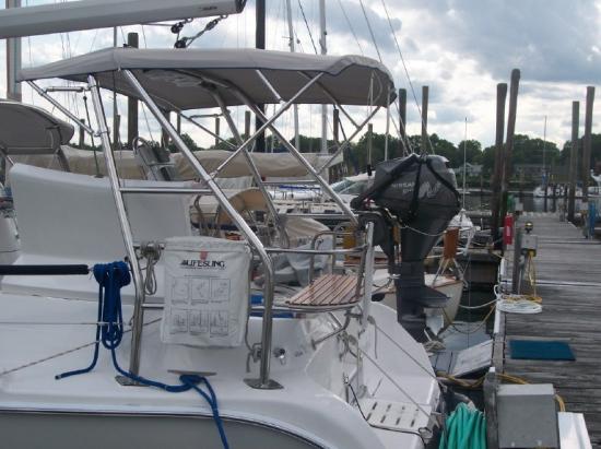

Has anyone added a Motor Lift to their H 44 AC? I have a Nissan 4 stroke weighing in at 87 lbs. I have looked at the many models of Motor Lifts but none seem to have the height or the reach that I need. I have a call into Garhauer (spelling?) and they seem to be willing to modify theirs to meet my needs. I will folow up with pictures and see what happens. In the mean time I am open to suggestions and ideas from others. Thank you. Bob

I have a Forespar Hoist on my Beneteau 323 which has a 220 pound capacity. It is set up to handle my 8hp Yamaha engine, hoisting line is led to a primary winch as needed. Check the Defender Catalog for others as well.

I have an Ocean Marine unit for my Yamaha 4stroke 4HP at 67 lbs. I can put it on my dingy with one hand. Very easy to use. My unit is mounted on a radar pole that holds my TracVison sat TV antennna, but Ocean Marine makes a pole that attaches to the stern rail. Good system - would highly recommend. I would post photo, but lately cannot do so due to Norton.

I purchased my motor lift from Garhauer and did not have to do any modifications. There is enough height to get your motor up and onto the rail bracket.

I recently chartered a Naticat 37. This privately-owned boat spared no expense, right down to the bow thruster. Except, the outboard lift had only a 2:1 tackle with an eye-level cam cleat for a Honda 9.9 4-stroke which weighs about 118 lbs. We passed on the suggestion that a 4:1 would be better, or somebody is going to drop that engine into the water. ...RickM...

And the Garhauer Crane comes with 6:1 tackle.
Mine's on order. I'll let you know how it works and looks. (Oh, it's to lift our 25HP Yamaha-120 pounds)

Thanks for all the impute. Ocean Marine Systems cargo lift (CD 175)was a close second but I think the Garhauer will work out fine for a lot less money. Thanks again. Bob sv Kathryn 2, Stamford, Ct
