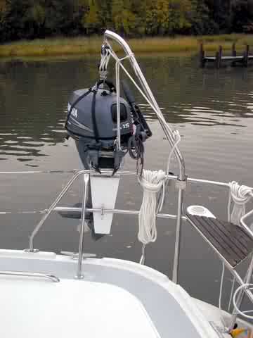

I think what the question is asking about is a small hoist/crane to lift an outboard off the dinghy and stow it clamped to the stern pulpit while towing dinghy or deflating if an inflatable. Not an outboard mounting bracket that is bolted to the transom to allow using an outboard to power the O'DAY 34/35. I've included a picture of one type of this lift, from Kato Marine.

Yes Sunbird is right. I should have been more precise. Looking to lift a 6 hp engine aboard not power the mother ship. The hoist is removable but needs a permant base bracket that I would like to make removable too.
