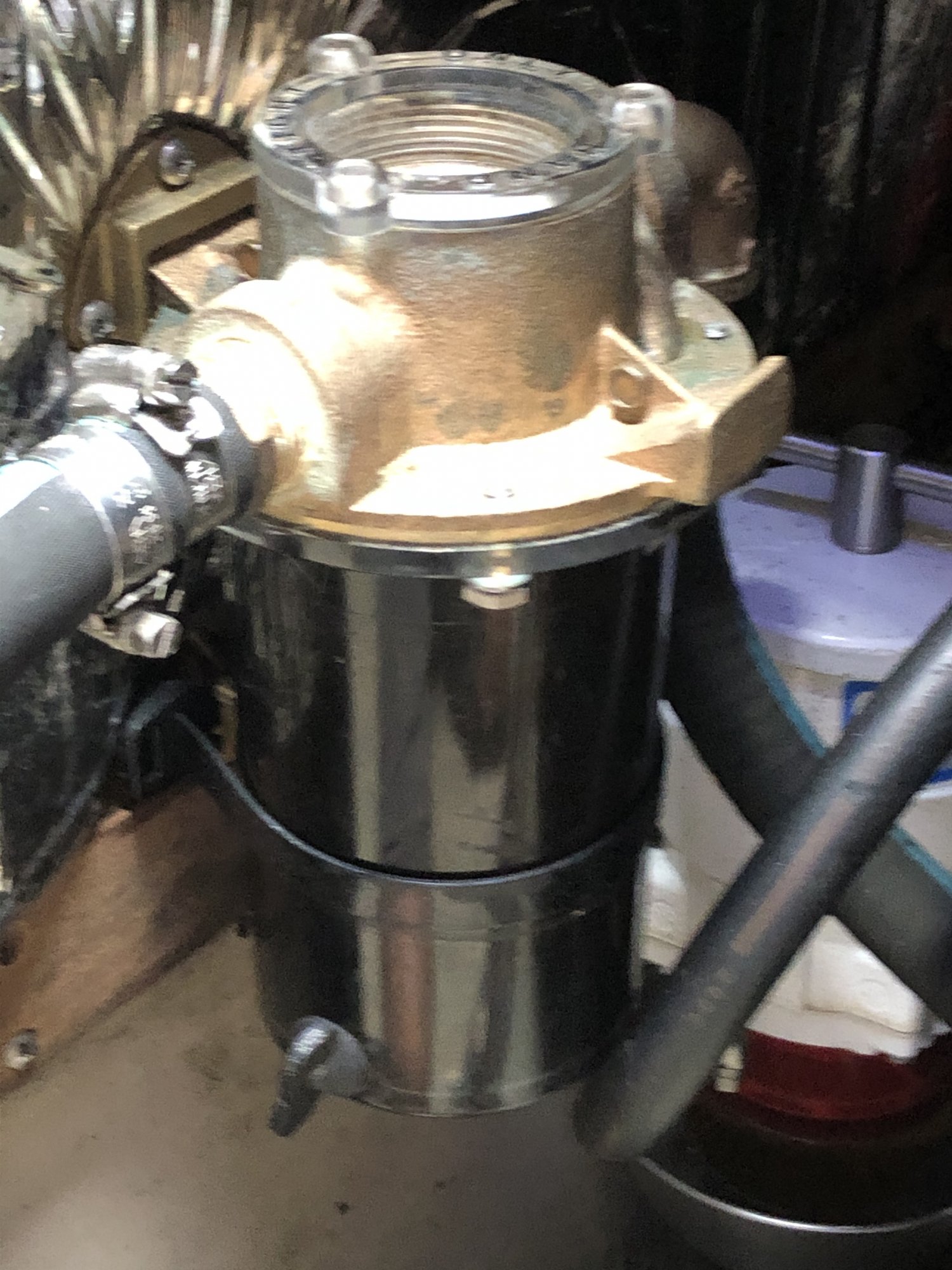

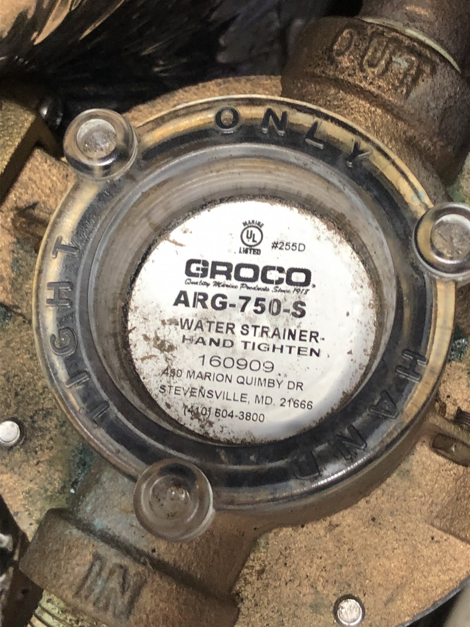

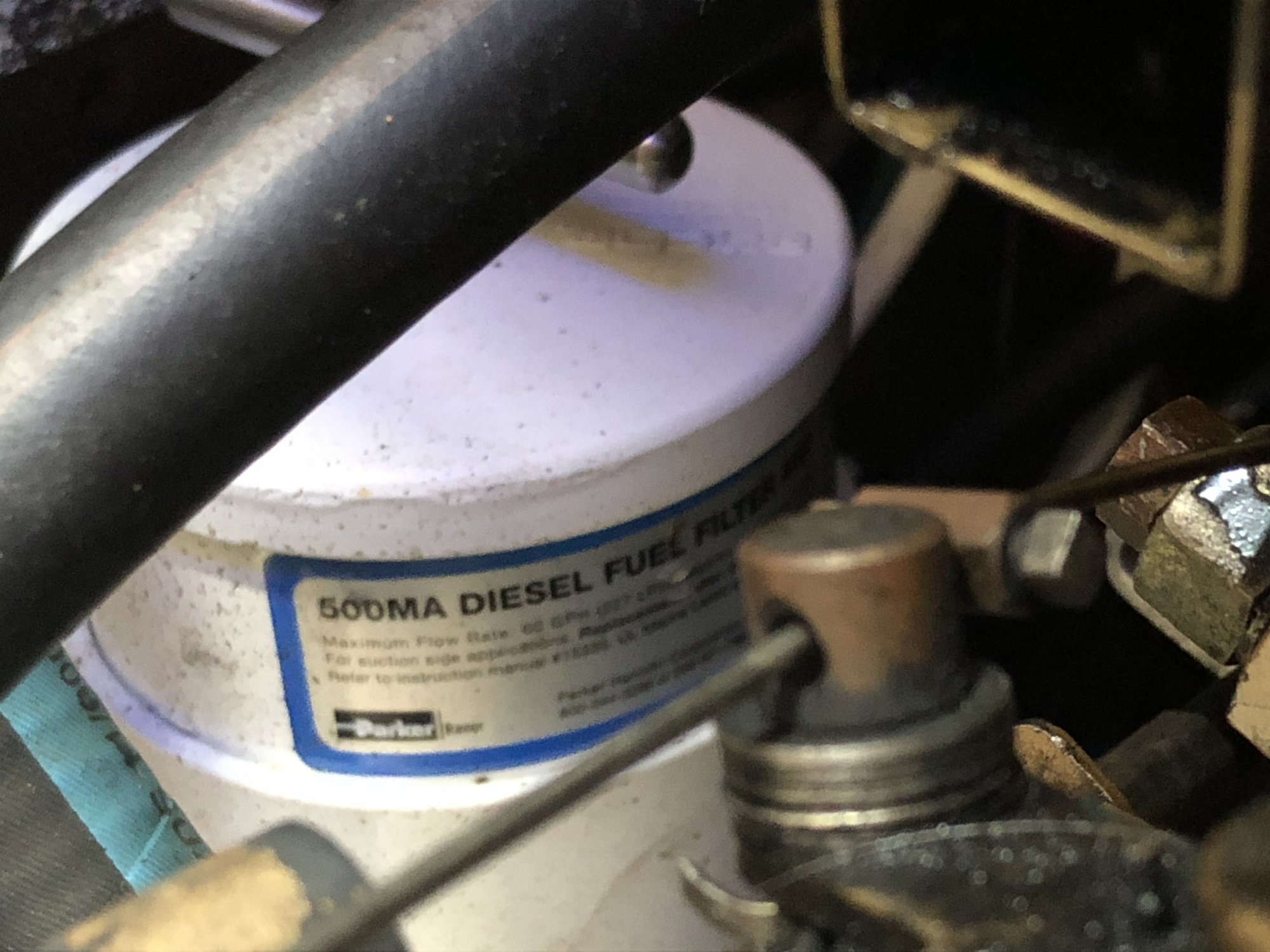

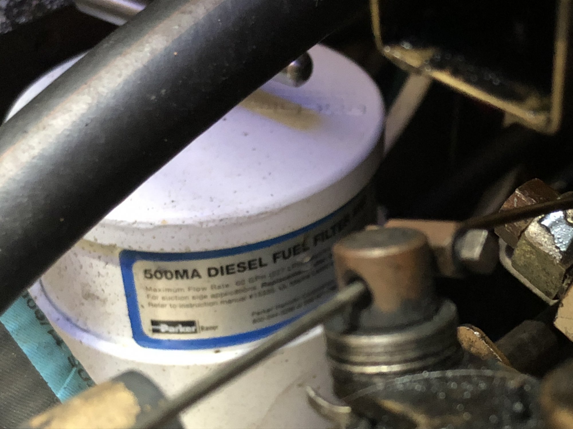

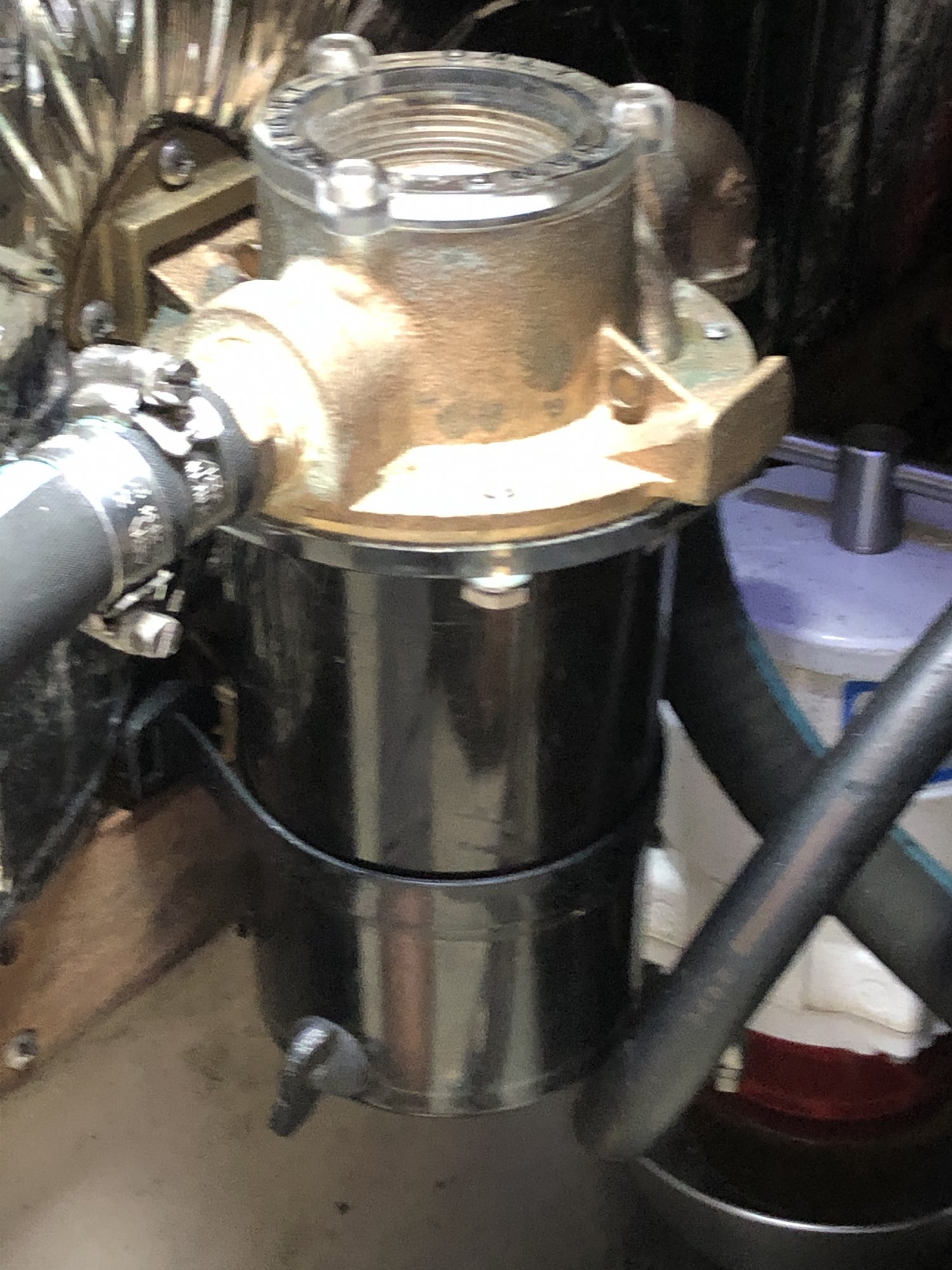

Thanks. Actually I may have had my tank polished and not scrubbed. Am not certain. She ran without dying yesterday for about an hour as I motored out, sailed and motored back. Seemed like full power was not quite what it used to be but was better than the last time I used her.
Checked for leaks and thatlooks okay. electric fuel pump ticks away as it should. My tank is very low now,thinking maybe I should siphon it out and discard the fuel At a recycling place and put fresh fuel in. As for the filter, we just cleaned and changed all filters where appropriate. I’ll post a photo of it, maybe you’ll know which model it is.
