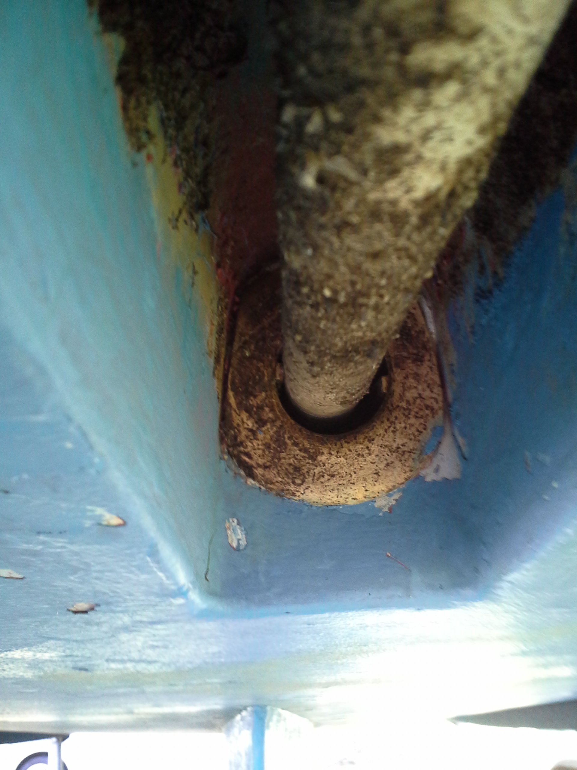

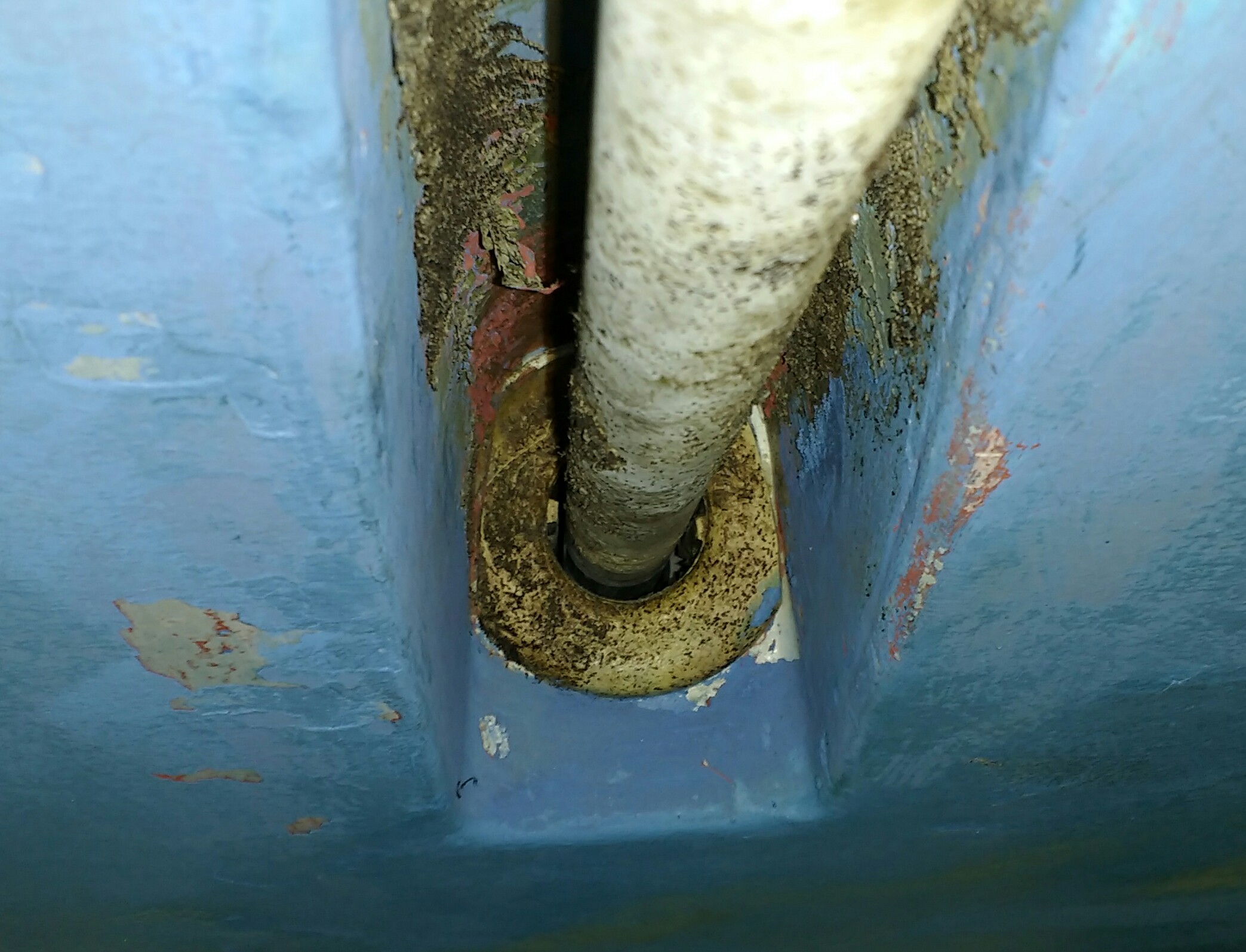

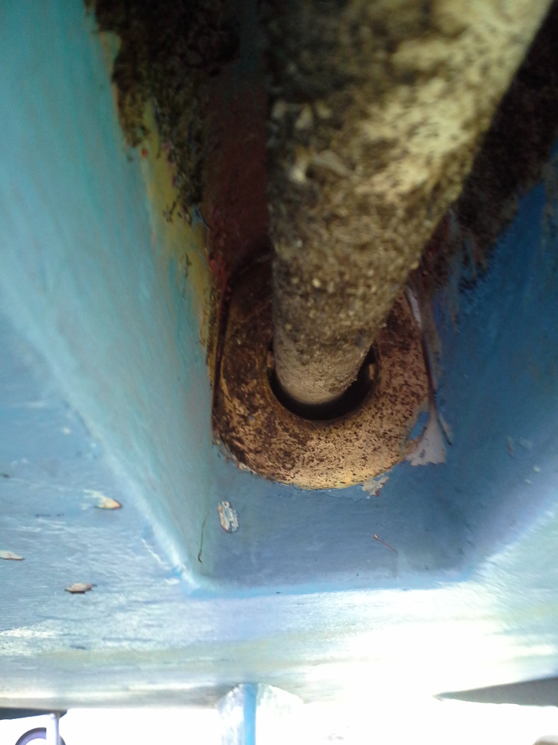

When I pulled the boat this fall, I noticed the shaft was not centered in the stern tube, and was very close to the port side of the stern tube (see 1st pic. below).
I replaced the PSS seal (something we didn't get a chance to do this summer), and realigned things on the trailer. With the shaft centered in the in the stern tube, I was again fine top to bottom, but had about a .023" gap on the starboard side of the coupling. So I decided to try for a compromise...a mostly centered shaft and close as I could get with the feeler gauges. Due to clearance issues, I can't get the front of the motor any more over to the starboard side, and moving the rear of the motor to port pushes the shaft further out of being centered in the stern tube. About the best I could get the gap down to was .014" on the starboard side of the coupling. See 2nd pic below to see the view of the back of the stern tube.

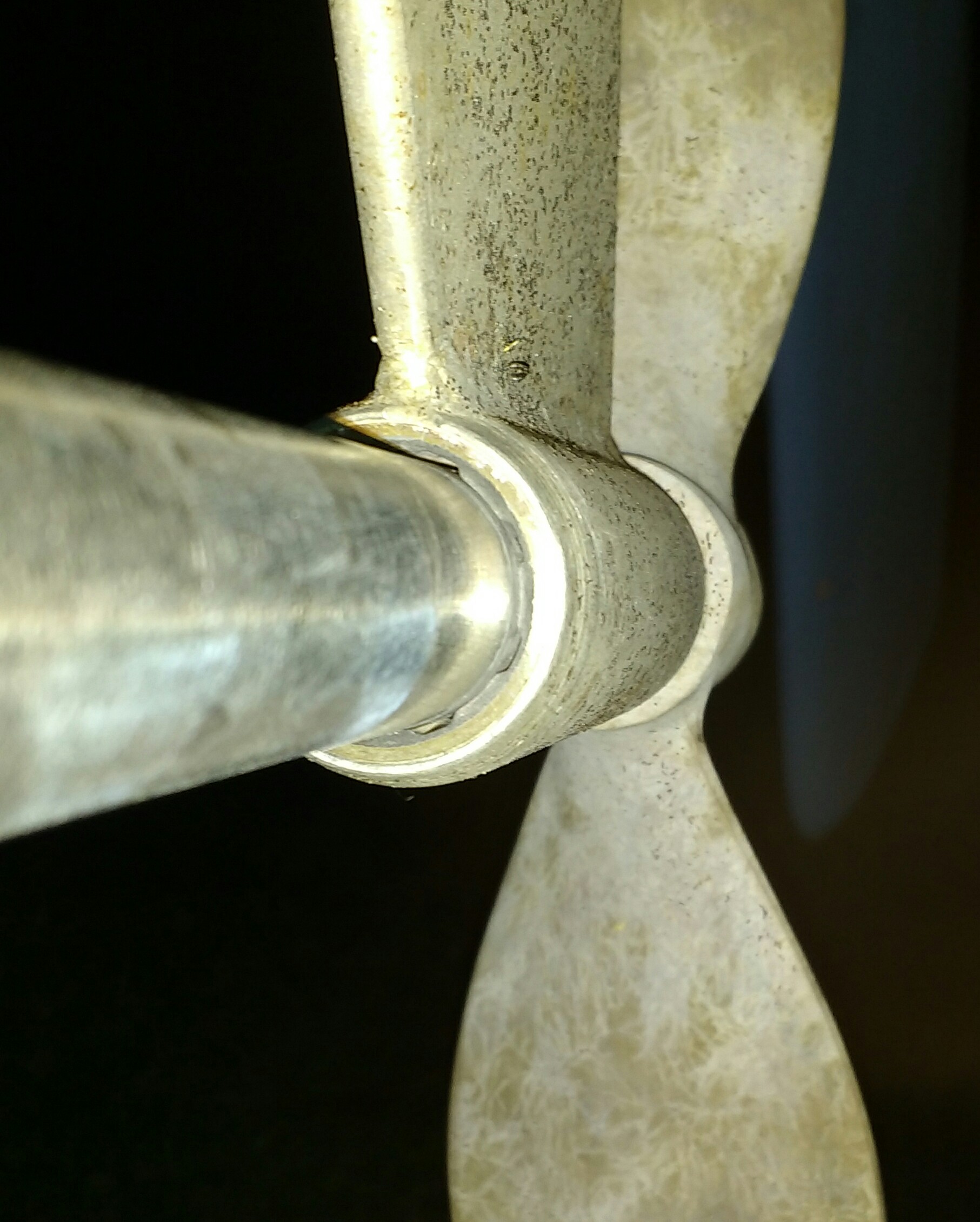

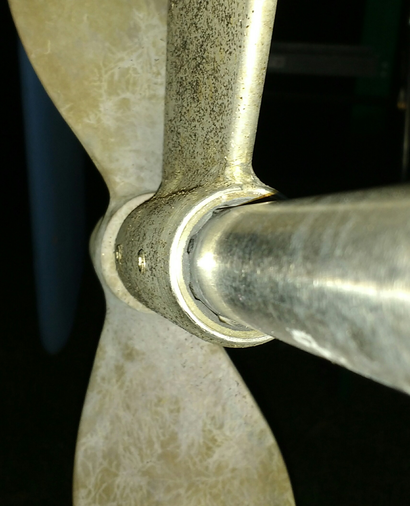

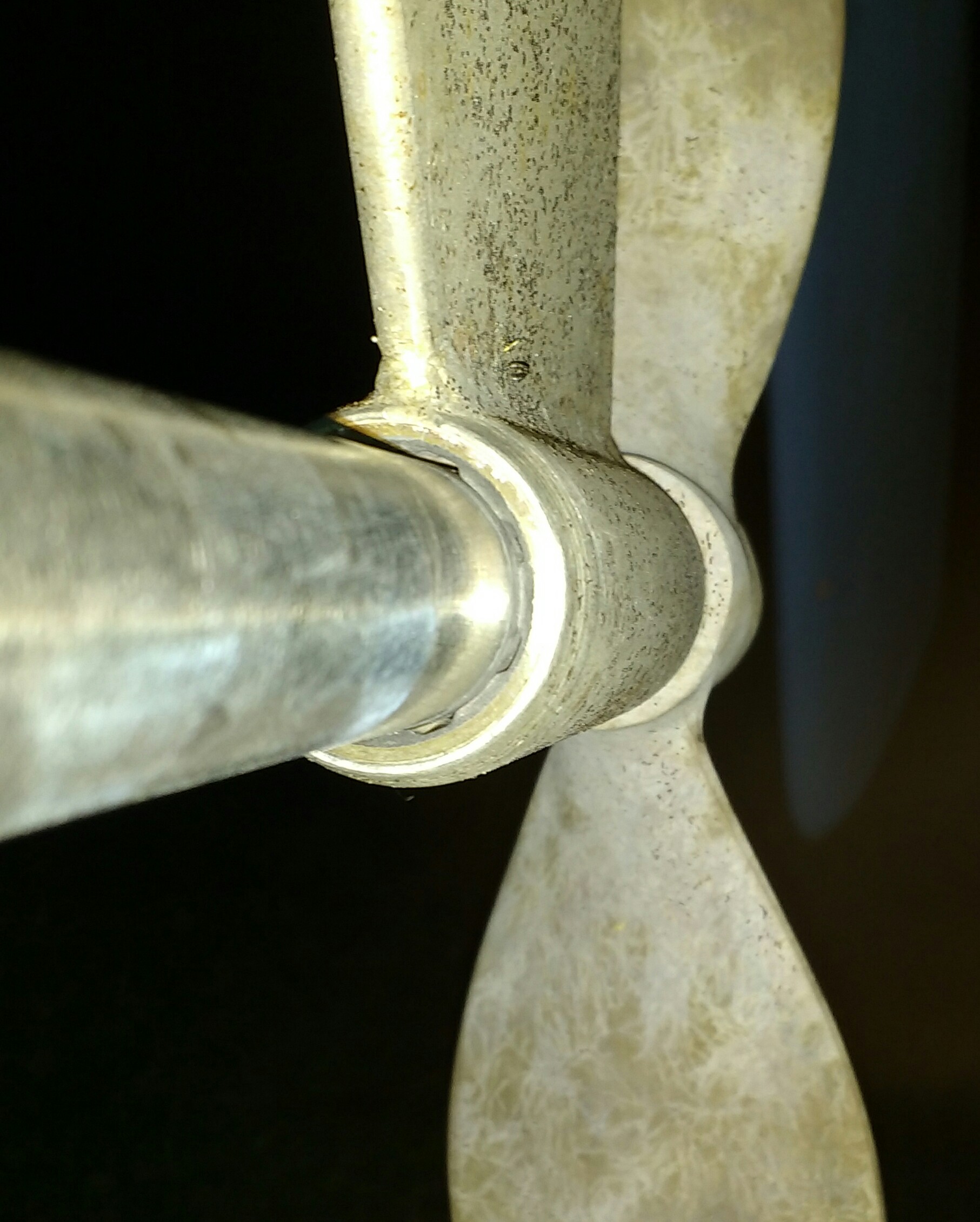

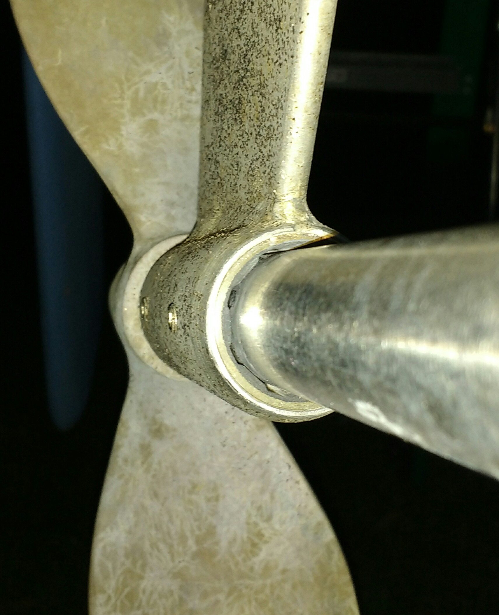

There is no indication of any problems with the strut. Eyeballing it with a square shows no signs of it being bent (or loose). I'm assuming, the boat was probably this way when it was manufactured?? The last 2 pics. are looking aft at the cutless bearing. The prop shaft seems to be pretty well centered there. If anything, centering the shaft in the stern tube would even make the fit better at the cutless bearing. Of course, this is opposite to what would improve the fit at the coupling with the feeler gauges.
So...I'm tempted to just call it close enough, but is there anything else I should try?

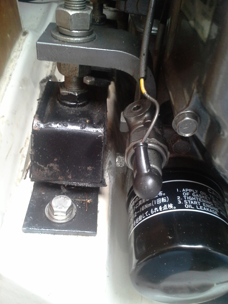

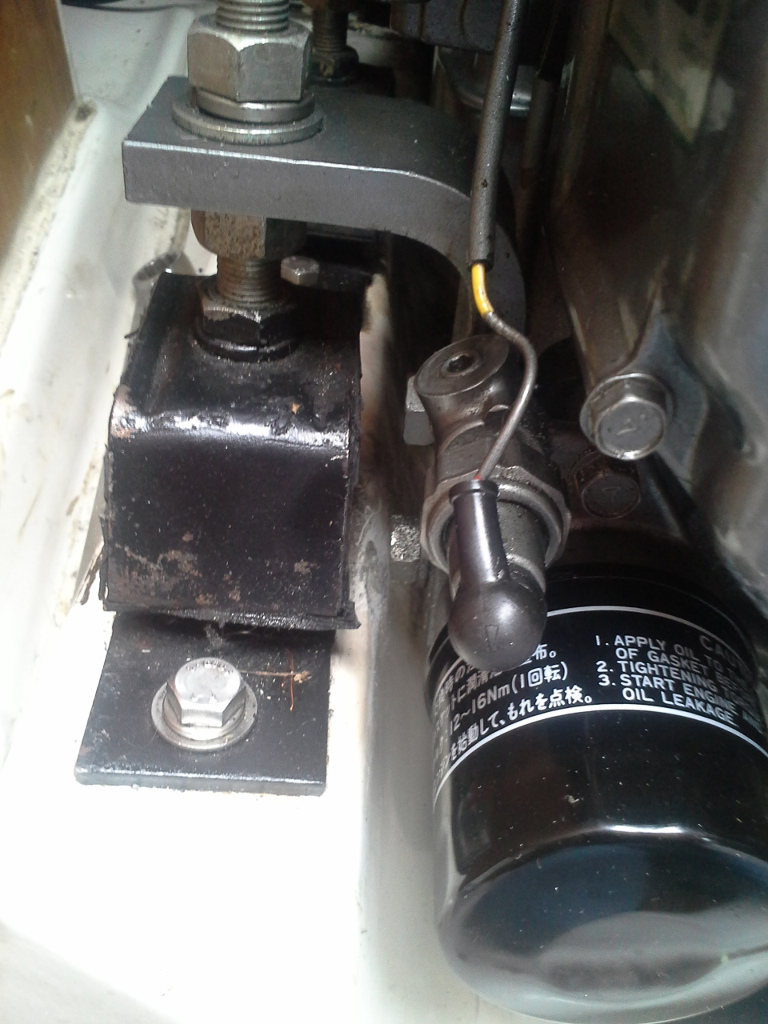

Thanks for the reply, Roy. Access is not a problem. Nothing is binding up, and even with the horizontal misalignment at it's worst (ie .023" gap at coupling), there was not really any noticeable vibration. There is no noticeable motor movement with rotation either. The attached pic. shows the interference problem that prevents much more front adjustment to starboard. Since I took that pic, I slotted the front most mount bolt holes a little to get as much adjustment as I could. I also ground the top corner of the fiberglass mounting pan (for lack of better words) for a little more clearance in the area where the bolt head might hit it (seen near the oil filter).

Good article you found there. If you find that you are able to achieve the parameters stated in that article I think you will be OK. The clearance at the oil filter is unfortunate but if it is not striking the stringer when the engine is running you can probably ignore it. If that is a Yanmar engine Mack Boring sells adaptors for remote mounting oil filters for some of those engines. See their online catalog.

Thanks. The oil filter clearance is fine. There is a bolt head that can be seen near the oil pressure switch, that is the only issue. I think that picture was taken with the motor centered. It was closer to contacting the stringer after I moved the front of the motor. You can see where I took a file to the corner of the stringer previously. I filed a little more out there when I had the front mounts off. No clearance issue at present, but just no more room to do much more with the front of the motor. I watched this before, when the boat was in the water with it in forward and reverse, to see if the motor rocked enough for it to be a problem. It didn't, so presently, I'm ok clearance wise.

023" is too far out and no amount of magic (shaft saver, hope, nor ignoring the situation) is going to fix this. The strut or the forward motor mount position needs to move such that the shaft centers in the tube. Perhaps a bit of both.
If this was my project I would start by centering the shaft first. Start by grinding off the outboard edge of the front mount - where the mount joins stringer and interferes with the vertical structure. Elongate the mount holes in both front mounts (two each) such that there is enough room to permit left/right movement of the motor.
Then work on shaft alighnment

The problem with being off-center going through the stern tube is the packing gland can "pre-load" the shaft and add to vibration issues. You can also develop shaft-bump where the shaft actually rubs or bumps the inside of the shaft log. With a PSS being perfectly centered is slightly less of an issue than with a very stiff rubber hose packing gland or solidly mounted bronze gland but still you want it to be centered as much as you can when motoring level or otherwise if motor sailing you may be creating even more problems..
