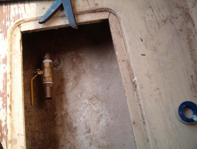

HIee,
We have a 22 footer that I have been refitting for a year now. I have installed a new Dometic 974 MSD in it. It is rigged for dockside pumpout as well as seaside pumpout with a macerator. The 974 has a small holding tank only 2.5 gallons. Personally I would not leave any thing in the holding tank after having been out on it. This was the reason for adding the macerator. If we can't pump out at the dock then at least when we bring it home I can always put a 5 gallon bucket under the thru hull (as close as possible lol ) and pump it out then run fresh water thru it to really clean it. In the summer the temp inside the cabin gets pretty high when she is closed up and I'd be very concerned about any liquid in the holding tank evaporating. At any rate without flushing it out I'd expect there to be a smell for sure after sitting for a week.
Brina
PS The other reason for the seaside pump out is that I am setting this boat up for extended coastal cruising as well as minimum passage making of 600nm in open water. With additional water in 1 gallon jugs we can increase that to a limit.
