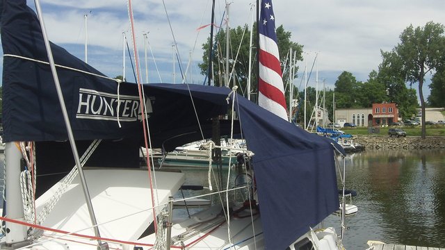

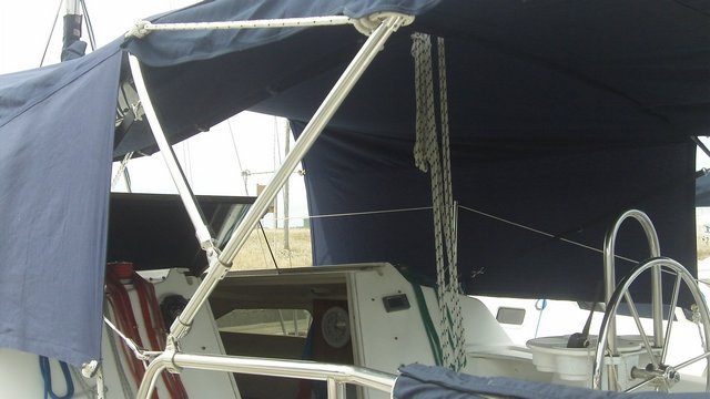

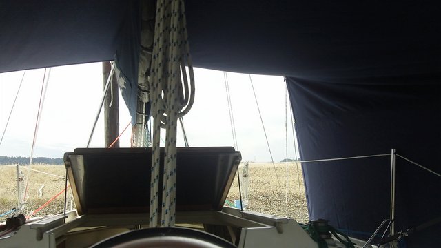

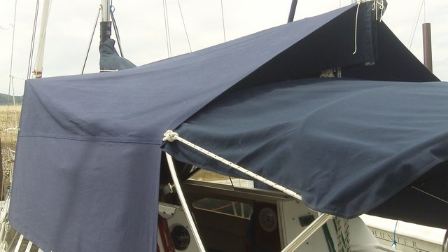

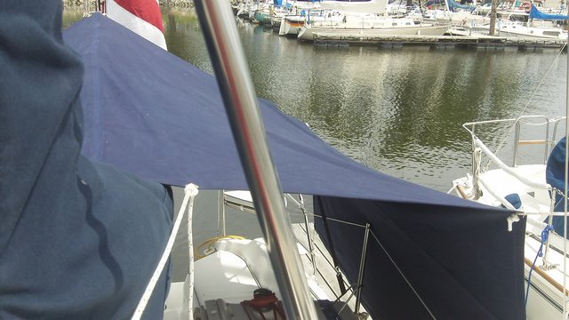

The small bimini that is possible on a H260 works OK when sailing, but doesn't offer enough shade when at anchor for swimming or lunch.
Here are photos of the new boom tent I sewed up for this hot summer.

Very nice. I want one. Here's a $10 attempt I had late last season before we pulled the boat for our broiling season. Some old tent rods keep it stabilized in a breeze but we lack shade when the sun gets lower.
I'd like to know how much material you used.
Thanks for posting the pix and stay cool, Mike

9 yards of 60" outdoor duck from the local fabric store. We had a 1/2 off coupon so it was about $50.00.
I already had the #4 grommets ( 1/2" inner diameter ) and thread, so that was the total cost.

Great idea Jim.
I fly that huge US Ensign off my stern. There is usually no wind on the hottest days. I just pull the flag around to where I need to block the sun.
