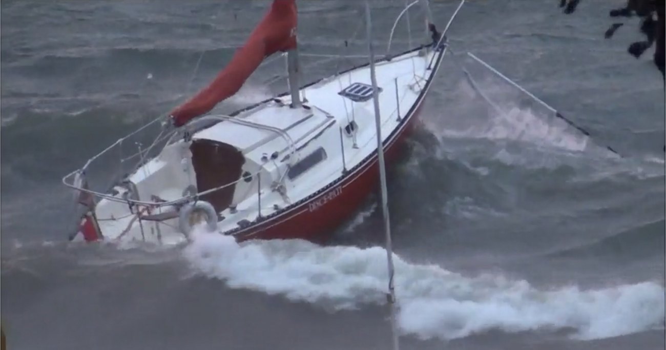

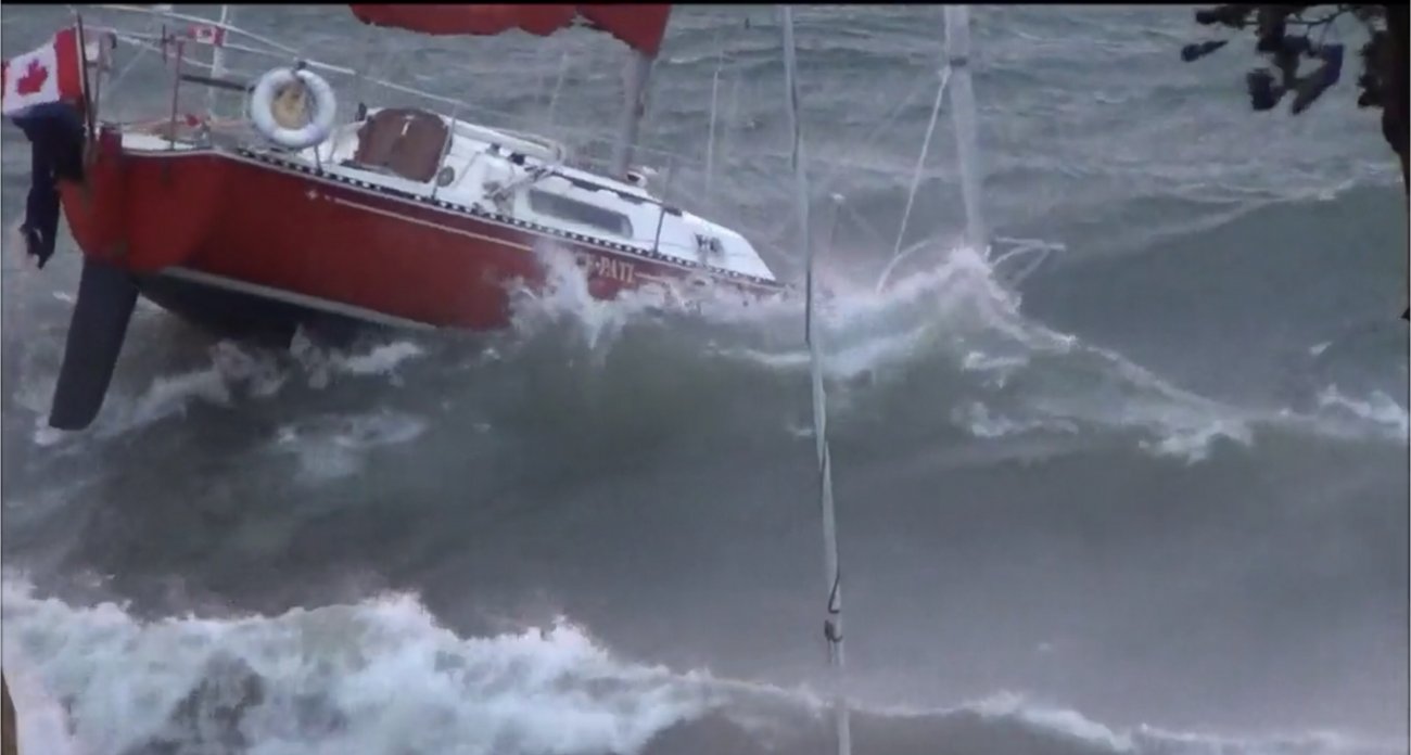

I thought I should justify my bias for oversize, overdesign to accommodate worst case. Most of the time our boat sits calmly at our mooring BUT this can happen too.

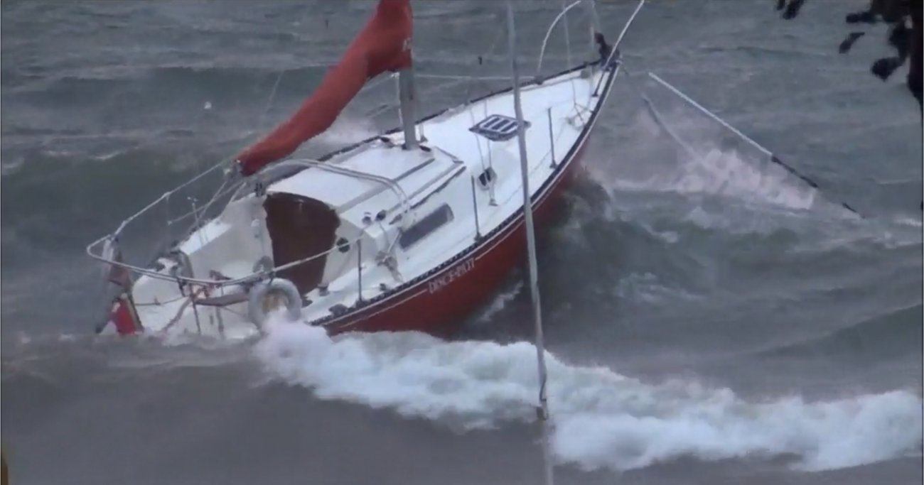

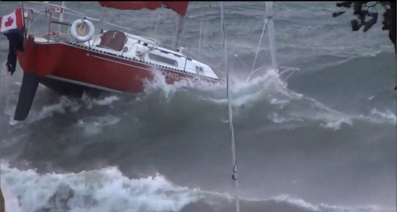

Yes. You can see the two painters in the first photo, primary has a black coloured snubber on it.
It was a very rare day from and wind direction and strength. Weather front moved in quickly and I had no time to get the boat somewhere else. Long hours watching it thrash and expected it to end up all over my yard but everything held. Gained a lot of confidence in the abilities of the boat after that.
