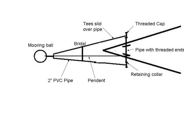

I may have thought of a way to solve the problem by putting together a rigid bridal, like what they use to pull a farm cart. The base of the bridal would be a threaded stainless steel pipe attached across each bow cleat creating the base of the triangle. The bridal would be made of 2" PVC attached to the bar by Tees that can slide over the threaded ends of the pipe and held in place with threaded caps against a colar. This would captate the bridal but allow for up and down rotation. I will have to work out the design carefully so it can be retrieved and re-attached easily. This will not replace the pendant but to suplement it, thus still retaining the tensil strength needed during high pulling loads.
See attached, I am currently windsurfing at OBX and don't have a suitable program to create a professional drawing with the proper detail so please excuse.

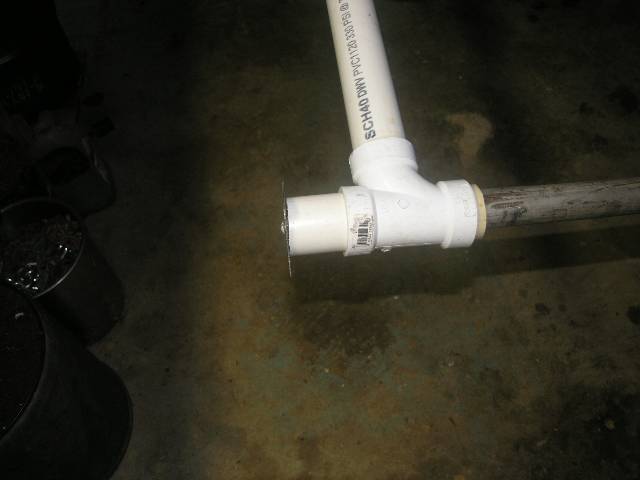

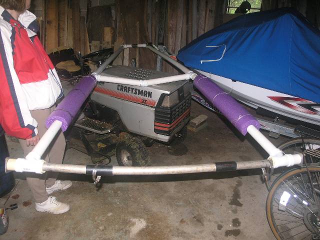

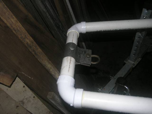

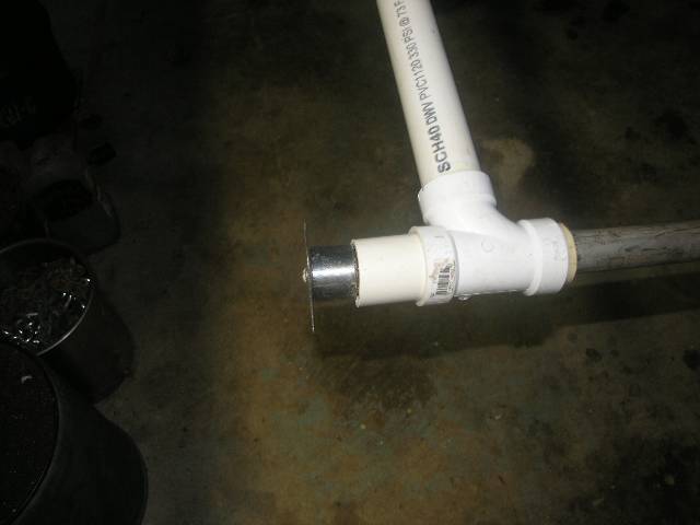

OK, here is Rev 1 of the Boat Rigid Harness. It is made of 1.5" PVC. The pivot rod is 1" Stainless with threaded caps with lanyards. These caps act as the pivot bearing when the boat moves up and down. The unit is loaded to push out on the caps keeping the harness in the bearings. This bar will be mounted across the top of the two bow cleats with hose clamps. It also has a re-enforcing inter pipe insearted bridging the mid cross tees to provide extra longitudinal strength. The Mooring ball will float on the inside of the tapered end attached by the shackle. Instead of the boat riding up on the ball it will now pull it until the lead runs out on the chain, then the boat will have to turn. I also don't believe there can be much lateral force on the harness, the boat will just turn. That's the theory anyway. The pendant will still be used for pulling force and will be snug enough to keep the rigid harness from pulling into the mooring ball. I will be installing the crazy rig this coming weekend.

pvc breaks..i am on a mooring with the round and round and up and down action--i use fire hose on m y lines and chain so as to protect my boat, many of my neighbors use whisker poles for keeping the ball off their boats....i use my bowsprit...works great.....i have watched the pvc take the current and wind ands break right in half--i i have kept boats on moorings for 10 years--with the only relief from ball vs boat hull being found in use of whisker pole and / or sprit and using fire hose to protect the lines from chain and growth of mussels and other lovely creatures of the sea that tend to grow and destroy the lines.gooo dluck to ya and i hope you find a good solution to your problem...
