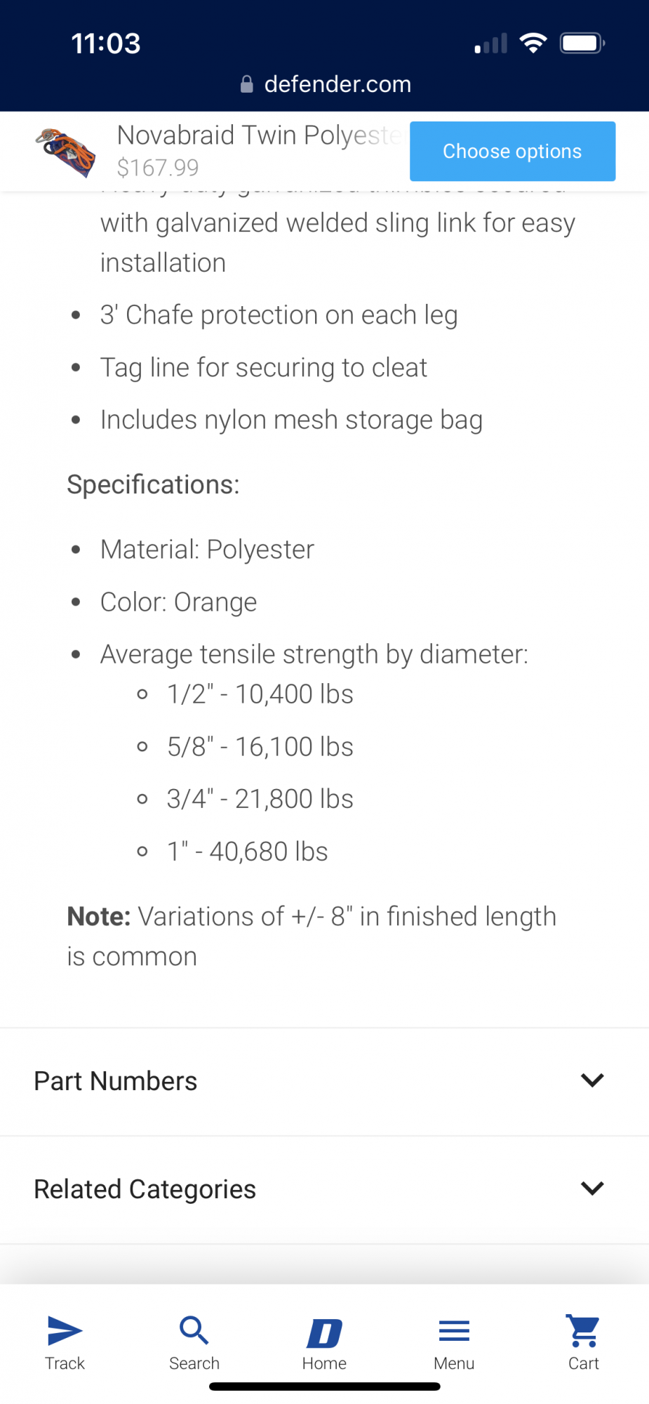

So will be replacing mooring line. In the past have made my own using triple braid 3/4 and followed maine sails guide. This year I am considering premade lines and will again follow Rods guide. My boat is a 43 ft about 23,000+/- lbs. what tensile strength is appropriate? Saw these from defender and thinking the 5/8 line would be fine. Opinions??

Hi Greg. Happy Easter. Rather prefer three strand nylon mooring line over polyester double/triple braid for the same reason when selecting ground tackle, it has flexibility. Please define a welded galvanized sling link; a shackle? If so, do they hot dip galvanize their product? Big distinction between galvanized and hot dipped galvanized in terms of long term corrosion resistance.
Never secure the mooring line working end from one cleat (port), through the mooring ring and securing the bitter end to an opposing cleat (starboard). Rather prefer two mooring lines, one as primary, the other as a backup with some slack in the event the primary fails.
When selecting ground tackle, the maker should spec their product by working load and breaking strength. Our boat displaces 35,000 pounds cruise ready, so I use 5/8" three strand nylon, which is more than adequate. Breaking strength normally doubles the working load.
Regarding the mooring, personal, private or public? How was it secured to the sea bed and what material was used to secure the anchor to the mooring float? Annually inspected/tested? Department of Natural Resource moorings around our precincts rate working load by boat length, with double boat length breaking strength. They inspect them annually, use helical coils to secure them to the sea bed and flat nylon webbing to connect the coil to the float using hot dipped galvanized shackles. This arrangement minimizes sea bed erosion. I've seen mooring conditions where I would not even tie up my dinghy. And others where our buddy boater drifted away due to a tether failure.
And a happy Easter to you as well!
I have always used 3-strand, however after reading Rods article on his mooring I thought I would switch.... again just trying to add a bit. Also, I have always had a double mooring pendant and not just the double spliced into a single line. Like the fact that two are attached and for me it keeps the boat pointing nicely into the wind. When severe storms are predicted I typically add an additional lazy bridle just in case. Our mooring is a personally supplied. 800 lb mushroom with 45 feet of chain in about 20 feet of water at high tide. Unfortunately it is pulled every year (harbor rules), however at least I do know the chain and all attachments are inspected annually and are good.
