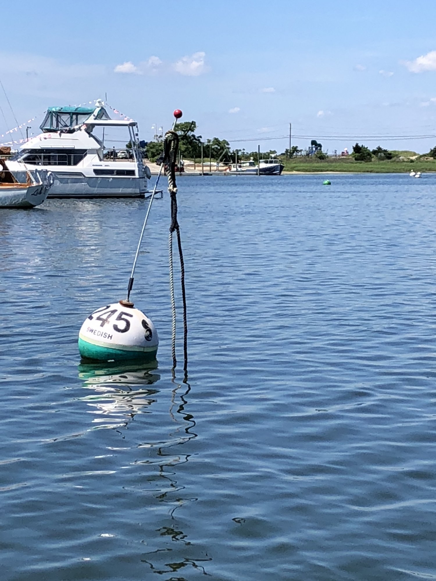

This is my current set-up. There is a steel threaded rod that goes through the ball. Mooring chain is shackled to an eye that is attached to the rod underneath. Then I have 3 foot peice of chain that is shackled to both the mooring chain and the eye on the rod on which my mooring lines are attached. I added the small chain so my lines do not run against the bottom of the ball.
Anyway if you zoom in you can see a smaller washer on top of two large washers. Those were the washers when I had my ball set up your way so that the shackle would not come in contact with the ball and prevents anything from going through.

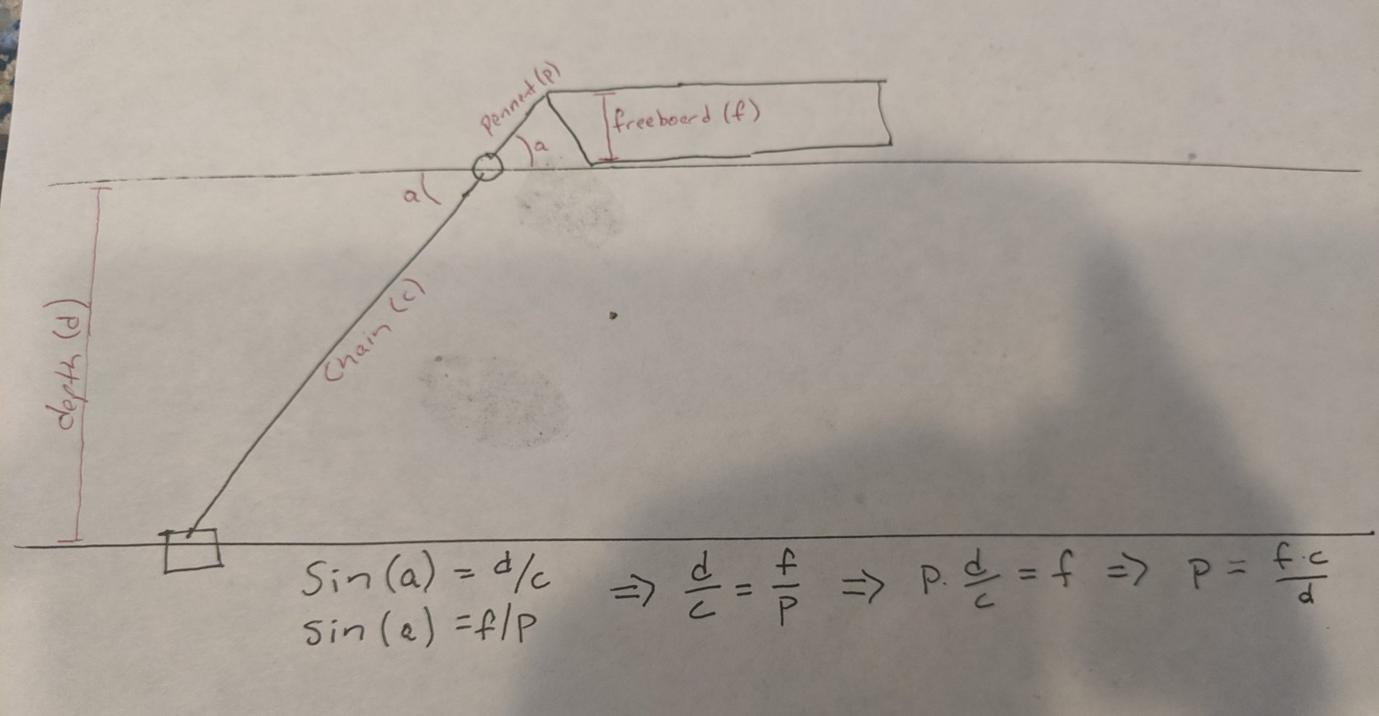

Thinking through the geometry of this arrangement, it seems like if the pennant is too long the ball will get dragged underwater in any sufficiently strong wind. A longer chain will allow for a longer pennant, but only to a limit. If my trigonometry is right (admittedly I have only moderate confidence in that), the pennant must be shorter than the freeboard divided by the arcsin of (depth divided by chain length). So if your freeboard is 4 feet, depth is 21, and chain is 45, your pennant shouldn't exceed 8.2 feet. Is it possible that your pennant is a bit longer, and your neighbors' a bit shorter, leading only you too have the problem?
Checking my trig it appears the formula might be simpler. Looks like the pennant can't exceed freeboard times chain length divided by depth. So that would mean your pennant should be under 8.6 feet (with freeboard of 4, chain of 45, depth of 21).
For anyone else that wants to see/check my math:
So, in the equation where c = xd where x is the muiltiplyer of depth required (ie scope c is 2 times depth or 2.5 times depth, which is the generally accepted scope)
substituting xd for c yields p (pendant length) = f (freeboard) times xd divided by d
the d's cancel and p (pendant length) = f (freeboard) times x (the multiplier of depth used for the scope)
SO the conclusion seems to bear out thae guidance that the pendant length should be 2 to 2 1/2 times the freeboard height (at the chocks) where the multiplier (2 or 2 1/2) is the same multiplier used to determine the scope of the chain.
