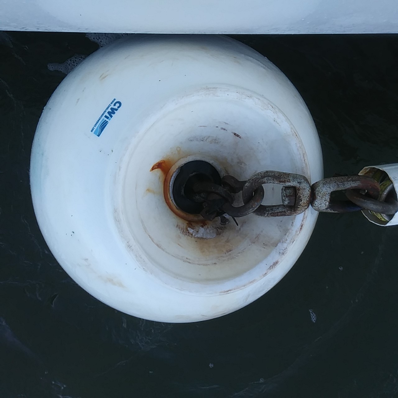

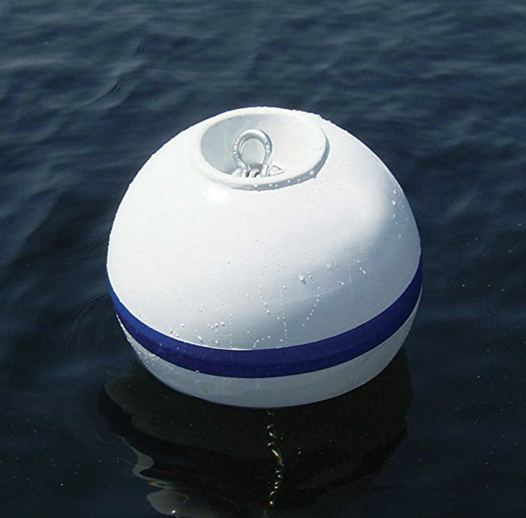

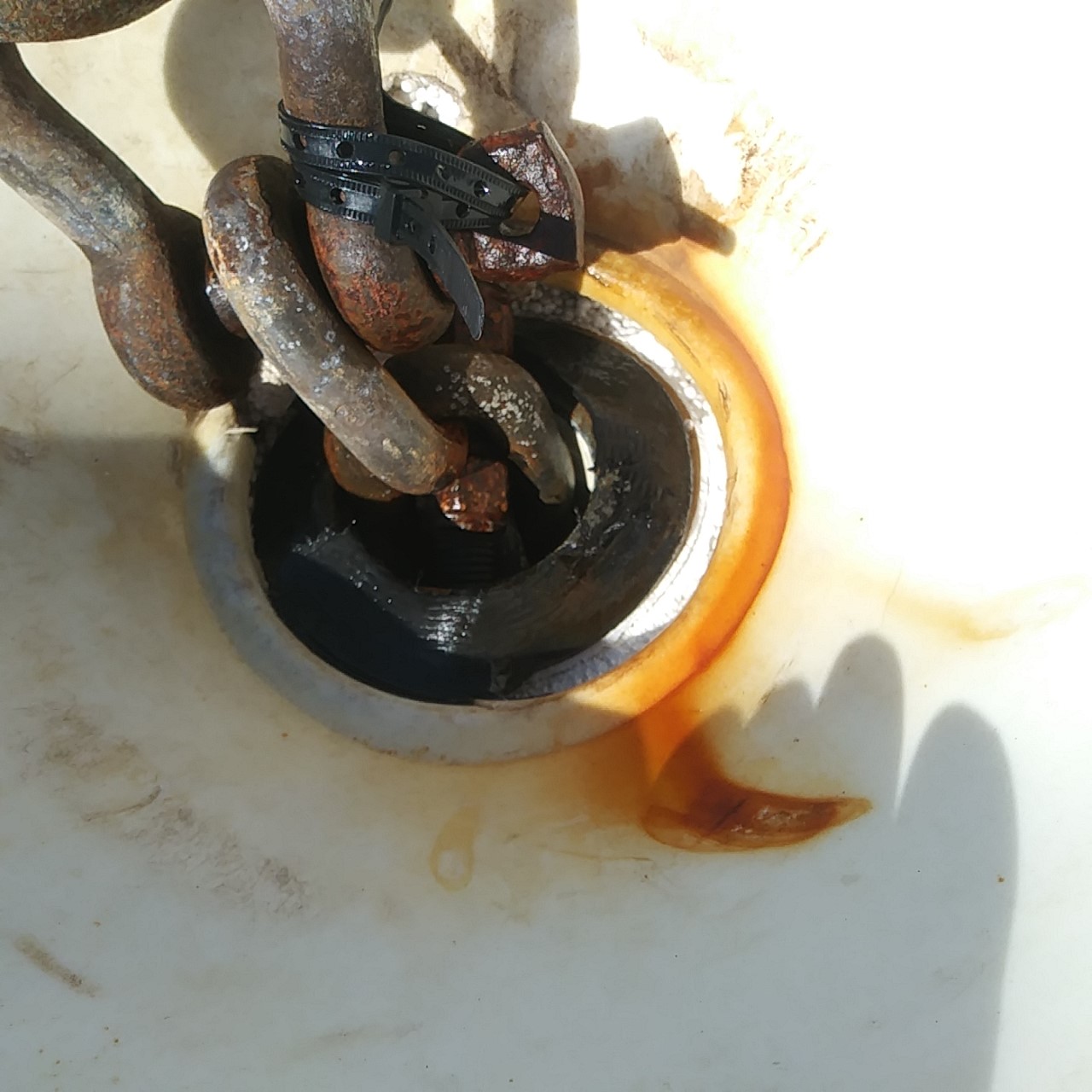

This particular style buoy (or something like it) has put boats on the rocks or beach if the penant is attached at the top of the ball. Traditional Sur- Moor Mooring Buoy - Taylor Made Products
The problem is that the rod inside corrodes and the corrosion is invisible until the rod lets go in a storm. :( I’ve seen it first hand.
FYI - Interesting image on that reference site - this confirms that the failure I had seen was due to improper use.

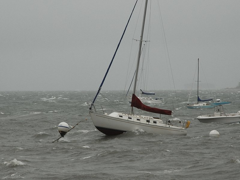

In a strong blow I don't think it would take 1:1 for a boat to submerge a mooring. I think it would be expected even at 2:1 if the boat is pulling hard enough.
With good scope and high wind/waves this is typically what will happen...
