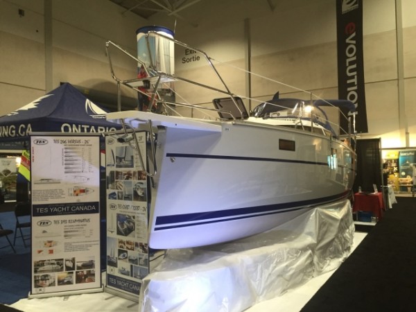

Well.. It does increase the waterline a tiny bit. Interior looks like the MacGregor interior. Hope it is fast without having to hang a ton of meat to windward.
Do they have to sleep like bats in there? hanging from roof with anti-gravity boots

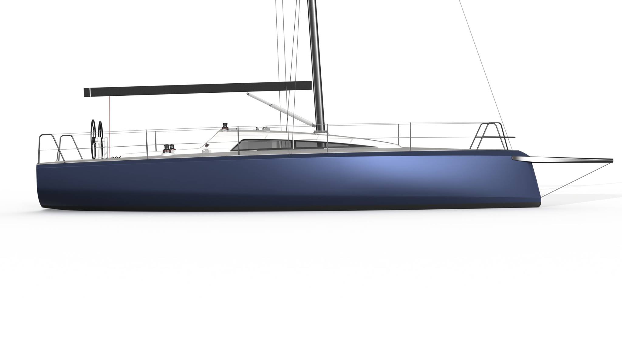

So, the apparent advantage to an inverted bow is... to reduce pounding? To give her less weather helm? To catch the bow wake and trim her level while climbing to a plane?
What is the thinking?
- Will (Dragonfly)
Nov 8, 2010
11,386
- Will (Dragonfly)
It’s 98% cosmetic. For all intents and purposes the same as a vertical bow.
Oct 19, 2017
7,970
just as I suspected, like putting horns on your Viking helmet.
- Will (Dragonfly)
Oct 19, 2017
7,970
Big ships put bulbs below their waterline that stuck out ahead of the bow. The idea was to push a column of water ahead of them to increase waterline length and improve their hull speed. The trade off was that their effective displacement included the extra weight of the water their power plant had to push as well.
