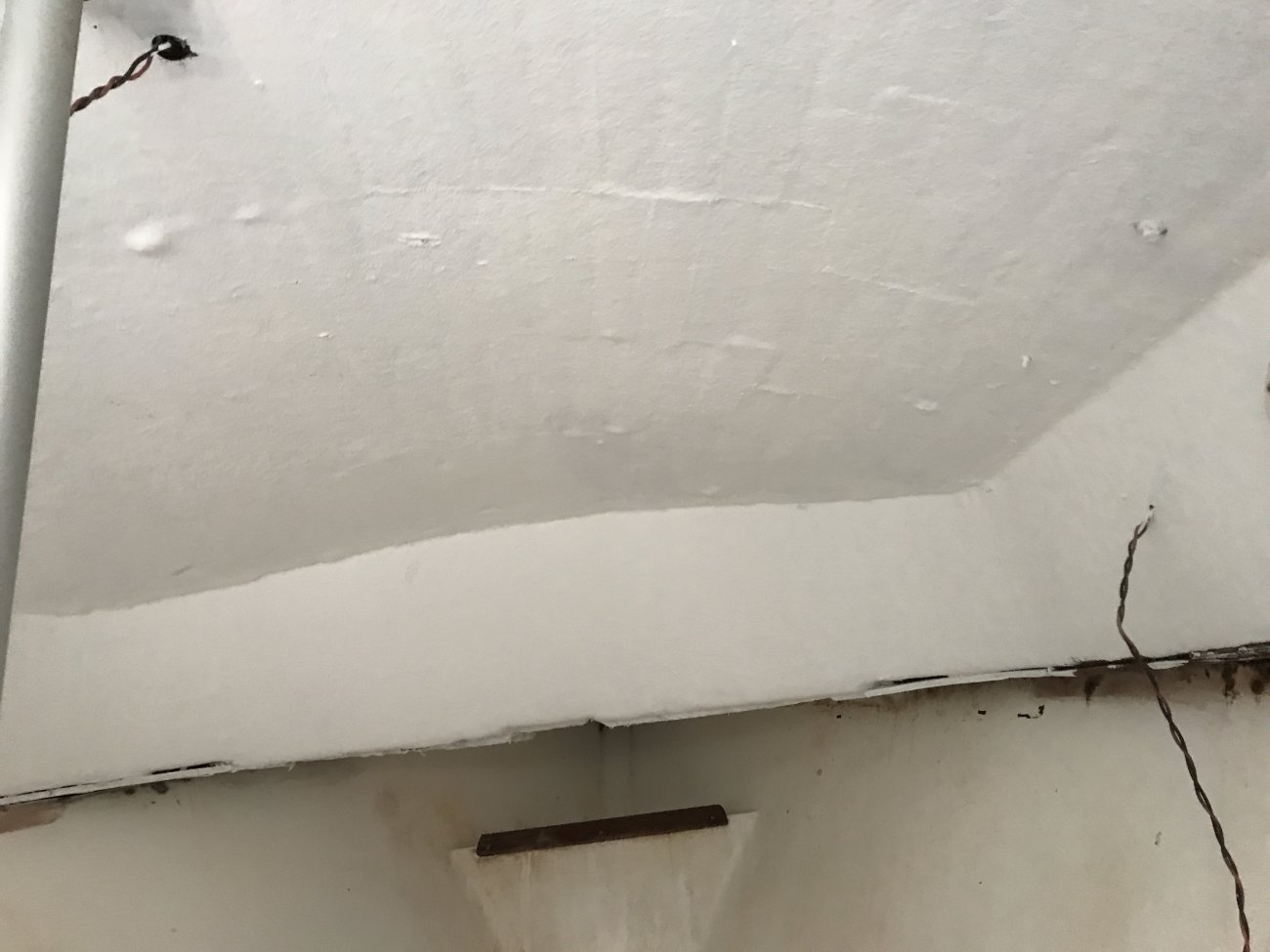

The ply wood is rotten, do I remove just what I can? Then kill mold as much as I can then glue carpet to ceiling
A little exploratory surgery might yield clearer answers.
Given the high humidity in LA, I'd think about something different for the headliner. Perhaps just clean it up and paint it. Put some nice cedar or cyprus trim on to dress it up. The carpet will be hard to clean and will not dry out all that well.

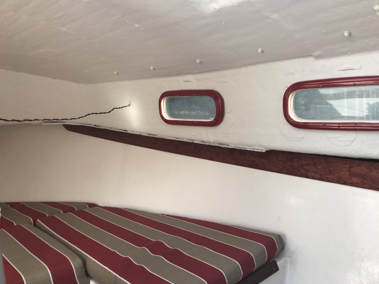

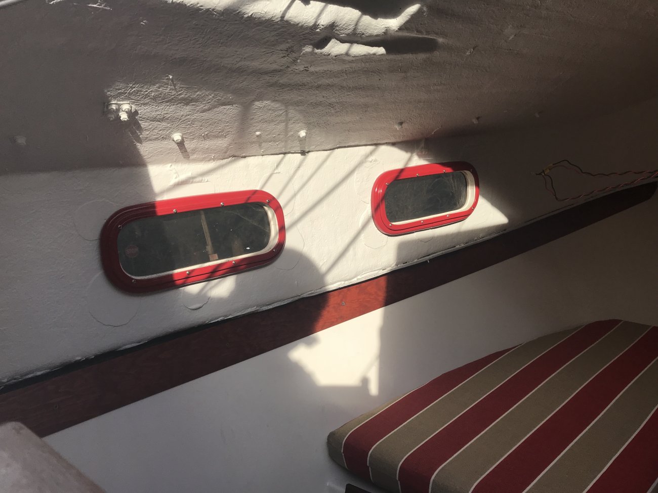

Looking at the photos again, the plywood around the ports is structural. It helps to stiffen the deck around the port. That will need to be replaced. Something less rot prone would be best. Perhaps some G-10 or Starboard.
Check Mcmaster Carr, Grainger or Fastenal for good prices on either.

Looking at the photos again, the plywood around the ports is structural. It helps to stiffen the deck around the port. That will need to be replaced. Something less rot prone would be best. Perhaps some G-10 or Starboard....
Not starboard. You can't structurally bond it to anything (there are minor exceptions, not relevant here), and boding adds a LOT of strength.
Jan 11, 2014
11,436
Sabre 362 113 Fair Haven, NY
@thinwater is correct that Starboard or its relatives can not be easily bonded to anything. So if the plywood by the ports is there to strength the sidewalls of the doghouse, starboard would not be a good choice.
My thinking, not clearly expressed, was about strengthening the space immediately around the port opening. It is likely that the fiberglass sides of the doghouse are thinner than the space between the inside and outside flange of the port. In this case it would act more as a backing plate if it was captured by the mounting bolts. The compression from the mounting bolts would allow the starboard would reduce any flexing of the fiberglass around around the port opening. If this was an offshore boat, then there would be better solutions like adding a sheet of G10 and recutting the port holes.
Making the area around the port cut outs stiffer will reduce flexing and reduce the possibility of leaks, helping to keep the boat drier and less mold and mildew prone.
