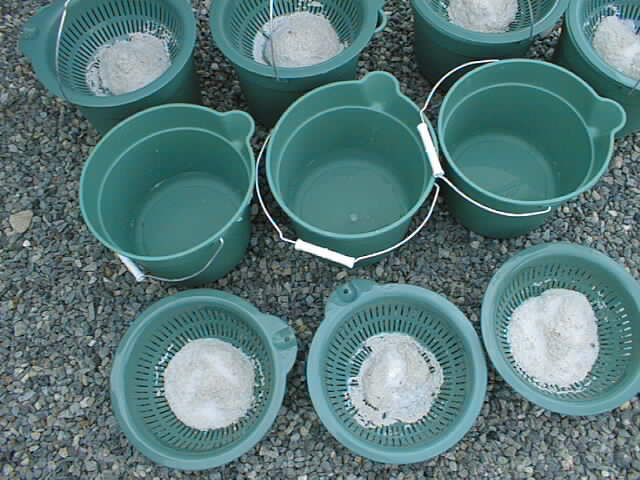

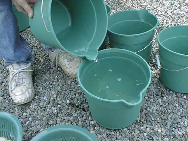

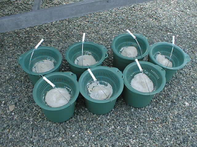

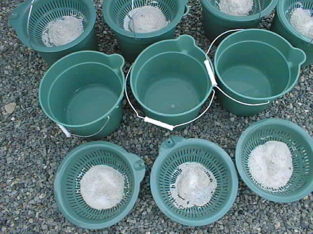

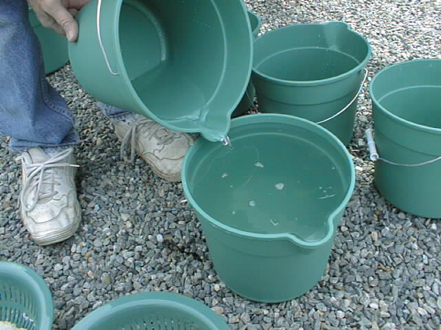

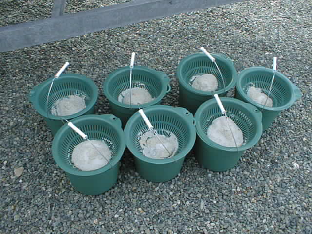

For the interior, I do several things. First, I do not remove any cushions but I bag any towels and bedding that I am leaving. After my boat is hauled, I use a shop vac to suck all of the residual water out of the bilge. This removes a big moisture source. Then I place seven buckets with colanders in the top of them around the cabin areas. I put about 2 cups of pure calcium chloride pellets into the colanders. The calcium chloride absorbs any moisture in the air and it condenses and drips into the buckets. This calcium chloride is the "pure" variety, not the formula that is mixed with rock salt. You can buy a 40# bag at Home Depot or any gardening supply. It is also used as an ice melt for walks. Be sure that you are getting the stuff that is 100% calcium chloride and not a mix. I bought the buckets and colanders at the dollar store for $14. The 40# calcium chloride is about $30 and will last you 10 years if you put it in an air-tight container.
In the Spring I empty all of the buckets and rinse everything for next year. I collect about one full bucket of water with this system.
I can't claim that I get no mildew or mold at all, but it is very minimal. A quick wipe with a mildew cleaner in the Spring is all that is required. The cushions have been just fine for 18 years. I also flip all the cushions up so that air can circulate around them. And I open all the cabinets and drawers too.

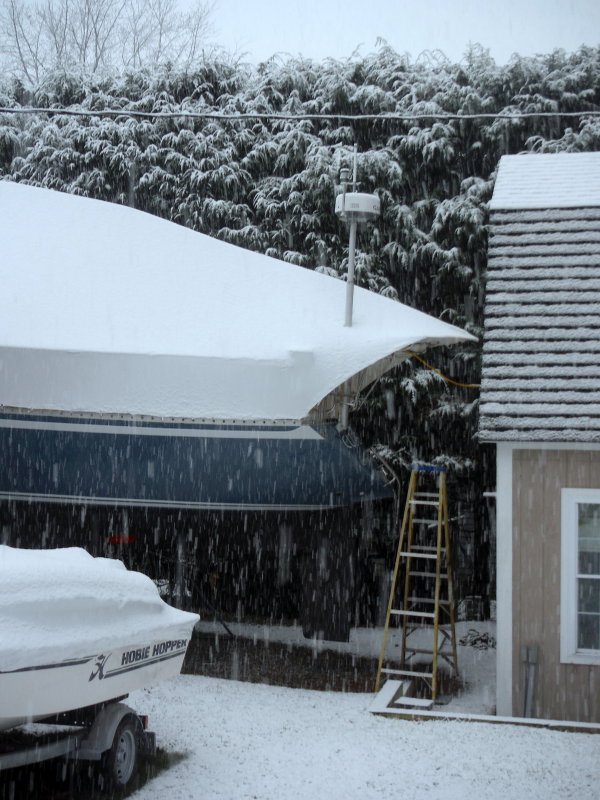

While we use shrink wrap the cover and frame are of my own design. (no cover will ever touch the paint!) The cover stops at the toe rail and the rail itself provides plenty of ventilation and breath-ability. The aft end forms a vestibule which extends beyond the davits, covers my ladder and keeps the cockpit snow free. It remains full open all winter.. This cover self sheds all snow and and provides tremendous air circulation. I am allergic to mold and this is where I have ended up over many years. My brother is now also doing a vestibule cover on his boat......

Maine sail, I love the idea of the vestibule! You should patent it. How do you prevent birds from nesting under it? Great air circulation with it!
Great cover, Maine Sail. I like your Hobie, too! It looks a lot like my Hobie Power Skiff.
