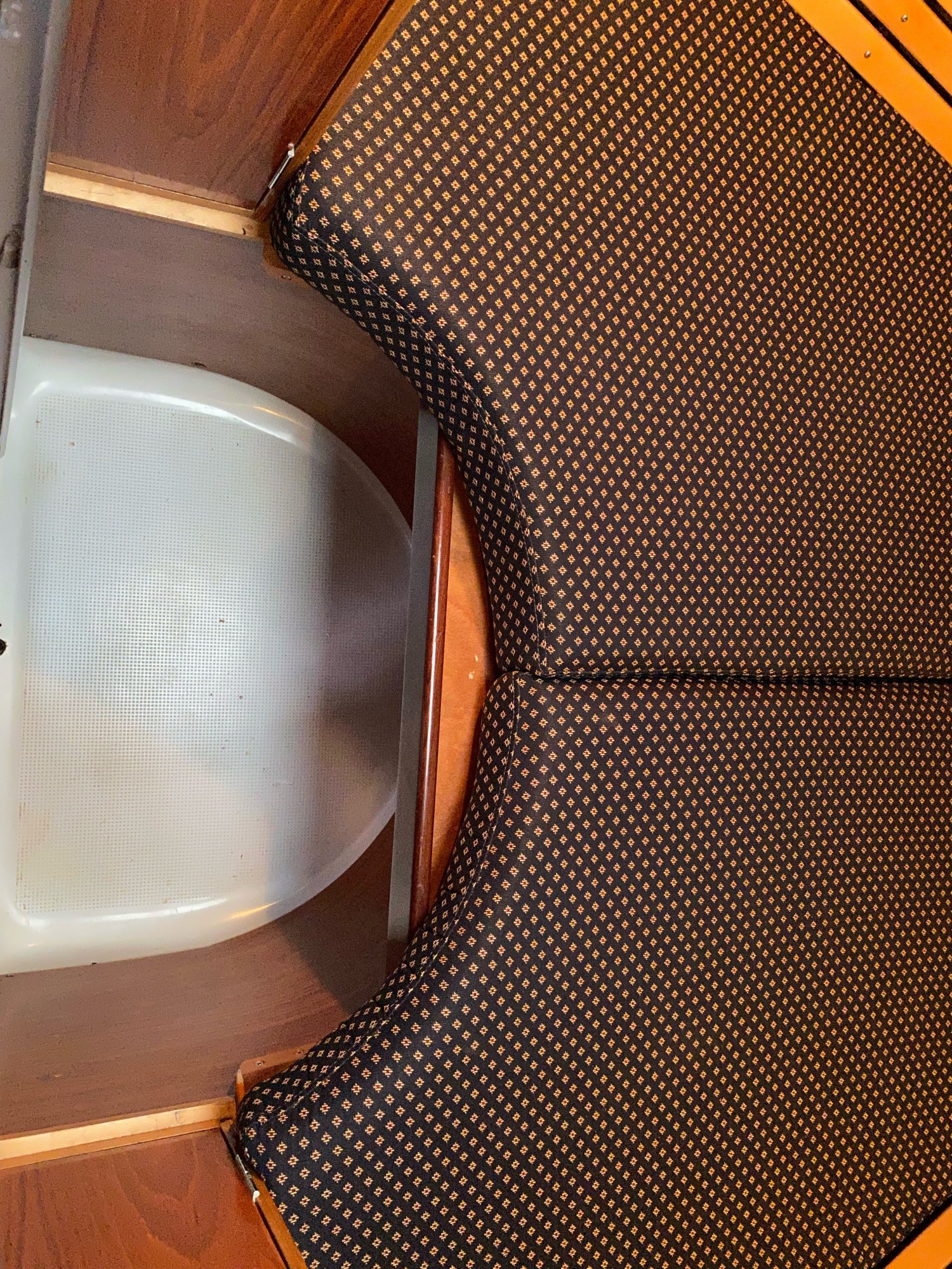

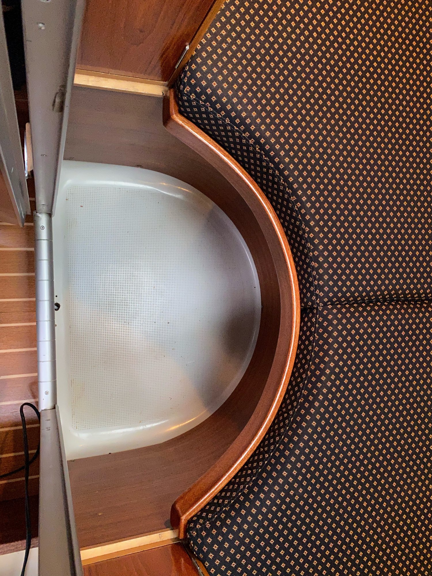

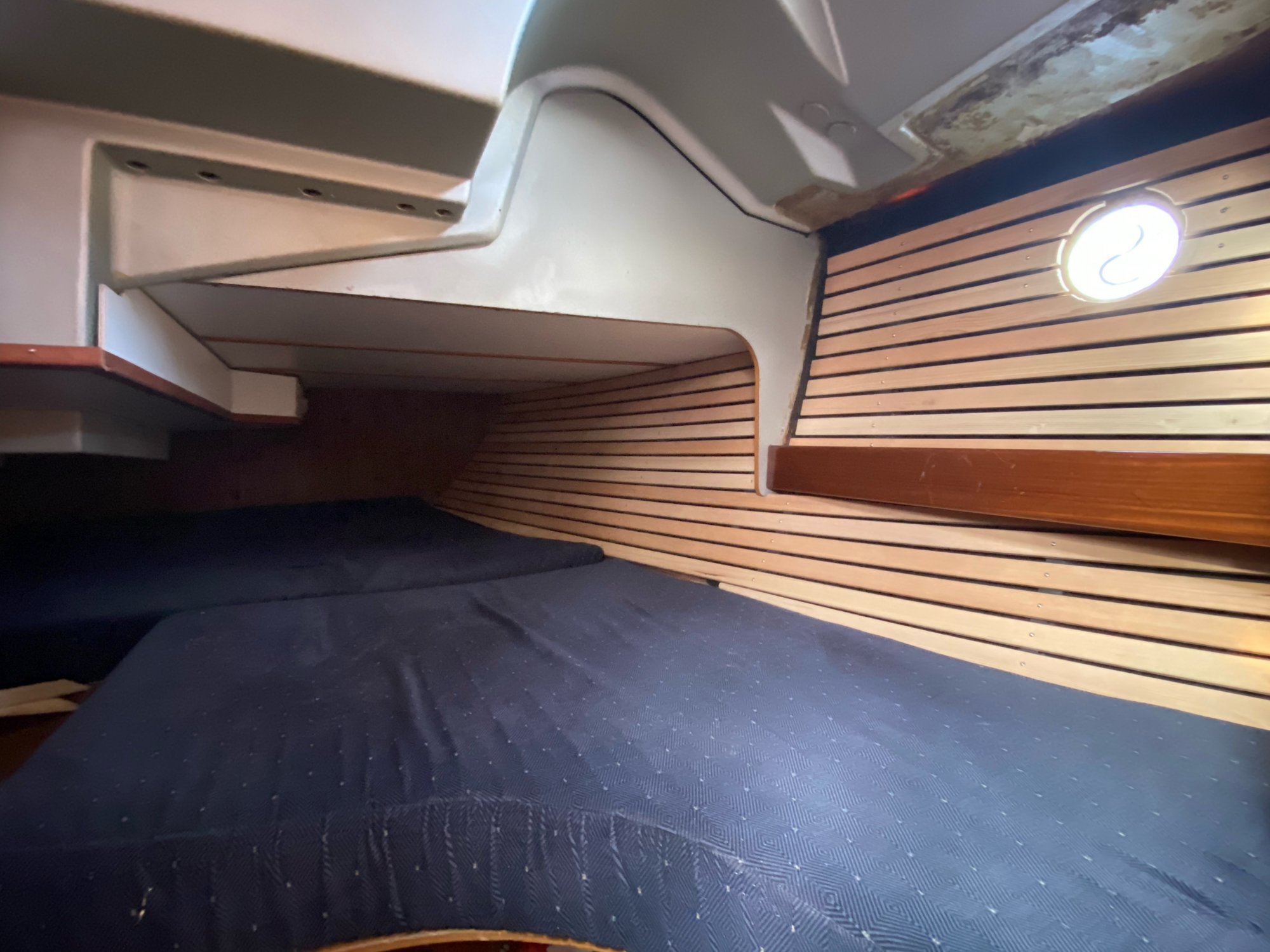

One last niggling detail on the V berth... somehow the cushions were not made to match the underlying berth top, primarily the filler piece that was added at some point. The cushion was actually sitting on top of the fiddle...

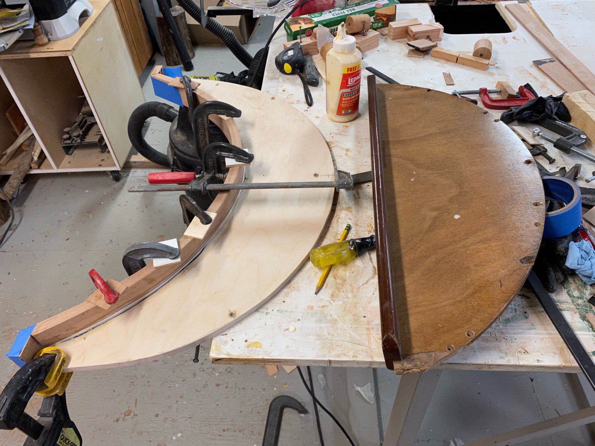

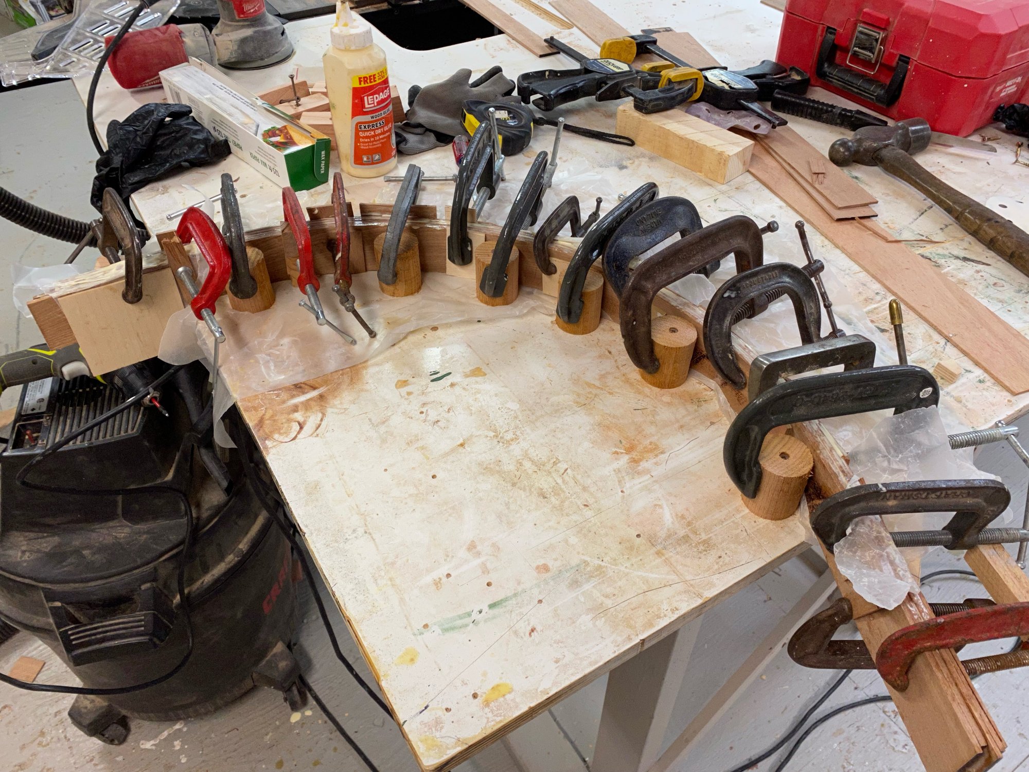

Made up a bending jig in the shop, milled some Sapelle into 1/8" strips, and laminated them together into the required curve. (one can never have too many clamps!)
Then glued it onto the correct-shaped filler piece (old one on the right)

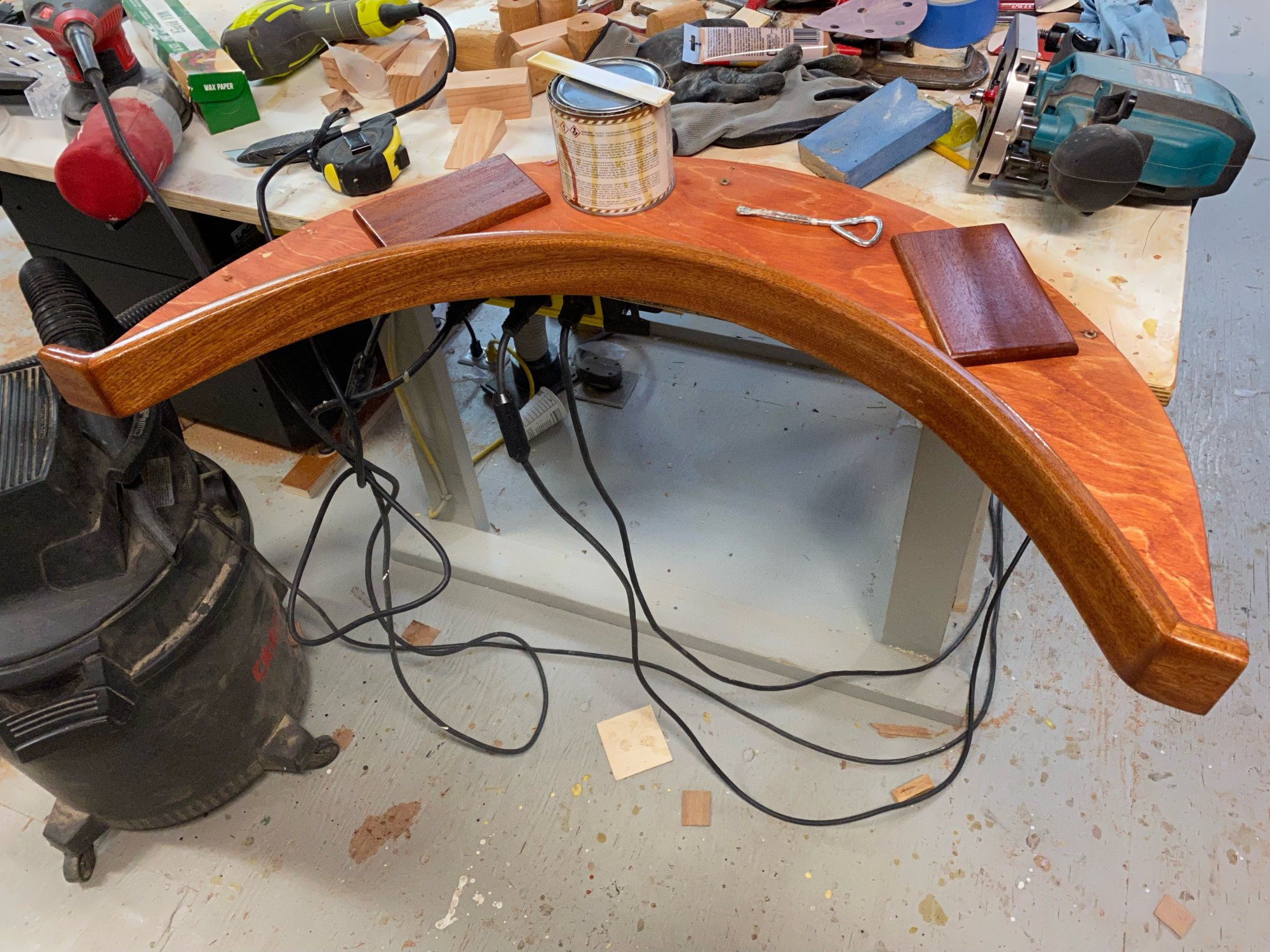

Once again a bit of Cherry stain and some varnish, and the result....
