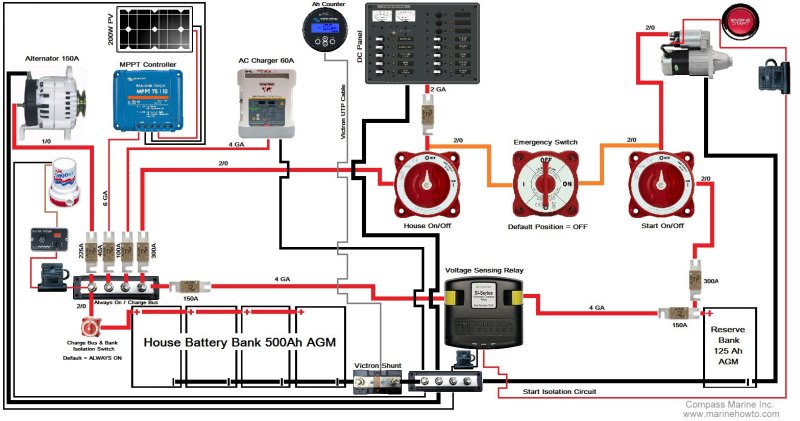

When I "modify" DCP switch wiring on customers boat, who want the ability to isolate a bad bank while using the good one to power everything, the ON/OFF switches are out of plain sight, usually in the battery compartment. All the guests and owner see is the DCP ON/OFF switch. The DCP label already has a yellow WARNING placard with an ! for "combine batteries".
The general wiring would usually look like this. The emergency ON/OFF's are usually within about 7-10" of each bank after the fuse...

Nice
But what about
> If you want any level of performance charging them you run all charge sources direct to the house banks always-on bus or the physical battery terminal
Plus risk of no load dump alt boom if switches isolate while running?
Feb 6, 1998
11,723
Nice
But what about
> If you want any level of performance charging them you run all charge sources direct to the house banks always-on bus or the physical battery terminal.
The bus on the load side of the house switch is the always on / charge bus in that drawing.. The switch is there only for an emergency or service tech use. It should ALWAYS remain ON unless you have an emergency or a service tech needs full 12V isolation to the engine.
Under normal use only the DCP is used. ON>OFF very, very simple...
Often I will use a Blue Sea "keyed" switch with the key on lanyard. No one should ever touch these switches because they are not visible to occupants or crew.
That's quite a what if....
What if a meteorite hit the boat and killed the alt??:wink:
What if Harry Potter flew down on his magic high voltage broom and caused a voltage transient that killed the alt??:biggrin:
I've been doing this a long, long, long, long time and in all that time never once seen a battery switch magically operate itself.
If you wire this system the way it should be, concealed emergency isolation switches, installed very, very close to the bank, right after the main bank fuse, there is zero risk of a load dump other than by you the owner.
A very nice feature of this particular wiring layout is the fact that when or if the house bank goes South, you simply turn the DCP to "BOTH" and then turn off the house bank switch. You now have full isolation AND *the start/reserve bank now receives all charge sources with only two switch flips BOTH and HOUSE ISOLATION OFF. You're now back in business in a few seconds..
*Important that positive volt sensing for the regulator is also on load side of house emergency switch. This is why it is installed close to the bank for minimum voltage drop..
The key to this installation is the concealed/out of sight emergency isolation/service tech switches mounted as close to the batteries as possible (right after the fuse)...
