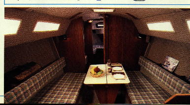

How about some pictures about how it is laid out now...

Ahhhh...the joys of those lovely plaid cushions. I loved 'em on our Catalina 25, although ours had the blue/brown finish - couldn't and still can't abide the brown only!!! :):):)
