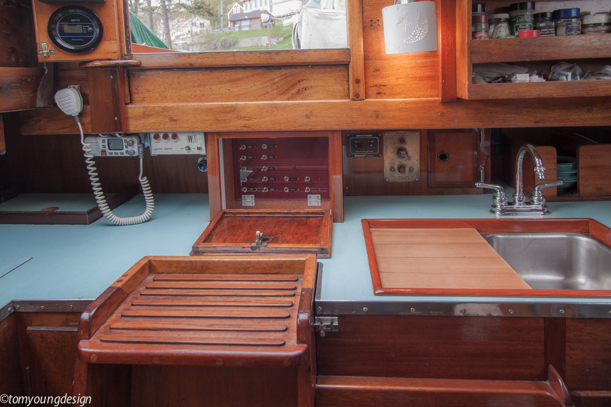

Soon after buying this boat I decided it needed better access to the engine, primarily to service the starter and install a 6 gallon water heater. Short of removing the galley counter - a big job - it was nearly impossible to reach the starter.

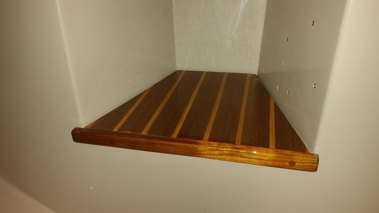

I measured up an area of countertop where the galley sink was mounted, that could be cut out and still be structurally sound.
This cut out had to be big enough to fit the water heater through.
The cut out made, I designed a 'sink board' that would improve the galley sink. Simply, the old sink was cut into the new 3/4" marine ply filler piece.
Next I traced around the sinks rim, removed the sink from the plywood, and cut a gain (with a router) into the plywood so the rim of the sink would fit flush to the top surface of the 3/4" plywood.
Next a piece of L shaped trim (Fir) was milled and mounted around the perimeter of the sink board. This inverted L shaped trim forms the ledge that the sink board hangs in the cut out in the countertop.
Then inside the trim, I fit re-sawed some Fir T&G flooring (about 1/2" thick) and fastened from the underside of the sink board.
Trim and flooring were bedded in something (I can't recall what it was).
I thought of this as a mock up to try out for a few years, not thinking it would last. Surely something other than wood, would hold up better in this wet application. Corian perhaps?

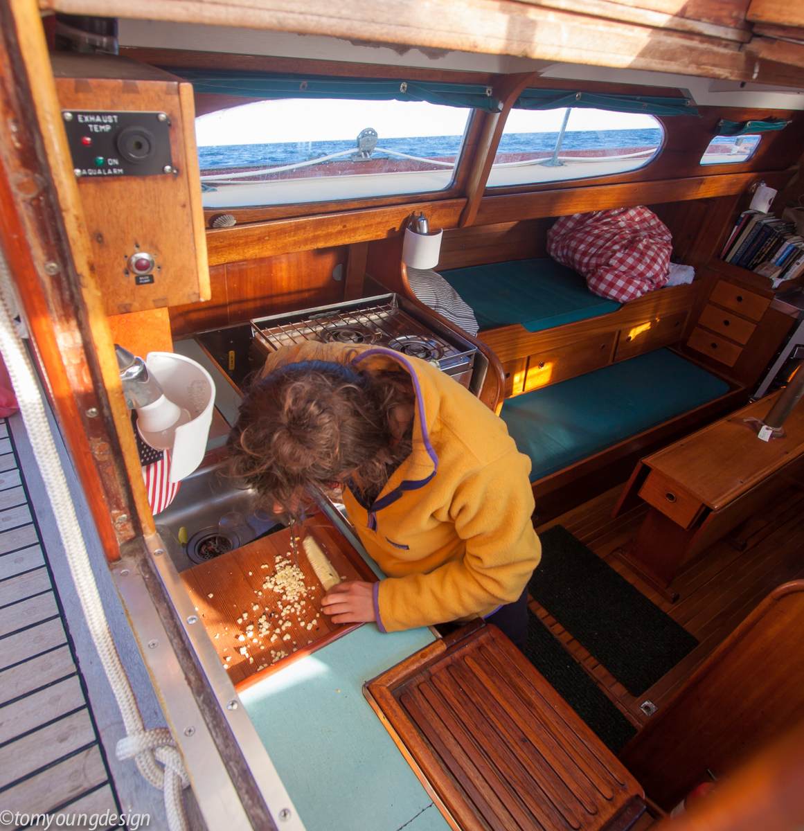

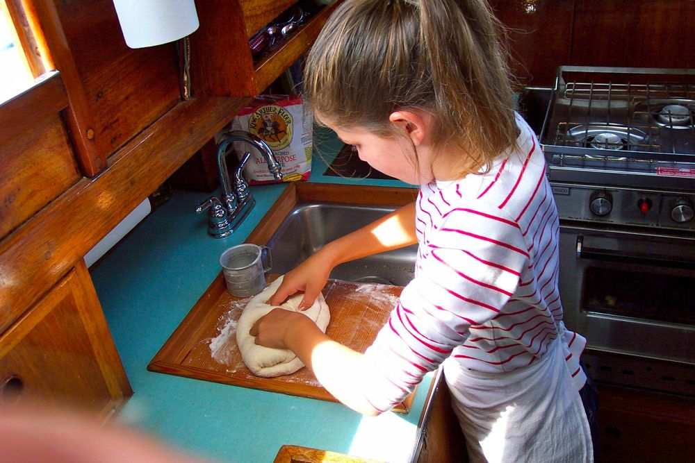

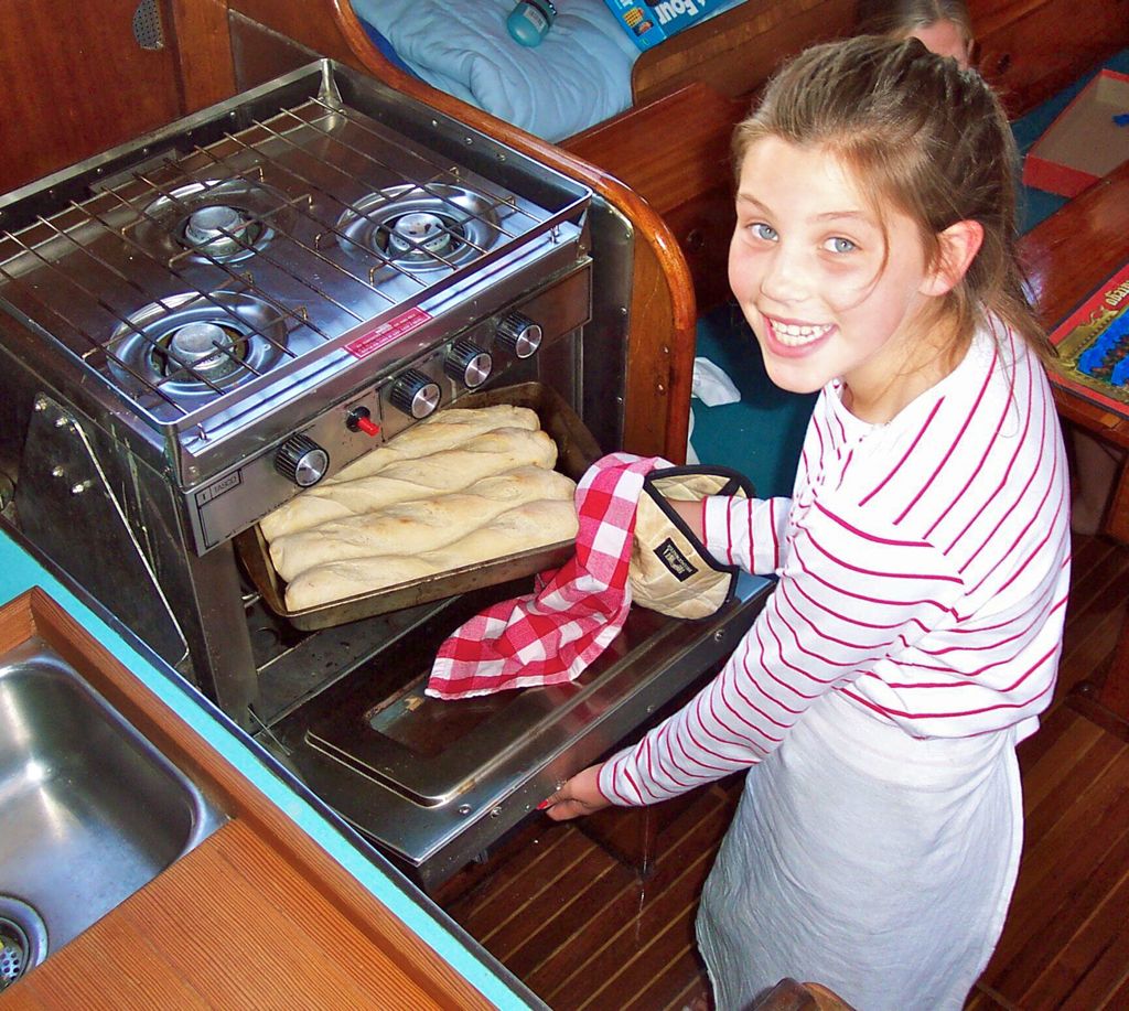

So it got used heavily in the galley as a cutting board to slice and dice, a fiddled work area that was very handy underway, constantly. Another benefit was this gave us a deeper more useful sink as the whole sink board is a sink of sorts.
As it's primary function, access, I've used it constantly. All you need to do is loosen the lock nut (it's just hand tight) on the sink drain basket and the whole board simply lifts out. Installing and maintaining wiring, plumbing, water heater, FW pump and filter, even adding engine oil, it's made these tasks easy.
I wouldn't have believed it but 17 seasons later, the 'mock-up' is still in constant use. Here is my daughter this past season, chopping away on it. Just after, I washed all the dishes on this same stiff heel, with the drain board awash. No leaks.

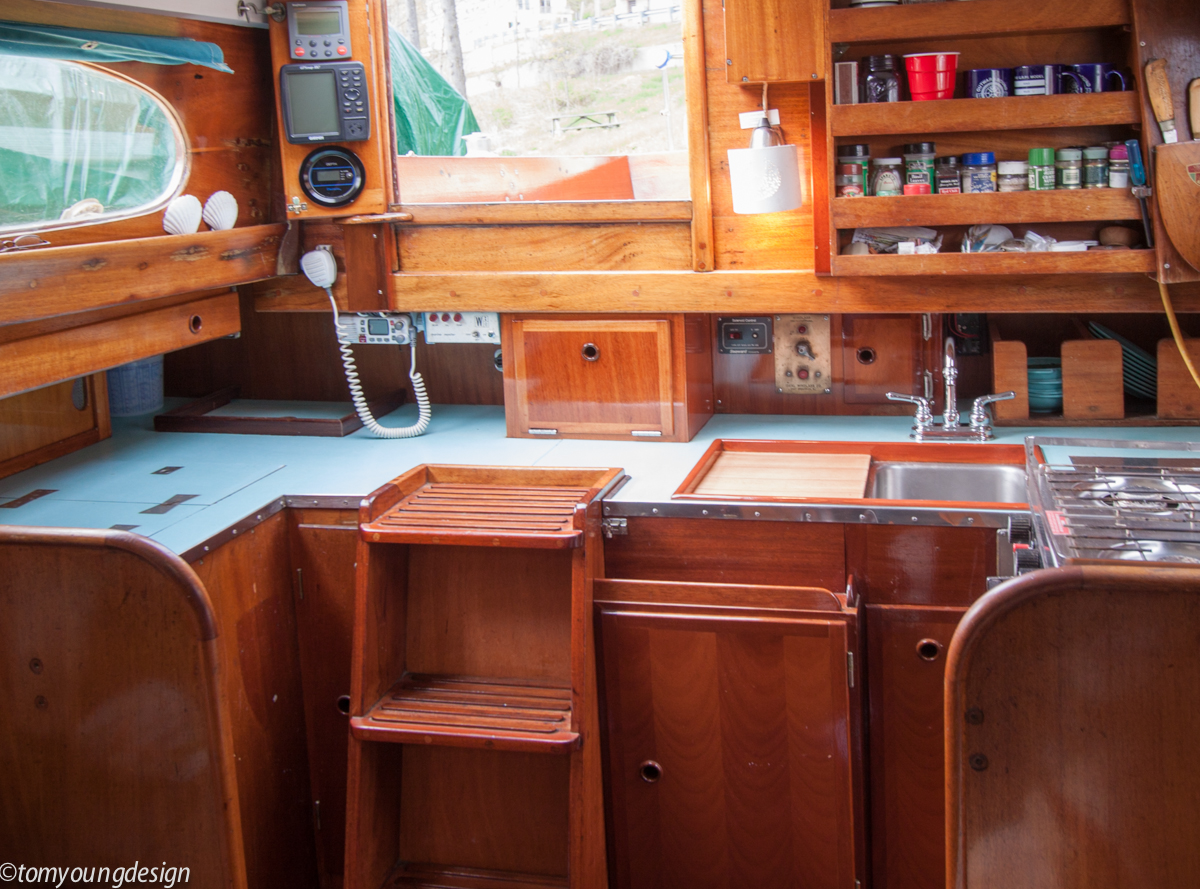

I gave a face lift last spring which was a RO sanding with 80 grit. It looked so good I cleaned up the L trim, stained it a mahogany to match, applied several coats of varnish and oiled the fir flooring.

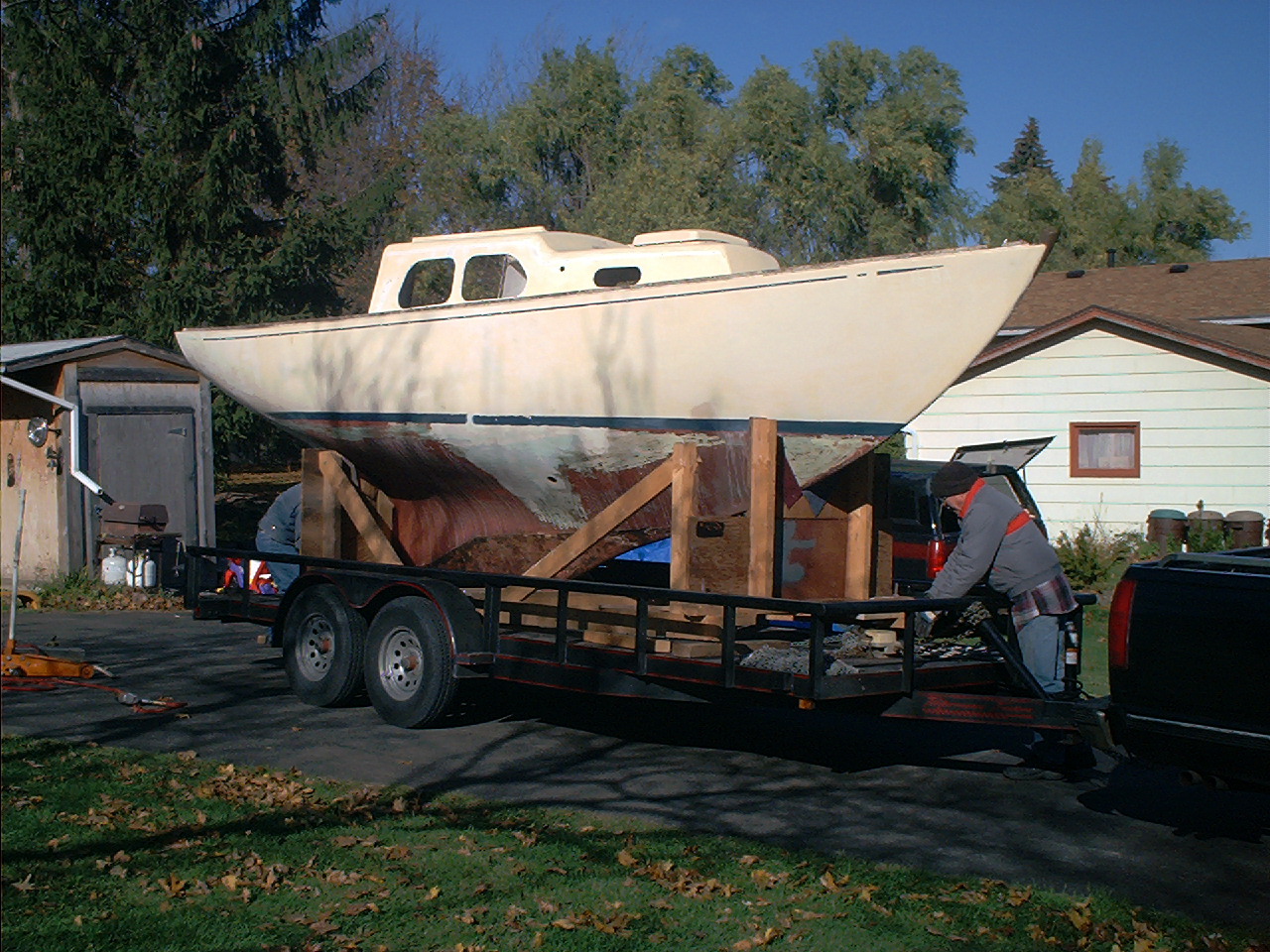

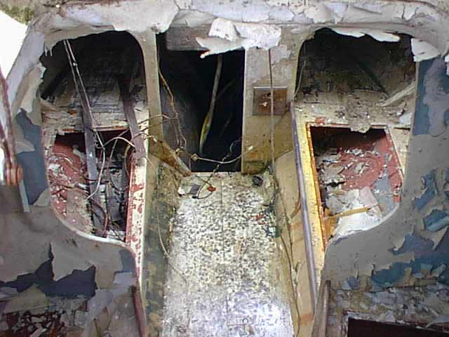

Three quick pics- first- as salvaged in Rochester New York, after being abandoned for 15 years- Second and third- after being hauled to Texas and reworked- 18 month project. MANY more shots, because much was done.
She's now coming up on 12,000 cruising miles-- three round trips Texas to Florida, and one around to Annapolis, via the Bahamas. Now has damage from Hurricane Harvey that I HOPE to be fit enough to repair very soon :)

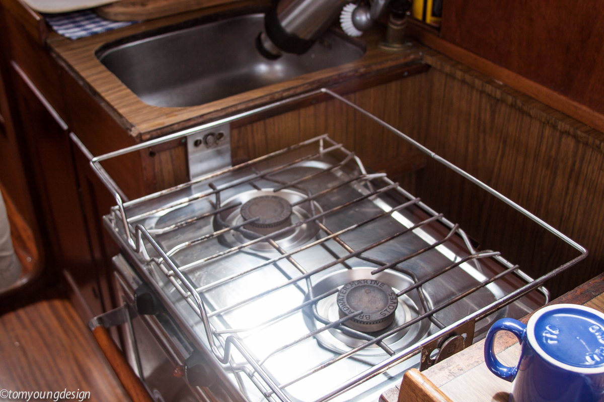

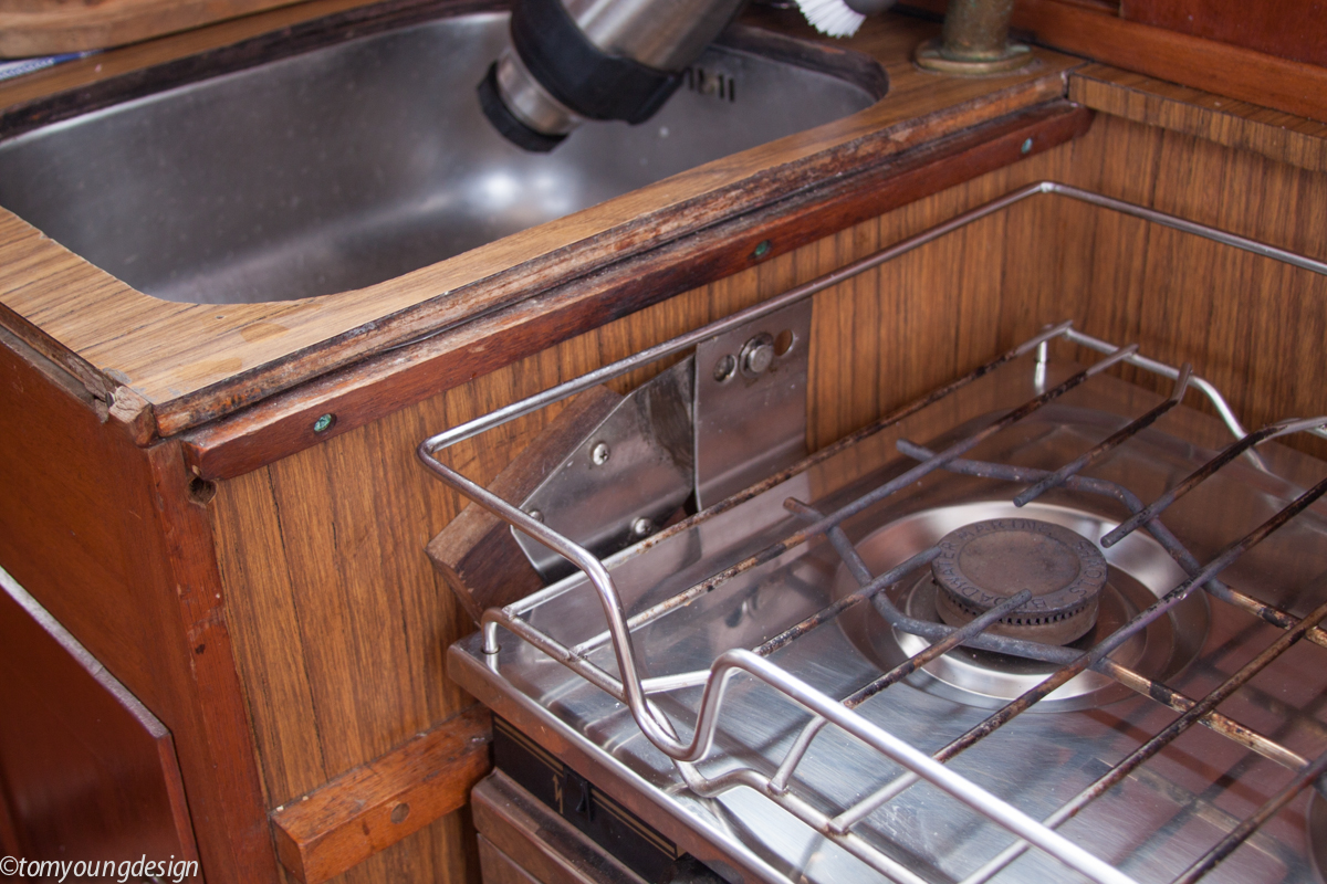

I got onboard and I was impressed with this little trick on his Broadwater stove in the galley. Just a simple block the gimbal is mounted on.
Like many gimballed cookers, his has to be high in the counter and stick out into the passageway in order for it to have clearance to swing. Here it is in the swinging position:
But most of the time, it's secured in this position; by pushing the stove back - which rolls the blocks over into another spot.
In this position, the stove is all the way back in the recess and lowered. It's beneath the countertop and he fits a filler piece above when the stove isn't in use.
Clever modification.

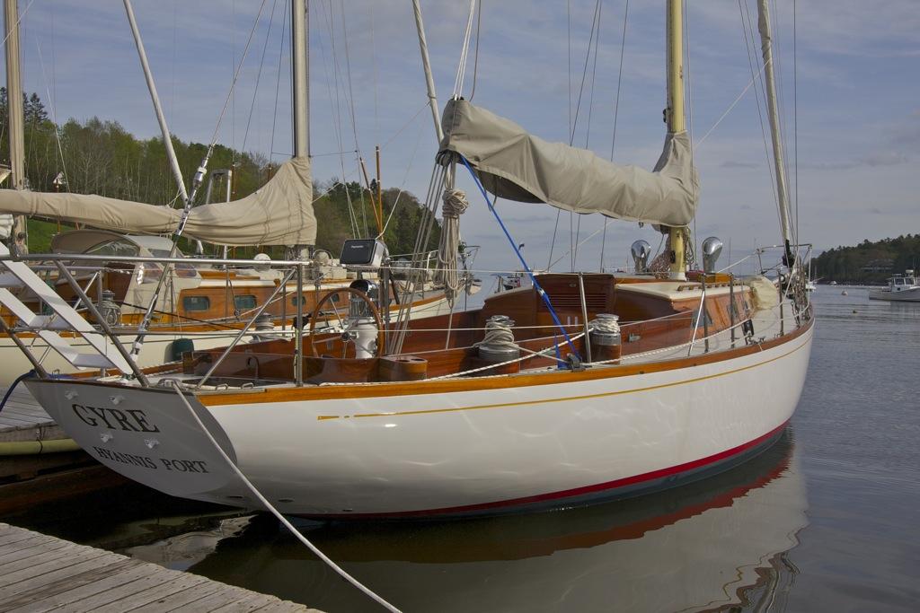

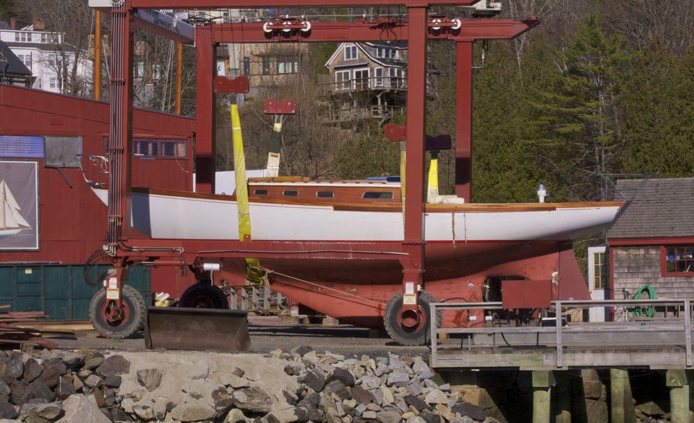

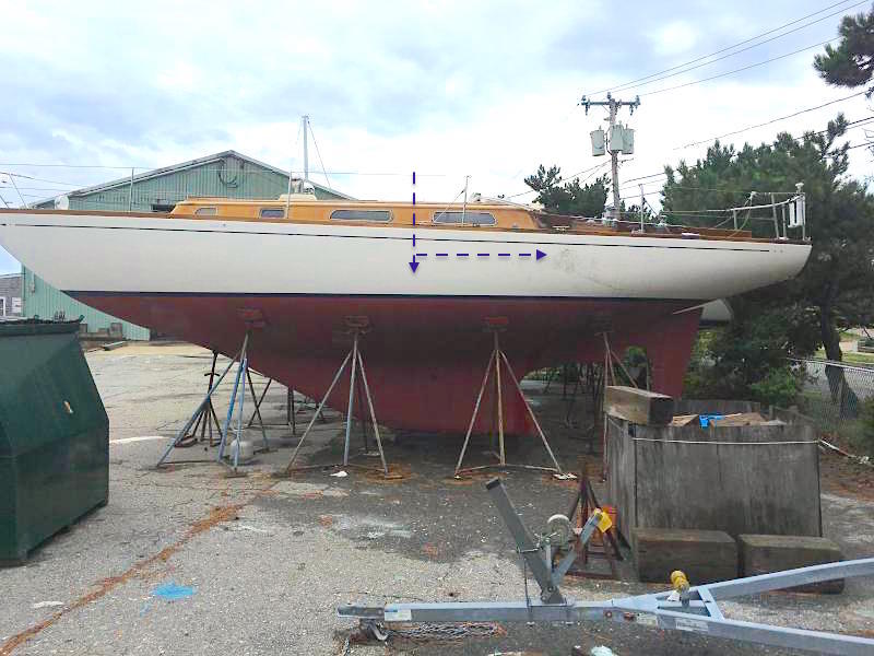

This is one of the more drastic modifications I've witnessed (and posted back then). The owner bought an Ohlsen 41, a 60's CCA design and brought it to the local boat builder. He (owner) wanted to remove a large chunk of the house and extend the cockpit from about 8' to 12' in length. This required some extensive work in the design office. The result - cut here:
Once the major surgery was complete, they launched the boat to see how it floated on it's lines. Gone were the galley, nav station, ice box, etc. Here you can see the hull area the house and bulkhead(s) were removed - relocated.
Back in the shop the project was completed and the boat launched in the spring.
Controversial with some, I thought it was very successful. Extensive modification, yet the revamp of an older boat was a small portion that a new build would have cost.
The design is all about the cockpit that will seat a large group.
GYRE is owned by one of Bobby Kennedy's sons and races and day sails out of Hyannis Port, Ma.
Entertains 12, by the count:

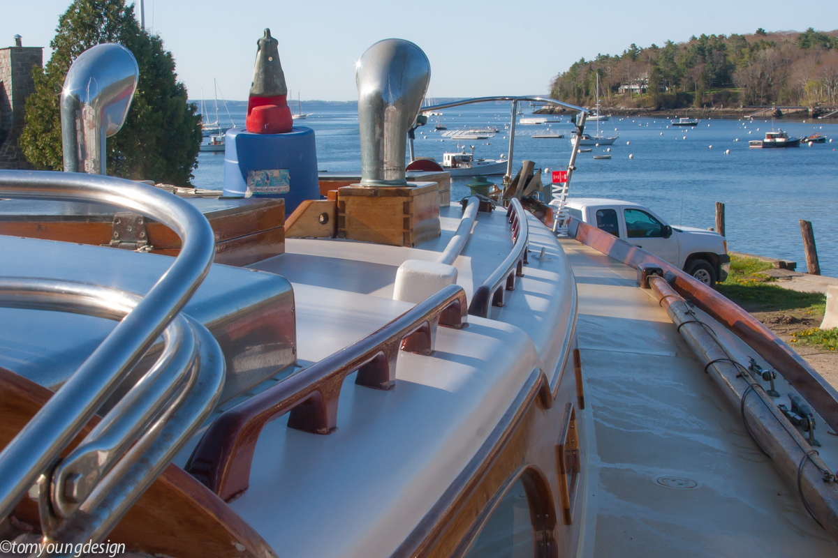

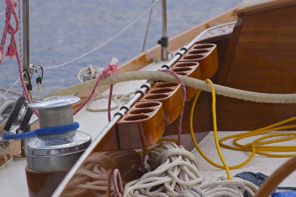

I built a set of handrails some years ago. I thought I could improve on the off the shelf design available everywhere.

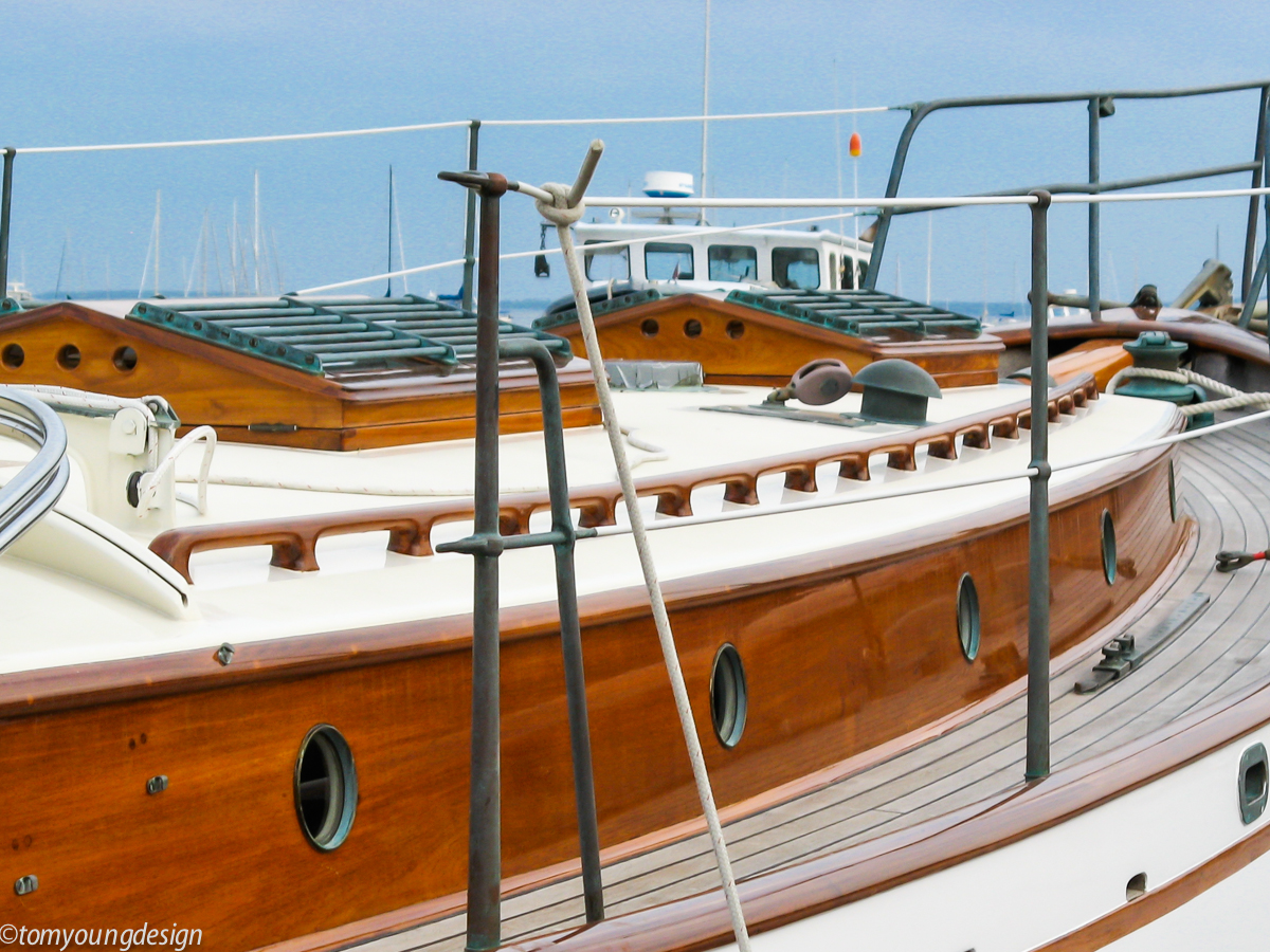

Combing the docks of old wooden boats I looked for ideas. This shapely set of hand rails on a 1930's boat caught my eye. After close inspection, design elements that appear gratuitous at first glance, turn out to be practical.
These rails tapered in profile from wide bases or feet to a hand friendly round at the top. The 'loops' are closely spaced as well.
Handrails are notorious for deck leaks. The wider attachment point of the wide bases, closely spaced as well, would be more secure and a better seal. Simply, this was a better handrail design than off the shelf.
I wasn't willing to get as involved in the shaping but I'd go for the wider bases. After some thought with a pencil and paper,...

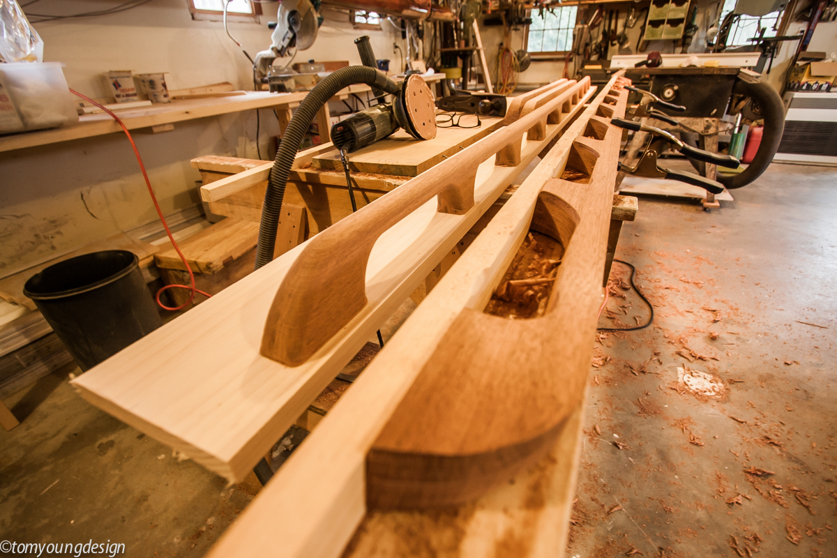

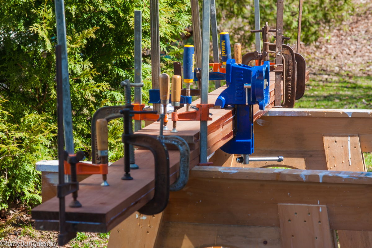

I bought easily available 3/4" Sipo from a local supply and went about building up 1 1/2" handrail stock.
With all my clamps I waited for an epoxy panini sandwich to cook:

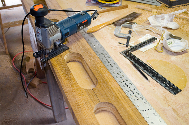

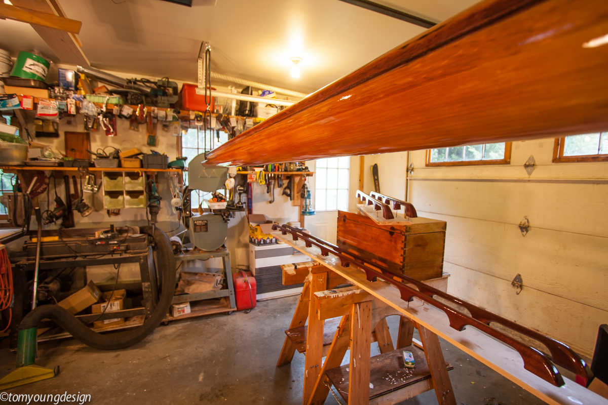

Then using the simple fast handrail cutout method: Spaced hole saw cuts - cut out the center material, rip down the middle. Voila, a pair of rails out of the glued up stock (not my photo below).
I had an additional step as my rails were 1 1/2" thick. I cut a taper; 1/ 1/2" base to 1" top, on a table saw. The cut rails mounted on a scrap of 1 1/2" pine, it was easy to sand the faces flat and run a router with a 1/2" rounding bit to form a 1" round loop.
The rails were protected by a build up of varnish, easy at this stage. No matter what sealant you use, sealing the attachment bases will give the best performance.
The last part of the improvement is controversial: These rails would be fastened from below, with screws, not through bolted. This requires careful measuring and pre-drilling pilot holes. Plus my design had the screw threads in mind with the thicker bases and the epoxy line down the middle. First mounting with poly sulfide sealant:
But I was planning for this second mounting, about 6 years later when I recoated the house top. I went below and with a screw gun removed all the screws. The rails went back in the shop for a few easy coats of varnish(the old finish was fine so stripping wasn't needed).
To remount the rails, my daughter gave me a hand (here she is applying butyl tape - we do evolve). With her on deck feeding the screws into the holes in the bases, and me turning the SS screws from below, we had the rails re-installed in no time.
Compare this to through bolting; which is a near permanent (until the rails fail apart from lack of tedious maintenance). These rails have already saved me time and leaks just in less taping and they will never need to be stripped and refinished in place, a nightmare.
And they are more than up to the tasks of doing their simple job, keeping me safely on deck.
