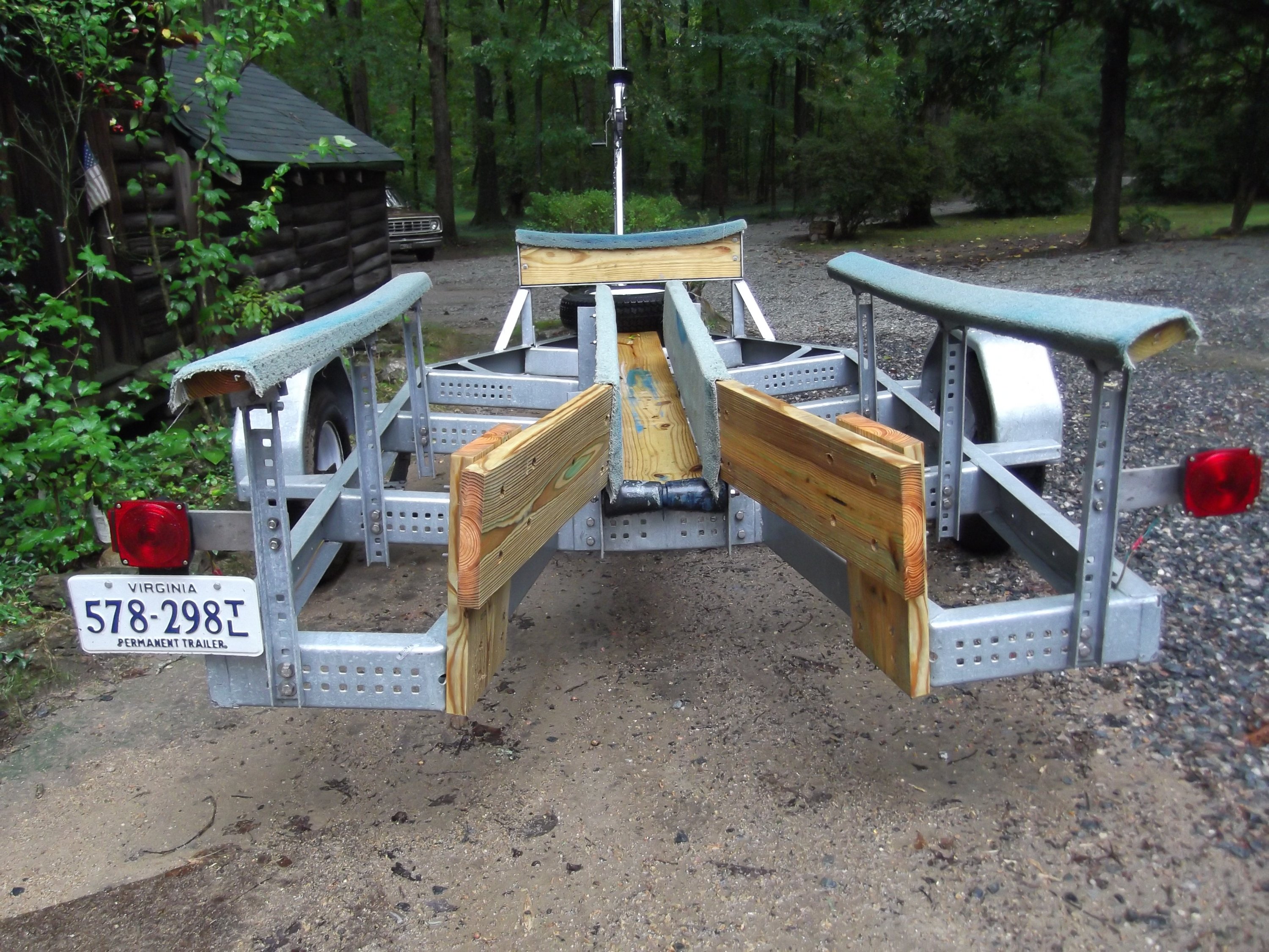

Good morning. My 22' Oday is tied up in the Potomac river and as some of you may know there was a very bad storm there this past weekend. I knew pulling the boat was going to be kind of dicey so I made a modification to my trailer that worked out really well and I thought I would share it with whoever may be interested. The problem I have had in loading the boat on the trailer has been hitting the slot in even a moderate breeze or tide. The back of the trailer is waaay underwater and you can't see what you are doing. I added a "chute" to guide the shoal draft keel into the slot and it makes a world of difference. I was even able to power the boat more then half way onto the trailer and then attach the winch cable and I didn't have to wade out to the bow eye. This was kind of an emergency modification and I haven't gotten around to carpeting the chute yet but it worked very well.

I did something very similar to our trailer as our keel extends down below the hull and there is a 4" wide slot you have to hit with a 2" wide keel. I extended the outboard bunk boards back to make the V a tighter angle then fit 2x4 guide boards between the inner and out bunk boards on each side. Now if Cindy is a little off the guide boards help line the keel up with slot. Works very well.

Yup. I've seen it done with PVC pipes, too. My trailer has roller pods and a square frame well aft of where the keel guides are, making attachment points for guides a big more problematic. I have thought about building up the boards taller either side of the keel rollers, but one reason I haven't is that it makes it difficult to get to the keel for painting. Hmmm, I'd better get thinking on easily removable boards, haul out is just a few weeks away...

it is called a keel guide. you will find them very handy. One word of caution though, if you go off the end of the ramp or the ramp tends to angle upward to include ground under water, it will be difficult to get the boat on. Very rarely that happens but I have seen it. Kermit can explain at an old ramp he used to launch his H260

Thanks guys. I don't intend to use this on strange ramps. There are really only two places I launch. One is at Dutch Gap on the James near Richmond and the other is at Lewisetta Marina in the Potomac near Smith point in the Chesapeake bay. I intend to leave her down at Lewisetta until December. The only reason I considered hauling was because of that hurricane that didn't happen. We did have a North Easter with 40 K winds but I didn't haul. I did make the modification for both places however because it has been a crap shoot hitting that slot when the trailer is four feet under water. Yes I have seen folks back off the end of a ramp where there is at least a foot of drop at the end of the concrete. Makes the day very interesting to say the least. Going down Sunday to mount some cam cleats for my jib sheets. I'm really getting tired of uncleating the sheets, hauling them in and recleating with one hand in a stiff breeze. Going to be a nice day for a sail too. Thanks again.

I did nearly the same thing for my first monohull. It was kind of funny as the guys at Lowes were trying to help me find warped treated lumber. Normally their customers are looking for straight boards. I was able to find two boards with a substantial bend toward the end. Worked great for a nice V entrance. The only problem I had to watch out for was to not back the trailer in too far. I found it very easy to land on top of the V, rather than in between it.
