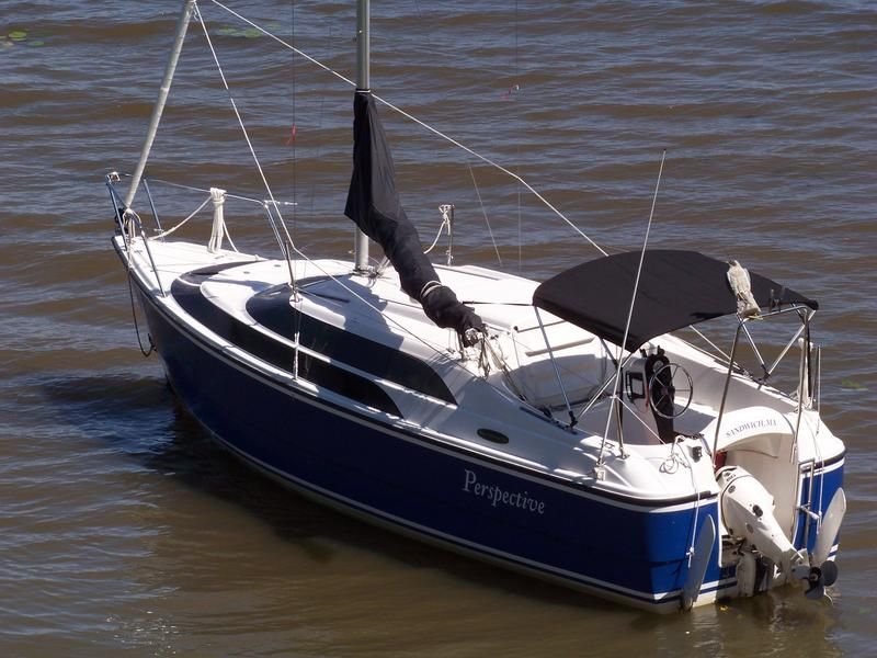

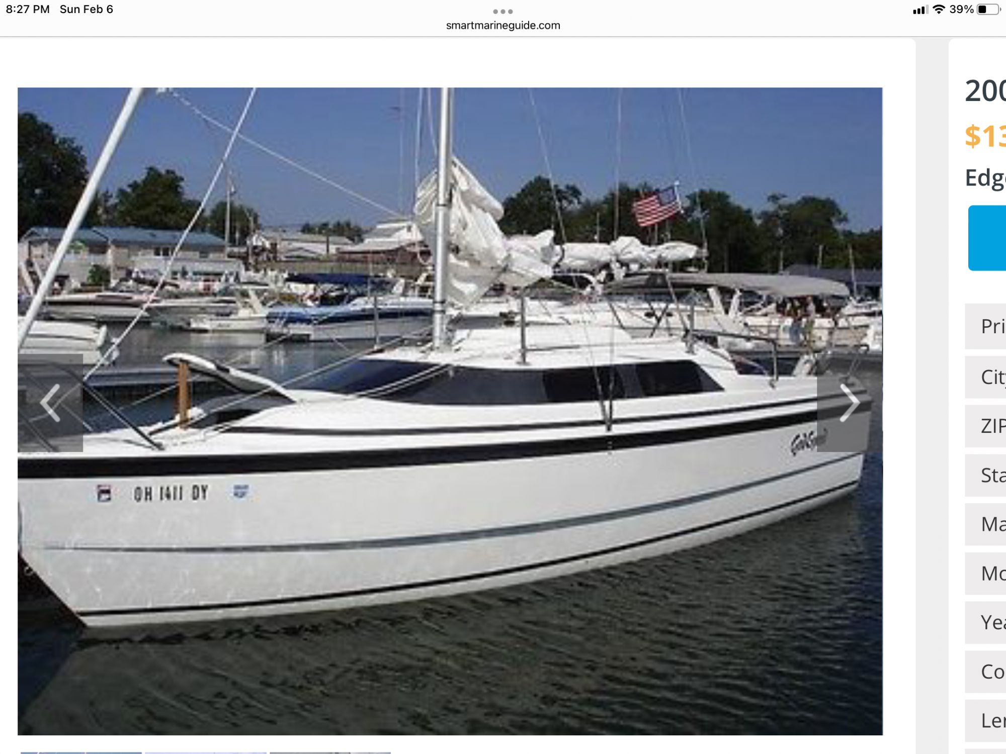

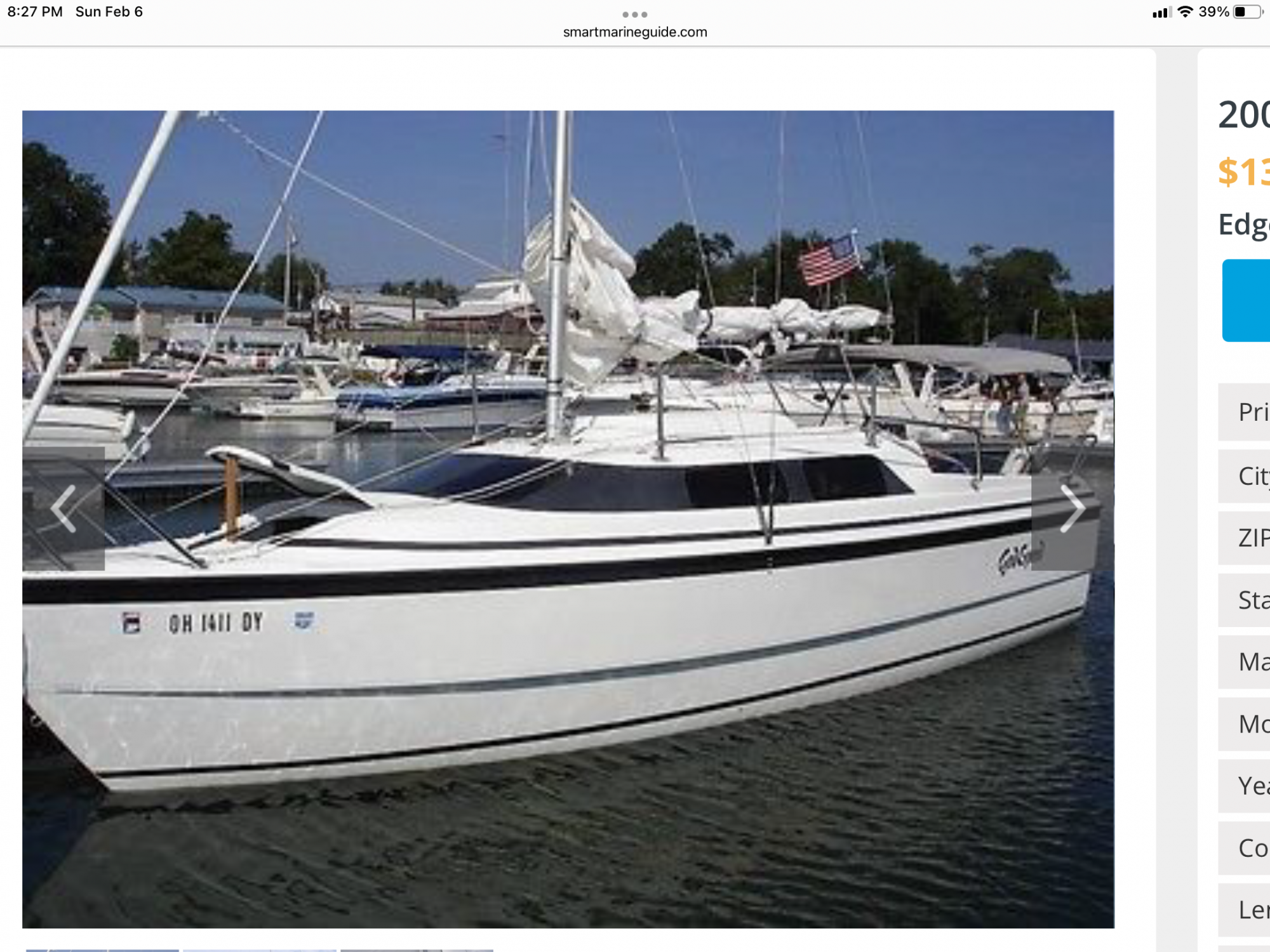

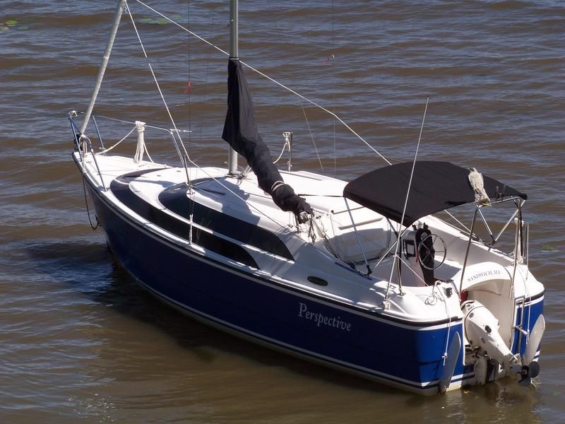

I don’t really know. I found a few photos of 26M’s with bimini’s…mostly some light tubing and canvas.
80C2F486-9EDC-4C52-B644-9FF95C34E619.jpeg 60EA0951-5966-4E10-992F-0F048EE7BB8F.png
Those can’t weigh much.
i think I am most concerned with the “side decks…with a fishing chair mounted…”. Maybe I am not envisioning this right, but that sounds like a significant weight ( I weight 200 pounds) off-center, and 4 feet above the deck…
