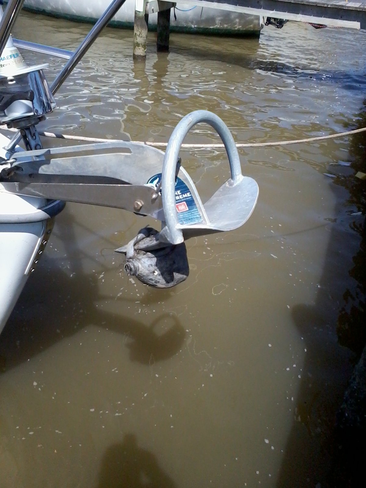

I love our Manson Supreme. I extended our bail with a couple of tangs, to accommodate the wider shank of the Manson, but I have never seen the anchor pull up tight on the bail. I think the curve of the shank on the bow roller keeps the anchor in place, as long as the chain is kept tight.
I also use at least 5:1 scope with all chain, unless we are anchored just for lunch in a tight anchorage. I always carried three anchors on long cruises, with three complete rode setups. There actually were times when the all chain rode did not work well at all.

For our anniversery I bought my wife an Manson Supreme Anchor and UPS delivered it to her office!
Nothing says love like a Manson Supreme anchor, But we had watched and read all the studies and youtubes.
We carry 30' of chain and 200 ' of rode, we are on the Great Lakes and generally anchor in mud. We never go anywhere and she sets fast!
