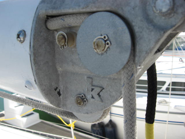

A couple of weeks ago I posted a question, and got some good responses, about the reef line jam cleats that are located on the boom just under the gooseneck fore & aft. ( http://forums.hunter.sailboatowners.com/showthread.php?t=121952 ) The cleats and the small opening in the boom were preventing the lines to the reefing clews from running freely into and through the boom when raising the sail to shake out a reef.
Attached is a picture of my modification to improve the operation. I've shaken out reefs a few times over the last couple of weeks while out on San Francisco Bay, and the lines run nicely now. The sail can be raised without having to constantly free up the line jams at the gooseneck. Some notes:
- My first attempt to improve was to simply remove the springs from the jam cleat so that the jaw would hang down away from the line. Then after tensioning, the jaw could be manually made to engage and it would hold from the backward pressure on the line. This aspect worked, but the line kept jumping off the very small sheave and wouldn't feed consistantly into the small hole in the boom very well.
- I solved this by adding the fender washer shown in the picture. It's 3/8" x 2". Unfortunately I couldn't find a 2" SS fender washer locally, so I had to settle for the hardware store zinc/nickle plated steel variety. I've coated this standard steel with JB weld epoxy. Maybe that will keep the rust at bay for a while. I first tried a 1.5" fender washer which was available at the local West Marine. But the gap between it an the boom casting was enough that the line would still work itself off the sheave.
- The sheave center pin is not long enough to accomodate both the thickness of the sheave and the newly added washer. So I ground down the thickness of the sheave by about 3/32" so both would fit. Fortunately, still enough room for the line to run freely. (Ed, I did determine that the line diameter that a PO had installed and that I'm still using is 7/16". The Hunter spec is 3/8" which certainly would have been better for feeding into the hole ... but I think still not ideal.)
- Unfortunately, the thickness of the jam cleat jaw was too wide to fit into the gap between the new washer and the boom. So I removed the jaws completely. This isn't a problem since I have led the reefing line down to blocks at the boom base which then can be pulled up and tied off of cleats on the mast.

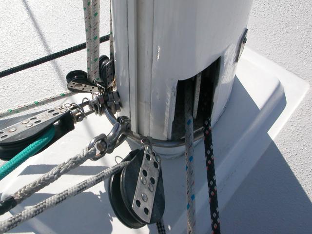

How about a picture of the blocks at the mast base? Any consideration for running the lines up to the luff cringles then back to the cockpit? Now to find the right size stainless fender washer.
Ed:
Thanks. Soon after I bought my boat, I added a bail to the mast base. Intially to accomodate various stuff that never had been installed on the boat (a boom vang and cunningham) and also to make a better lead for the mainsheet. A picture is attached from back then. So it was a simple matter to add another couple of blocks to the same bail the two the reef clew lines. These aren't large blocks.
Yes, I've thought about also addding reef luff lines and doing the reef clew lines back to the cockpit. But have decided against because of even more blocks, new double-level deck organizers, four more clutches on the cabin top next to the sliding companionway cover and generally a lot more clutter. Since I don't sail out in heavy swell open ocean, I'll just continue to be careful when I need to get out of the cockpit to the mast.

Gotcha'. I keep forgetting that your mast partner is so much different from the H37C. Because of our keel-stepped masts we have the bolt-thru partners. I just replace the bolts with eyebolts where I need a block. I agree with you about the clutter problem. I have all the hardware to lead the lines back but I like my clean cabin roof.

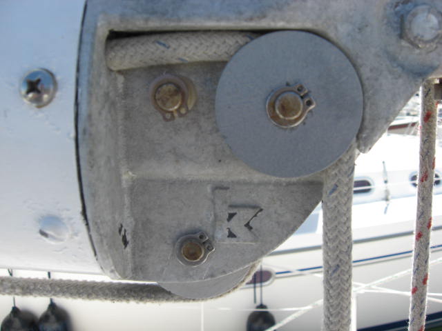

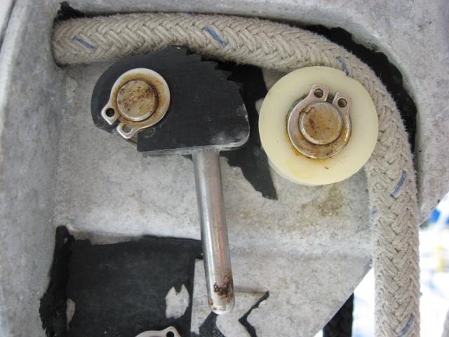

In case anybody has been contemplating duplicating my posted modification to the hardware at the gooseneck so that the reefing lines will run better into and out of that little hole at the forward end of the boom, I thought to update that I've found my original solution wasn't quite adequate. Concept is OK, but the hardware method wasn't robust enough.
Below are pic's of the original OEM fitting and my modification with the removal of the spring cam cleat and the addition of the fender washer to prevent the line from jumping off the little roller sheave.
The weak point of the modification is the little spring clip at the end of the 3/8" center pin. Obviously, it had been adequate for holding the original little sheave in place. But for the fender washer, when I once grabbed the line and inadvertently pulled it to the side, instead of true, the spring clip wasn't up to the task and it popped off. Fortunately the sheave and the fender washer didn't go overboard.
When I contemplated the original modification, I had thought that over a time span of 30 years, galvanic reaction would have virtually "welded" the 3/8" SS sheave pin into the Aluminum gooseneck casting. But while staring at the problem yesterday, I decided to give the pin a few light taps with a hammer just on the off chance that it would break free. Perhaps because I used some PB Blaster to clean the area off when I did the original work, I was pleasantly surprised that the pin came out fairly easily.
I then walked over to West Marine, taking with me the just removed pin and also the sheaves and the various spacer washers. I bought a 3/8" SS hex bolt of the right length (I think it was 4") and two nuts. ($2.99 for the one bolt. Even with the rise in commodity prices, I bet the the markup over WM's wholesale acquisition cost is at least 75% or more. But actually the convenience does make it worth it.)
I reassembled everything using the bolt as the new center pin through the gooseneck. I hand-turned the first nut so there remained just a enough looseness for the sheaves and the fender washers to rotate freely, but also firm enough that things didn't wobble around. Then I wrench tightened the second nut against the first to lock-in the just right amount of free play.
Per my original posting, from the gooseneck, the port and starboard reefing lines are now run down to blocks at the mast base bale. When reefing, I can pull firmly up on them to get a pretty tight mainsail clew and then tie off on mast cleats. When shaking out the reef, the lines have a much better lead into the little hole and they don't jam as readily. Also, it helps if the lines are laid on the deck in a manner that they feed well into the mast base blocks without kinking. Further, I have replaced the reefing lines that are shown in the photos with a slightly smaller diameter.
I think now its done robust enough to stand up to the duty.
