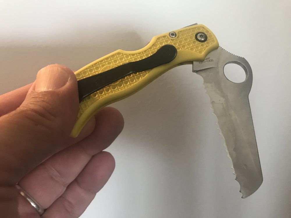

Surprise no one asked about one of these:
I thought we all decided to go out and procure a couple of those for our boat the last discussion. Was I the only one to act upon the mandate?
What’s this forum coming to?
Mar 26, 2011
3,943
Corsair F-24 MK I Deale, MD
That's a new one.
I'm not sure there is a plan for that. I'm also not convinced a PFD would help; it could just as easily have hung him up under the boat. There are reasons folks are trained NEVER to inflate in a plane or chopper.
Wouldn't the pole float? Everyone I have used was sealed and very light. There was nothing "weighing him down."
