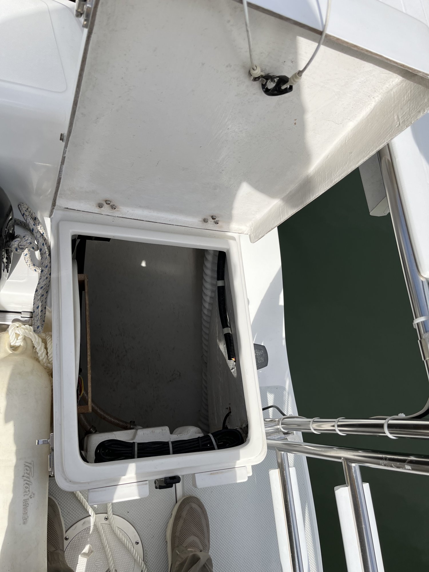

This
This is my 2001 C30 MK.III. As you can see it opens. There are the factory perch seats behind my buddy who is loosening the pushpit to remove and have it straightened a bit. (It was pushed just enough to impede the easy operation of the swim ladder. Not enough to notice when I was buying it.) The other side opens the same way.

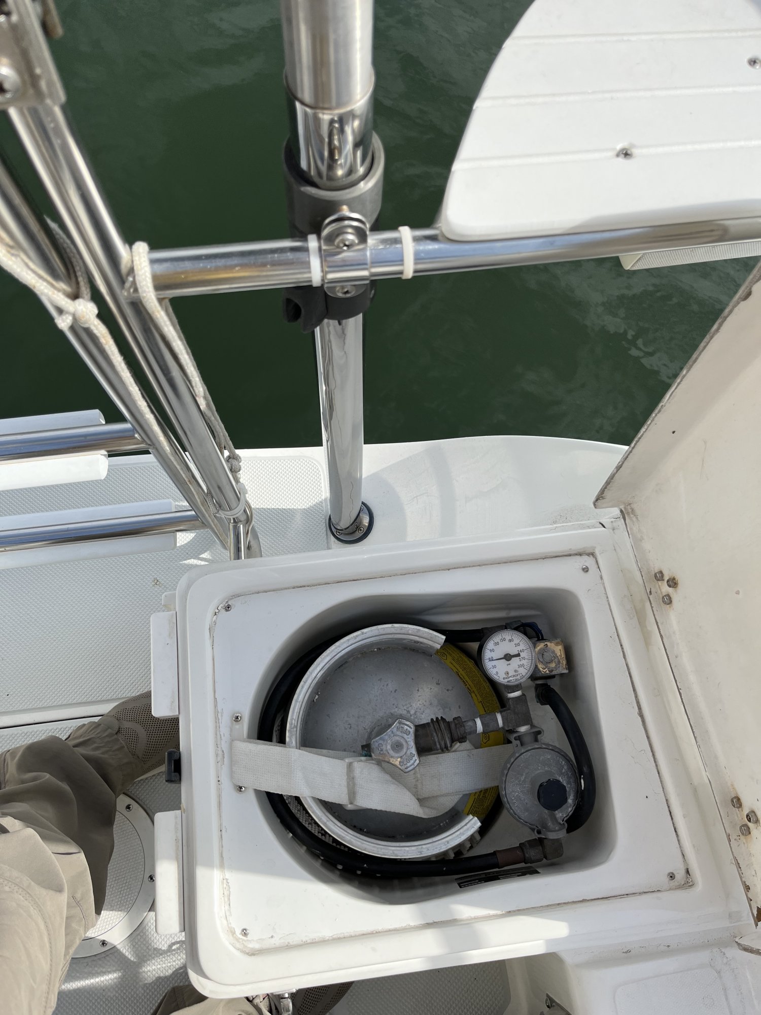

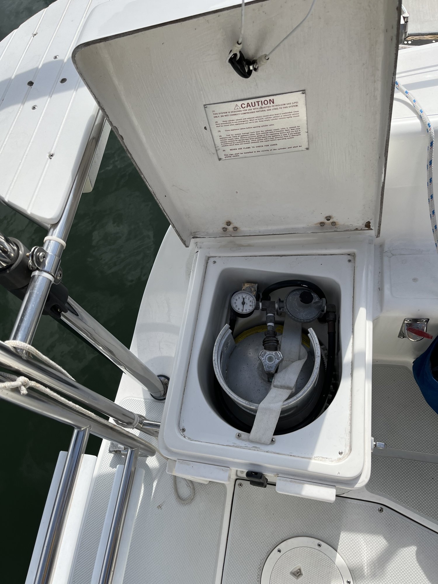

Hi,
I have a '97 MKIII and was wondering if you might be familiar with a propane tank mount in the locker you are occupying in the photo. I have a transom radar pole mount whose u-bolt nuts are inside the transom at that locker. I need to access those bolts to replace the mounting block, but cannot figure how to get the propane insert to come off. Since it is winter and my boat is about a 45 drive away, I don't have the luxury to get to it for some time. Thanks for all suggestions.

Have you ever removed the insert? If so, is it just the 4 small screws, or am I in for a surprise?
It looks like just the four screws AND A LOT OF 3M 5200 or maybe 4000. I think you may break things trying to get it apart.
Apr 5, 2009
3,217
If it is bonded with 5200 or even 4200 you can get it loose with little trouble by using Debond Marine Formula.
It doesn't dissolve the adhesive. Instead it makes it let go of whatever it is stuck to. After trying it once, I will never remove anything stuck with adhesive using any other method.
