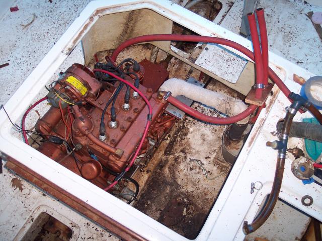

Last Sunday while coming into John's Pass in Florida; I discovered my mixing tee sheared in two at the threaded connection. Had a friend onboard and kept pumping the bilge w/auto pump & emergency manual pump to get in.
Spring tides were running against us @ 5 knots with me @ full throttle making 1 kt. headway thru the bridge, while water filled the bilge & exhaust filling the cabin. Seems it is always a perfect day's sail right up to the moment something breaks.

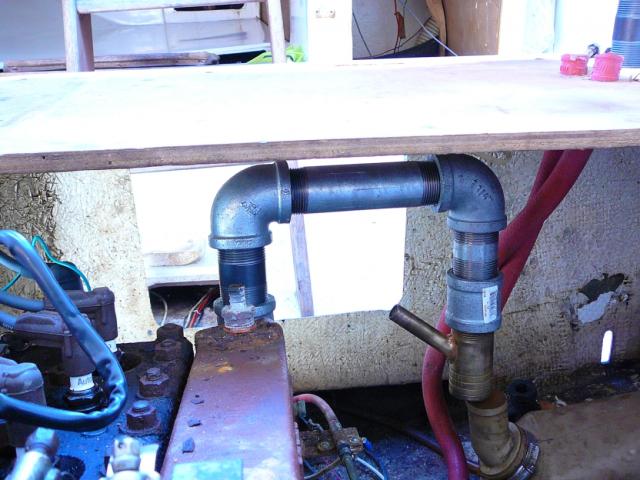

I have a 1980 C30 and replaced the 5411 some years ago with the 3M20A. I rebuilt the exhaust w/s.s. threaded fittings and was able to use the orig. mixing tee made of brass.
Two things happened a couple years later. The s.s. exhaust piping because of galvanic corrosion between the fittings and the cast iron exhaust flange, I needed to replace the flange & redid the fittings to galvanized steel. Secondly, the brass exhaust tee gave out. The following chart reveals the different interactions of metals:
I checked w/RB Groves (Miami), Westerbeke, & Catalina Direct for a replacement. Here is what I found. Because of height restrictions, Catalina custom made the mix tee & you can get a complete piped system for your boat. They asked to have you send your orig. exhaust and they would make a replacement. Unfortunately, it is all s.s. fittings for about $375.00 but I only needed the mix. tee. I tried to get the service rep to give me a number to the manufacturer for just the replacement tee but to no avail.
I asked how they isolated the s.s. piping from the flange and he said they have a putty compound. That was a laugh.
Well that did not work so I made a weldment drawing & I went to my local fab shop that I use. These are great guys and are making me a stainless one for $60.00 & a cheaper priced spare. If some owners have a s.s. system with no problems, that’s a good thing. Additional factors for metal breakdowns are where your boat is located, current draw from nearby boats, etc.
I am posting this for you guys that have issues w/exhaust & mixing tees. If you have a similar problem, contact me and I can send you the drawing. Remember to check your dimensions and make any necessary changes.
