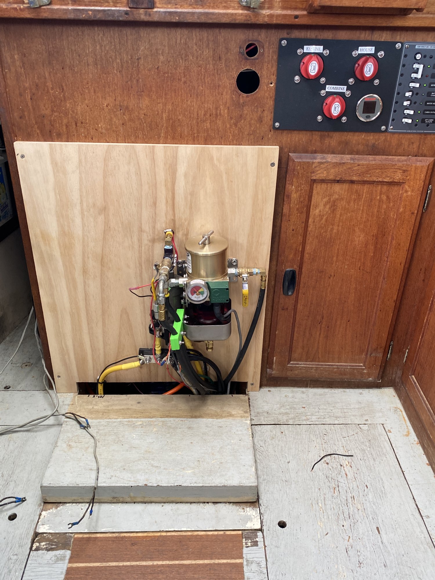

On a practical side, being the penny pincher I am, I inherited (in my boat purchase) 2 tanks of diesel in 2015 from unknown sources, age, and quantity. I was not prepared to toss it as the price per gallon was in the neighborhood of, so I added 35 gallons and consu $5 USD a gallonmed the fuel over the next couple of years.
There was microbial growth and water in the tanks. I addressed this with a two-pronged attack. I installed a Racor 500 filter housing and bought a supply of filters. I shocked the tank with additives designed to kill the "diesel bugs," changed filters frequently, and added more fuel as needed with additives. Cruising over the past seven years consumed the original fuel.
These last 22 months, during the engine rebuild, the fuel in the tanks has likely developed some contaminates. Once the rest of my boat refurbishing is complete (which includes the installation of my new filter systems), I intend to utilize the polishing capabilities of the system, inspect and treat fuel in the tanks, and filter as necessary.
I've written about fuel issues here in SBO and solutions I employed.
Here is what new my primary fuel filter system looks like.

I suspect you will be just fine with the actions you have taken. Additives can improve the lubricity lost as fuel ages and clean up any "diesel bugs" that are floating in the tank. A good primary filter will capture the critters and waste. Just be sure to check your filter and empty any water that has accumulated in the fuel.

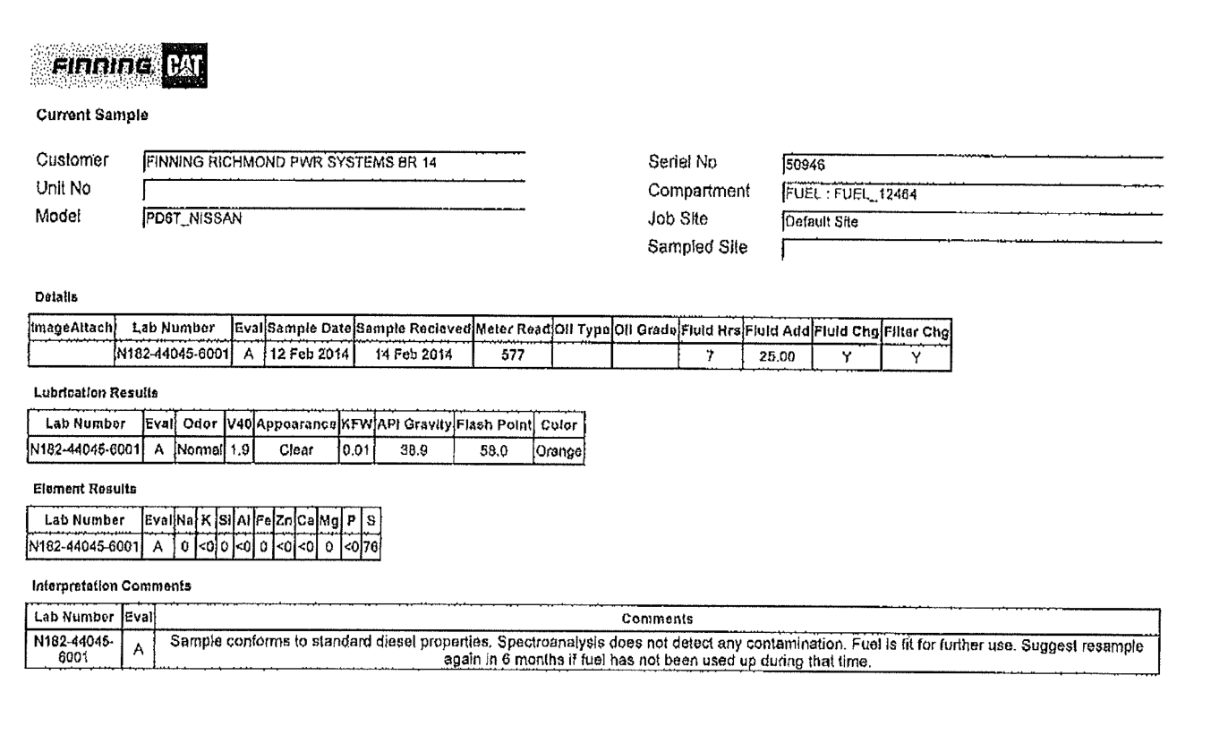

Interesting is all I can say.
Here is an analysis of fuel taken from a ten year old plastic, 2,500 liter, underground tank which had not received new fuel since it was installed in 2004. We had added Biobor biocide early on and were told the generator was test run by others once a month for an hour. Fuel was tested in 2014.
We took the attitude that if the fuel was properly cared for, keep testing annually until we were told it was NOT fit for future use.

So maybe my simple, naive approach did not destroy my engine.

So the take home message is old diesel is probably OK if it was taken care of in the beginning with the usual recommendations, keep it dry, use a biocide (Biobar JF), and an additive that helps to remove water.
