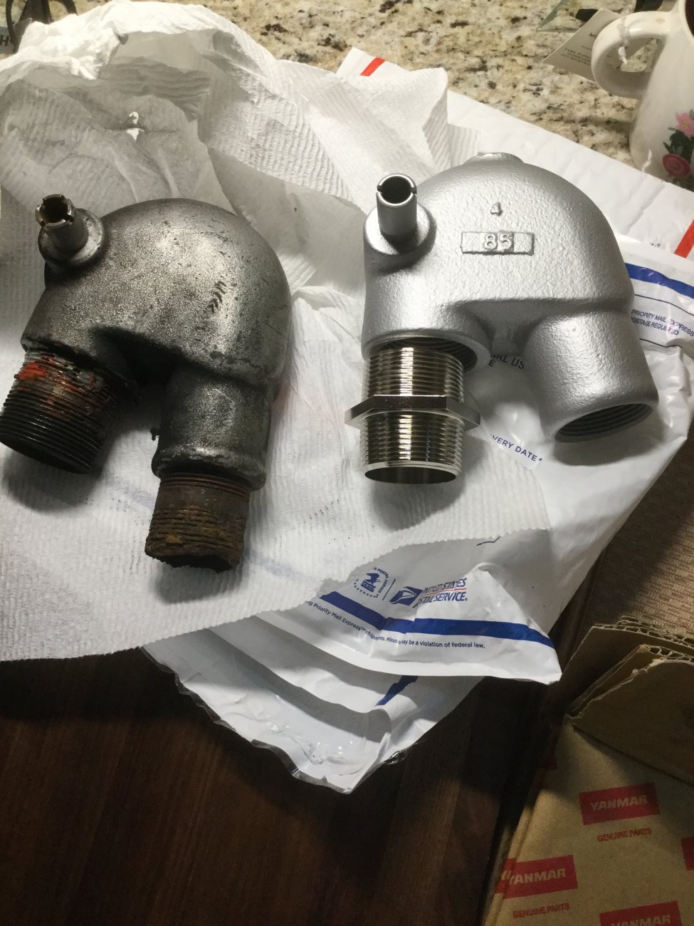

I’m replacing a yanmar YSM8 mixing elbow and have the adaptor to connect it to the lifter but my old elbow also has an adaptor on the other side to connect the exhaust hose. I’m no seeing this adapter on any parts list. Is anyone familiar with this one?

I’m looking for the adaptor on the right. I have the one on the left. This adaptor gets my hose size down to 1.5” to connect to a Vetus water lock muffler.

What you have on the old mixer is a straight pipe coupling, no doubt originally used because it's cheap as dirt. Perhaps you'd rather have a 1-1/2MNPT x 1-1/2 barb hose fitting in stainless steel? They're available.
I agree. Step it down with a hose barb, not another POS coupling. It's a nice feeling when you get to improve on a PO's work.

Yes, this is from a 1979 YSM8. I’ll check into a barb. Would there be an issue with thread match?

If you have the new elbow home, you could take it to a hardware store and find out for sure what the thread size is.
Is that one of the Ebay stainless steel elbows? I bought one a year or so back.

I checked Niemiec marine and he also said to check the hardware store. I got the adaptor and elbow from Amazon which was supplied by Austral marine. In reality our old elbow does not look bad inside. We are local lake sailors with not extreme use. We had some leak at the connector causing smoke. Since everything was removed we are just replacing.

I'd take to local weld shop with a piece stainless pipe that matches the reducer
