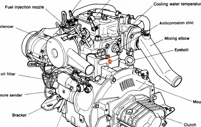

On my 2QM15 the battery ground and other grounds are off a bolt on the block near the transmission housing. I am not at the boat but I believe it is the bolt shown in red on the diagram below. It is either this bolt or the one next to it.
