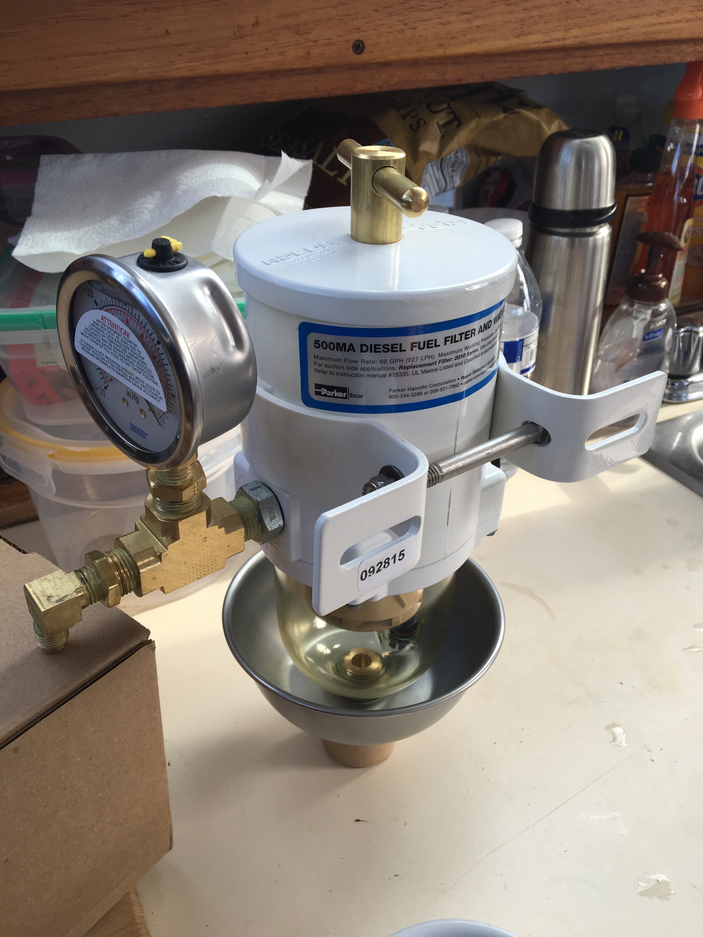

Kirsten, No problem. You can add one if desired. Here is an example of the one I installed for my Perkins 4.107 diesel. It is a Racor 500M. I added the Vacuum gauge on the engine side of the filter to tell me when a filter change is needed. Install is ease project.

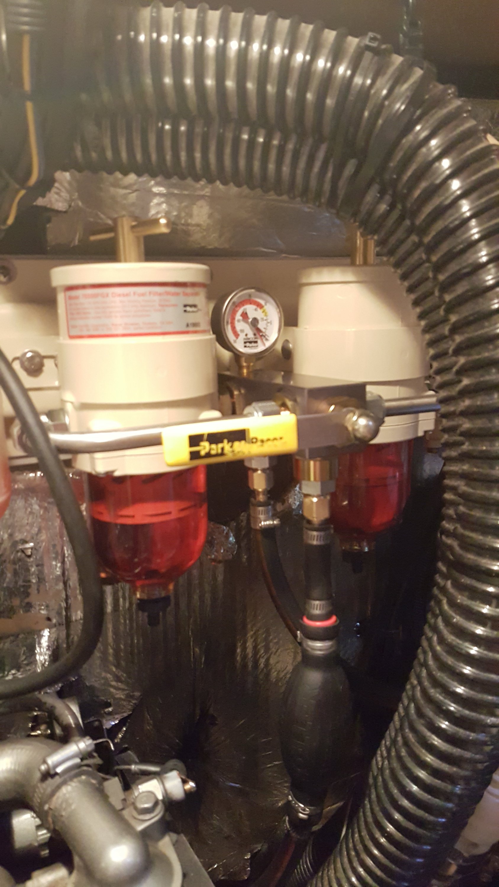

On my 45cc the primary racor filter is located under aft bed. Acess is gained by removing the drawers under bed on port side

The fuel filter that you are looking for in located below the bed in the aft cabin. At the foot of the bed there are 4 pull out drawers, Remove the bottom right hand drawer ALL the way, if you pull it out and then lift up on it you can fully remove it. Then look into the space and you will see the other fuel filter.
Let me know if this works for you.

You guys are great! I looked under the port side of the aft bed last night and nothing was there. Must have gotten side tracked because I didn't look on the starboard side. Just did and vuala - there it is. (smile)
Thank you!!
