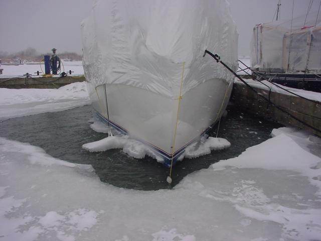

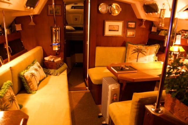

Wintering in-water in the great white north of Canada
No issues with ice in over 20 years. Due to dock power failure and subsequent loss of agitation I've been frozen in solid a couple of times. The ice will safely lift the boat without compressing the hull. However, it sure is a wild ride when you're on-board as the ice gives way under the weight of the boat. Feels like the world is endiing as the boat heaves and drops back into the water! Freezing in solid may remove some bottom paint around the water line. Trying to break ice off the side of the hull will definately remove boot top and or bottom paint, just let it melt off. The safest heater to leave on-board is the electric oil filled radiator type. Never heard of one failing and starting a fire and have used them safely for many many years. I have never winterized the engine or water system and keep the boat warm throughout with a combination of electric, propane and diesel heat (diesel heat (Volvo Ardic) is my back-up heat with thermostat set at 60). In the enclosed pictures you'll see the oil-filled and the propane heater. A half-horse power ice eater will generally keep a 34 boat clear all winter, even with well over a foot of ice around the boat (see picture). Close all through hulls when going away for any length of time. An old fishermans trick is to some pour molasses into through-hulls for the winter. It won't freeze and expand and it is evironmentaly friendly when you open them in spring.
