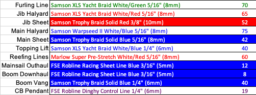

Here's the list of lines I used on my O'day. The last column is qty of feet I ordered. Some were long and trimmed to an acceptable length.

Thanks Ward. I like the idea of using a rope clutch, but not sure I can find one to fit ¼”. Will look around.

I can't think of a reason not to use 5/16" thru out the boat.
You could use cam cleats on the 1/4" lines.
