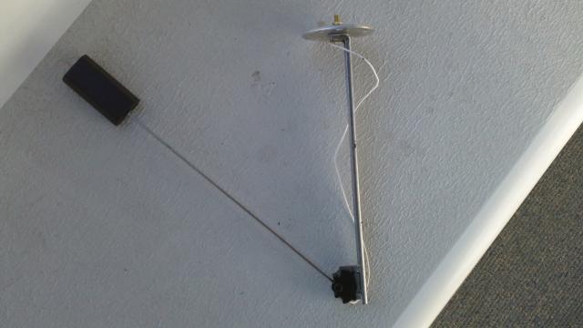

Well, the first thing I discover is the sending unit has to be modified very precisely for the tank dimensions. First, you shorten the float arm based upon a chart and then the support arm by a factor of 50% tank depth plus some fraction of inches. OK, so that makes sense as to dropping the pivot point half way down the tank and they obviously have a lot of experience I don't, so I dutifully cut everything to spec.
I drilled a 2 1/8" hole (hole saw $13) for the gauge and ran a hot wire from the oil pressure gauge, then hooked it all up, and it worked (sorta). The gauge showed 1/8 tank when the mechanical gauge showed 3/8. I measured the fuel with a tape, and the mechanical gauge was on the money. So, this is not good; I analyze the situation and decide to install another sending unit but not cut the float arm at all and see where we wind up.
I install the new sending unit and it reads just about a quarter tank. Close enough, I figure. However, when I go to fill up (three weeks ago at $4.16/gal) the gauge isn't reading anything. When I get to Catalina after a round trip, I check the gauge connections and it comes to life, reading about 3/4 full. I use the boat, and the gauge fails to work. I pull it out, and figure it is the gauge connection since it worked when the hot lead was wiggled and now nothing. So, I order a new gauge from this site for half of WM $$ and presto, it works.
So, new trip. Tsunami day (another story), we take a trip up the coast for the YC's Opening Days. Fill up before returning home ($5.18/gal).
Gauge works fine but off 1/8 at full (short of full indicated). Once again find out no gauge reading again when half way home. So, I pull everything apart and check connections. Good hot lead. Hooked up a battery to the sending unit terminals and got good volt readings at the gauge, so those connections are good. So, I figure it has to be the gauge since the system worked fine after I replaced the gauge last time. So maybe a two-failure of gauges withing a day of operation? Seems strange, but everything checks out, so probably so. :doh:
In frustration, I went to WM and purchased a Telefex gauge I liked much better and it was cheaper by 25%. Came back, hooked it up and.... nothing :cussing:
The Telefex gauge came with a decent set of instructions that included a fail-test mode. I checked it out, and this gauge as well as the Moeller were good. Since I know the wiring is good, the only logical culprit is the sending unit. :evil:
OK, so here is my plan: replace the sending unit (ordered from here). Leave the float arm alone and DO NOT cut the sending unit mounting arm, but locate the pivot point lower since it reads 1/8 tank low at both full and low volume.
So, three sending units and three gauges, and maybe I'll have this right.
In retrospect, this stuff was all within warranty, but I didn't have the time to play send-it-back and didn't want to stick WM with my (possible) incompetence. So, this is how a $60 one-day job becomes a $240 month-long marathon. For those of you who do this in the future, there is a module you can add on top of the direct-reading sending unit to convert it to electronic. Whew, that is the way to go!

So today, I installed another sending unit. Still no reading on the gauge. I double checked the gauge; it's good. I figured it's a ground problem since there is 12.8 volts going into the gauge. I grounded the gauge to the fuel tank directly. No change. I reinstalled all terminals; no change. I installed a complete jumper wire to the gauge; no change. Finally, I checked the sending unit ohm range; it was on the mark. So, just before shutting everything down, I tried grounding the tank.
Eureka! That was it. So, I ran a ground wire from the house battery terminal to the lug on the tank and all is well with the gauge.
Here's my uneasiness; why did the gauge work on two occasions before, at least for a while? I could find no grounding wire or strap to the aluminum tank anywhere; remember that it had a direct reading mechanical gauge. What I grounded it to is probably a lifting lug. So, why did it work before (for a while). And, more importantly, have I done anything nasty, like electrolysis by grounding the tank to the negative house battery ground???? I don't think so, but don't feel secure in that. Opinions?
