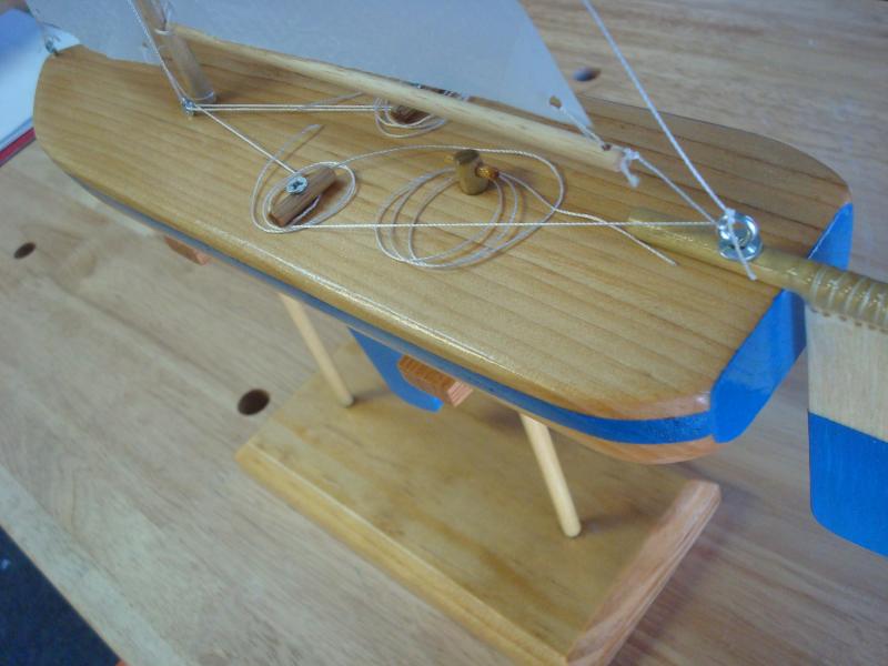

Yes, I've tried to incorporate some of the actual rigging. I decided not to go with the shrouds and spreader as it will complicate the hank loops attaching to the mast. I only have a week to get these done! :dance:

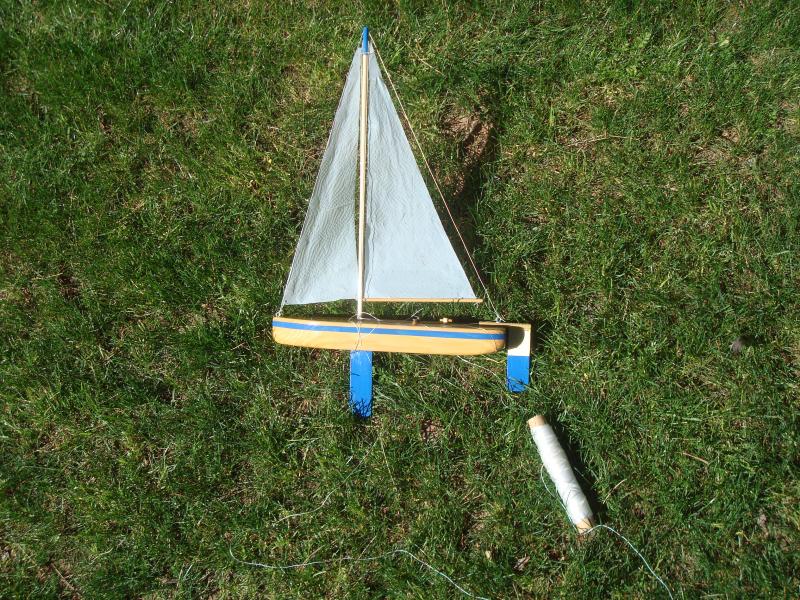

Had a few minutes this morning to run out and test the boat. I tied a kite string onto the screw eye at the base of the mast in case I needed to retrieve it. Very light and variable wind. Without any counter weight at the bottom of the keel, this is obviously a fair weather, light air boat!
A short video of it...
http://www.youtube.com/watch?v=YwajOHMYyRc
Stan

Looks good, but you know you cannot post a video of a sailboat here without a sail trim critique...:naughty:
from about 0:38-0:42 it looks good, but from about 0:43-0:59 I would say the jib is a little under trimmed while the main is slightly over trimmed, and after 1:00 the jib starts to luff.
ease the main slightly, and trim the jib and touch and you should be able to get better boat speed. :)
All joking aside, really nice job!

:D:D:D Yeah the sail trim left something to be desired! I just plunked it in the water and was mostly worried about dropping the camera and losing the tether string! :doh:

Had to make it simple, as I have about only 10 - 12 hours to complete the task for each group of 16 to 18 students, and with 36 boats I have to make them VERY inexpensive! Normally I teach junior high science classes. But this is a special one-week course/activity. We don't have a shop or anything in our small school, so I bring a couple tools from home to set up outside the door on the sidewalk. A sailing activity here in the desert! Would make more sense in Seattle, right?!
On the short test in very light air I got a lot of lee helm, so the keel was moved forward right under the mast and straight down- no angle.

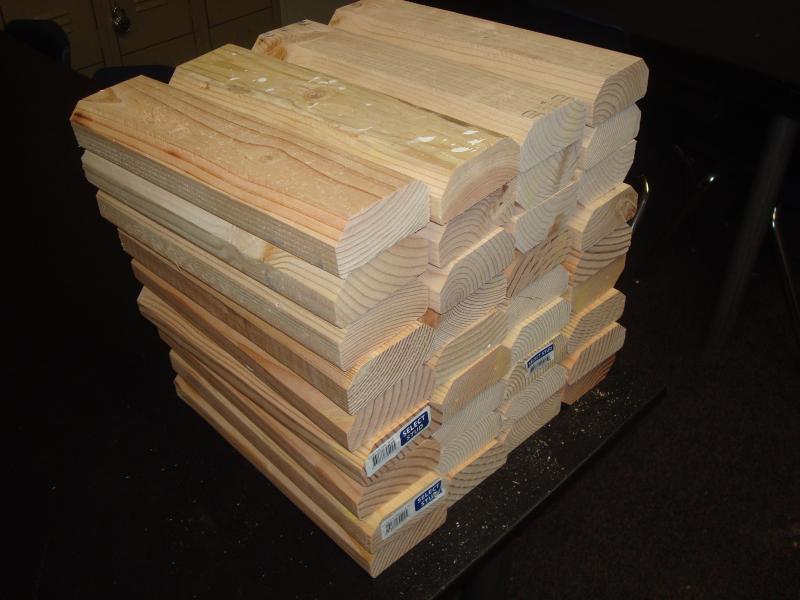

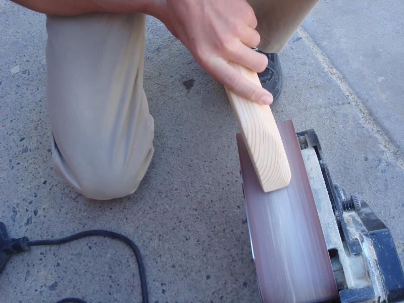

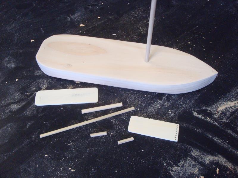

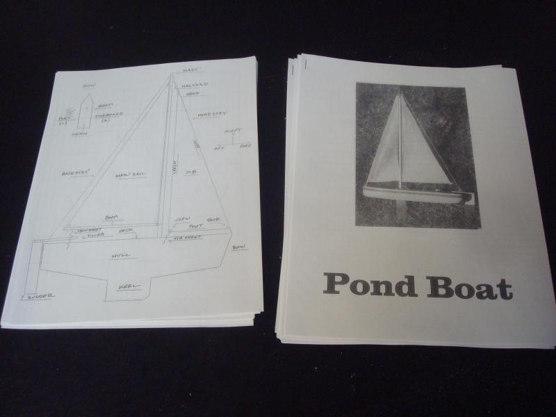

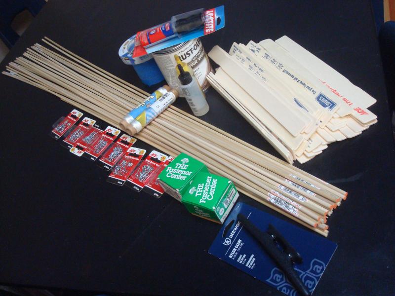

Whew! Day one of our mass-build is over! Started with the hull segments pre cut to length and 45's ripped along the bottoms. Plenty of free paint sticks from Ace and Lowe's. Hardware odds n ends, dowels, and supplies. And of course-- printed procedures which the students will not read. :cry:
Some photos of work getting done. I had the help of one of the high school students. Dust everywhere--- especially on me and my laptop! Final photo shows our progress for the day.
The plan is to quiz them on Friday on points of sail, and some key parts of the sloop. I'll throw in how to tie a bowline, and how to secure a line on a cleat. Starboard and port, of course.

Couple more pics. I bought enough junk for 36 boats, but some students are absent. We'll build more like 30 or so. But the budget figures about $2.47 per boat right now at this quantity.
Stan

I went in to both stores asking to buy the paint sticks for a student project at school (along with other supplies). At ACE the guy wouldn't take any money and said, "I have a giant box of these things, how many do you need?" At Lowe's the guy was quite conflicted at first because I wasn't buying any paint. "I can't sell you these because there's no bar code on them." :naughty: But after a minute he sheepishly grabbed a handful and kinda looking around, he said, "I'm not supposed to do this..." and handed me some like passing contraband. Lowe's, by the way, always gives me a 5 or 10% discount at the register if I show them my school I.D., so they've been supportive of our school. I think the dude at the paint counter simply didn't know what to do at first.

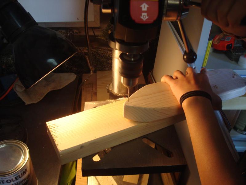

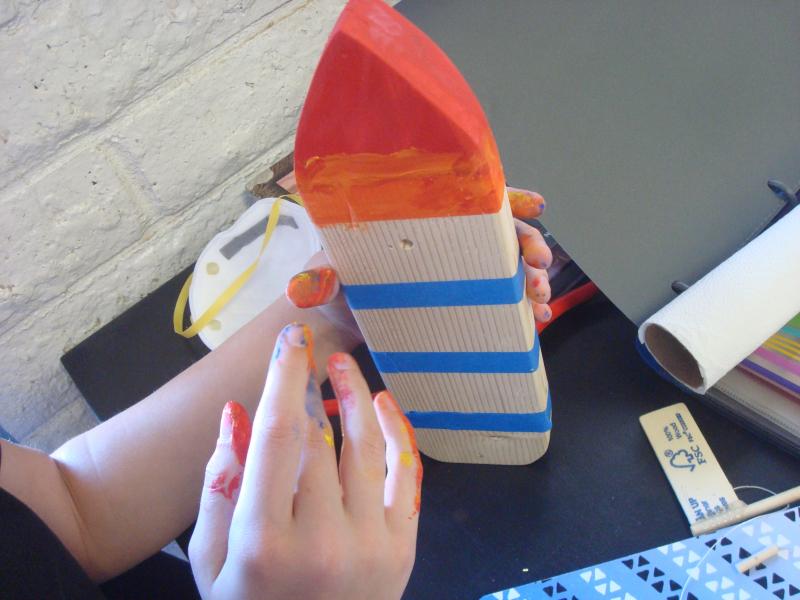

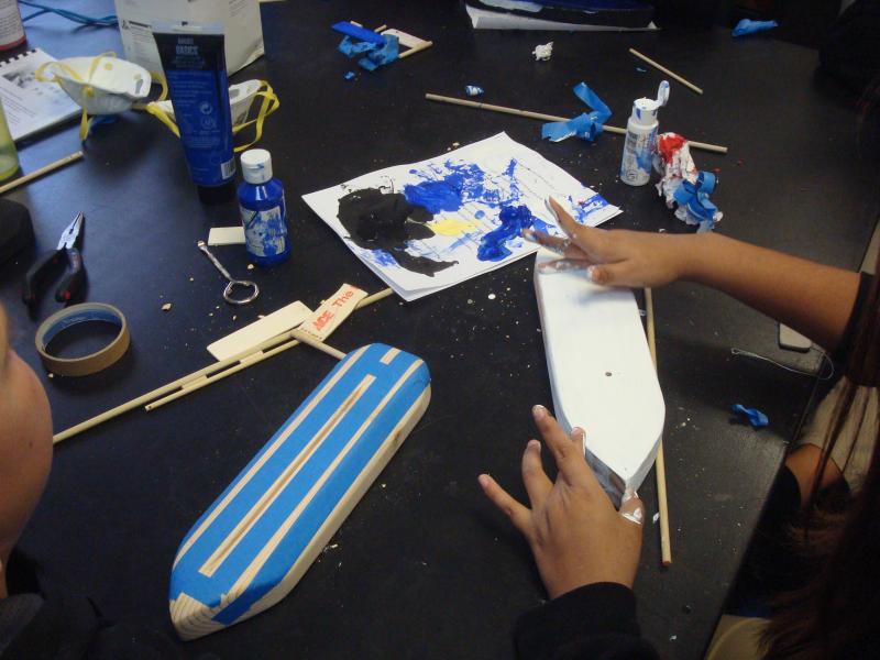

Day two, and I'm still breathing! Today we had the task of wrapping and epoxying the tillers to the rudders. We sort of stitch the two together with kite string, tack the string in place with ca, and then epoxy the whole joint. You can sort of see how it looks to the right of the first pic. Then it was on to drilling all the tiny holes in the tiny dowels with tiny fingers. It sounded at times like sailboat bandits getting together-- "Hey, somebody stole my keel!" "Take the tiller out of your ear, please." "Do not play swords with the masts!" You get the point. Then on to painting... which ended up way more bizarre than I first thought. We found some acrylic paints, and... well... you can see the pics. Tomorrow we have to get two coats of the varnish on the hull and sticks, and start cutting out and fitting the sails! Homework today was to bring in a garbage bag. Geez-- I just remembered I didn't specify UNUSED garbage bags... :doh:
