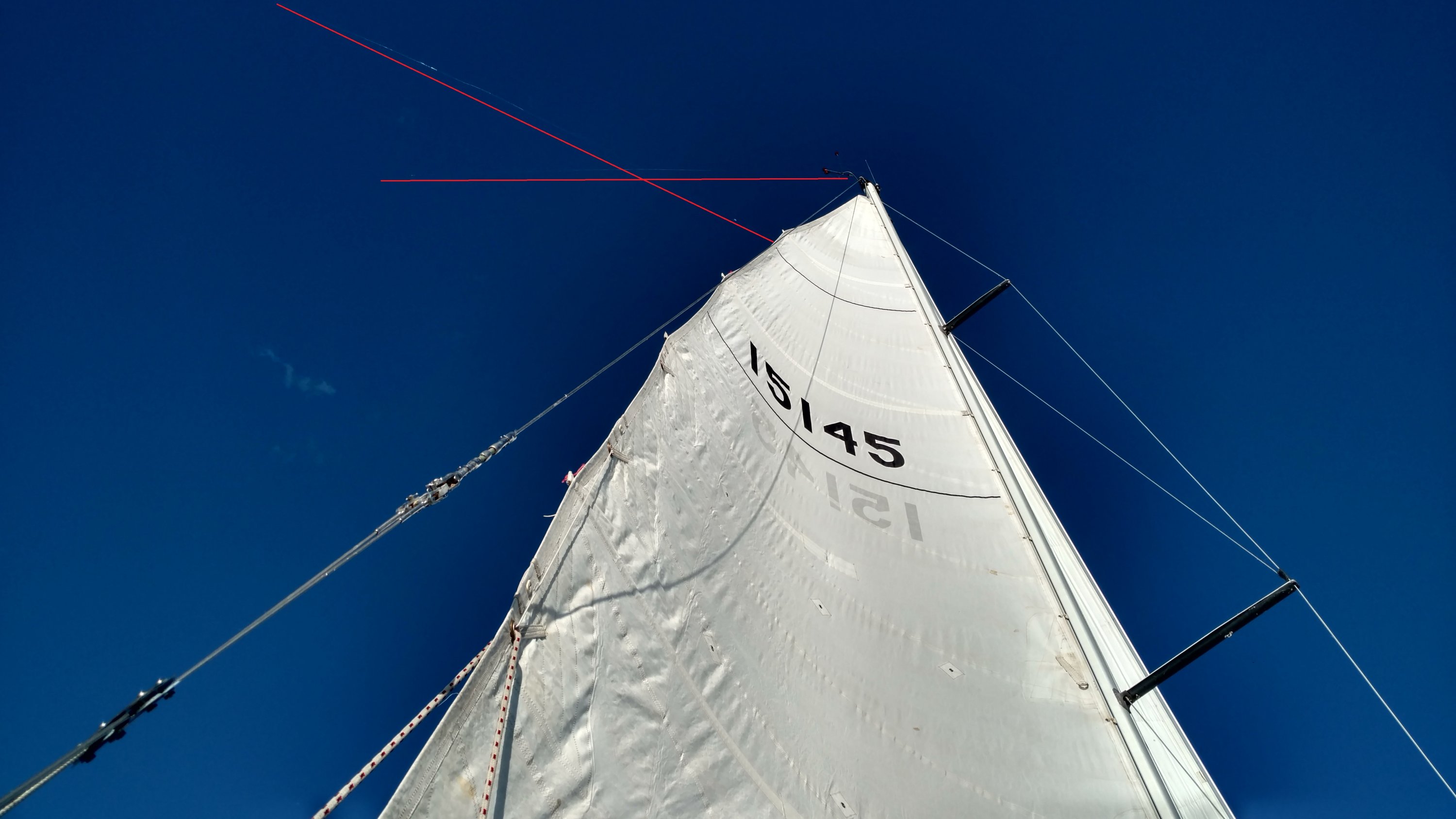

I frequently read that for proper sail trim, the top batten should be parallel with the boom. When the batten curves as in the following picture, which part of the batten is being referred to?
The red lines are highlighting captured migrating spiders. The top web is off the windex and is aligned with the pointer. The lower web is close to the batten in question. Notice none of my telltales are flying but the web shows no sign of turbulent air coming off the sail.
Obviously I am close hulled, the travel is full to windward with the boom on the centerline. I don’t think I had the backstay on at the point this picture was taken.
So what’s up, what should I be doing differently (if anything) to properly line up the top batten and get my tell tales flying?

When the top batten is not a full batten, it should be parallel. That means the leach of the sail is properly tensioned. With a full batten, it is a bit more difficult because the batten follows the curve of the sail. Better to rely on the tell tales.
Ease the mainsheet and raise the traveller. That should take some pressure off of the leach of the sail and allow the top batten to fall off a bit and align better.
When close hauled, the boom should be at centerline or a little above. Use the traveller to center it. Then trim mainsheet until the telltales stream aft. It may be necessary to go back and forth trimming the main sheet and adjusting the traveller to get it right. If things get really screwy, just ease everything and start over.

It also looks like your reef line is a bit tight, cupping the leach. Loosening that should improve the shape of the sail some.
I didn't notice that while on the boat, but now, looking at it, I'll definitely loosen it some for the next sail.

As a guideline, the last 1/3 of the top batten should be parallel with the boom. As a guideline. Just like your windex is. The real gauge of trim are your telltails.
But be careful. Many of the reasons that you cannot get your batten parallel with the boom are not trim related. Causes:
Batten to long
Batten to short
Batten to stiff
Batten to soft
Batten in backwards
Sail blown out.
