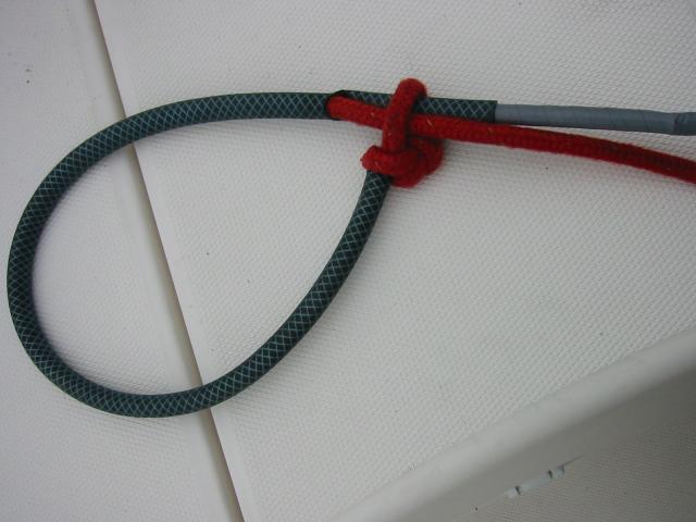

What I do is to have the inboard end of the warp on a winch. Then I put a hangman's noose over the nearest dockside cleat and pull or wind the slack in. Presto we are moored without anyone needing to go on the dock or risk breaking their ankle. We use the motor ahead or astern to maintain best position alongside. Also if it all goes wrong your crew are still with you and no lines trailing over the side. Now there is plenty of time to hop ashore with the mooring lines and finish the job nicely. This way we leave our main heavy all weather mooring lines on the dock
