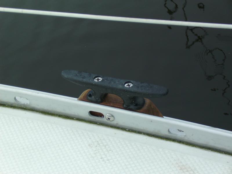

Woodster. I have the Johnson mid ship toe rail cleats on my H31 and they work great.
thanks that what i wanted to here i have been thinking about these for a while and now will give them a try thanks

FWIW, I wanted a midship cleat that was at least as strong and had the appearance of OEM that matched the bow and stern cleat. Lots of options discussed here.
Our genoa track is inboard from the toe rail, so for our boat model that would be a hazard and not near as strong as a toe rail cleat. I really like my solution, which has worked very well for solo docking and casting off.

Thanks Terry. I was concerned about the strengths of both the toe-rail and jibsheet car track options relative to drilling and bedding a regular cleat.

I would defer to Hunter Marine relative to using the genoa track as a mooring point.
Hunter Marine did tell me that a toe rail mounted cleat would be plenty strong, as strong as the bow and stern cleat that is also mounted on the toe rail.

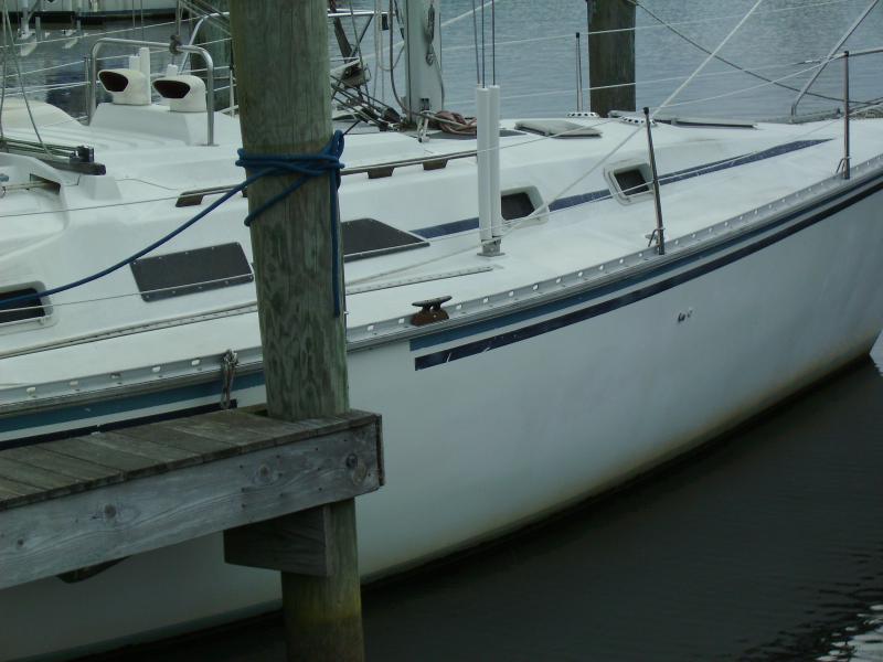

I know of another H34 around here with cleats mounted similarly to yours, Splax, except he used a block of aluminum to raise them up enough to clear the toe rail. hey have worked well for several years.
I used an aluminum block as well to mount my midship cleats on my 35.5 on the toe rail.
