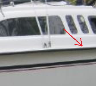

On our ’07 Hunter 27, we have bow and stern cleats, but no cleats midship. I have always felt they would be useful for spring lines instead of running them off of the existing cleats, and while attending a boat show last weekend, I saw a ’15 Hunter 33 – from the same design era as our boat – with them. I realize they aren’t essential, but I’m determined to add them anyway. The next issue, however, is placement.

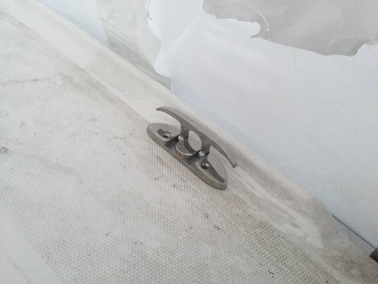

No doubt, one reason our modest boat doesn’t have them already is there is little room enough to go forward without stubbing toes on cleats. To help avoid that problem, at least while away from the dock, I’ve gotten 6” folding cleats. Sure, I’ll manage to kick and curse them even with the low profile when folded, but at least it helps reduce the problem. I could have gotten retractable cleats, but I don’t have a lot of interior room to sink them without being seen.
The obvious place for them is on deck near the rub rail, halfway between the existing cleats. However, I’m wondering if I can eliminate the stubbing issue entirely by installing them on the hull just below the rub rail. I guessing the hull isn’t as thick as the deck, but, certainly, I’ll using backing plates wherever they wind up going. The side of the hull is less convenient, but I only plan to use them while docked, so access while underway isn't a big issue.
Thoughts?
Hi Kevin, if it were my boat I would not mount them on the hull. Best place would be as close to the rail as possible. Contact the maker to determine whether they recommend any special way to mount them. Sometimes there might be a backing plate already molded into the deck where you want to mount them.

VT, I put them on our C22 last year, followed Stingy's location recommendation, measured the boat's length at waterline and dropped a plumb bob at the midpoint. Installed close to toe rail exactly as in your first pic, with plate or BIG thick fender washers below. I wouldn't put 'em on the hull for sure, that would be problematic, and even dangerous sticking out there when docking. Great for springlines and ease of docking, wish I'd done it sooner, the retractable ones have merit to avoid toe stubbing if that concerns you....fwiw

The hull is not reinforced for this use. It is likely only 1/4” fiberglass. A good storm will leave you wishing you had not done it. Likewise, someone will leave it out one day, and you will tear it off against a piling. Eventually, something will catch it.
Your toe will heal. Let’s rehearse: “Cheese and rice that hurts!”
The deck is the place.

Even though you described your boat as modest, you still need to consider Mother Nature. She will not check your boat before letting the winds blow.
As @capta has eloquently described a mid cleat is a valuable tool. They should be strong. The hull will not survive a big blow with the mid cleat lashed to the dock even if you put a back plate.
The deck is the place to locate it. You can always wear close toed sandals if you really need to. I agree with Capta. Before too long you’ll know not to bang your toe or if a real slow learner you’ll just have them removed and all will be well again.
No to hull idea. Yes to deck. Send @Crazy Dave Condon a message. He knows things.
