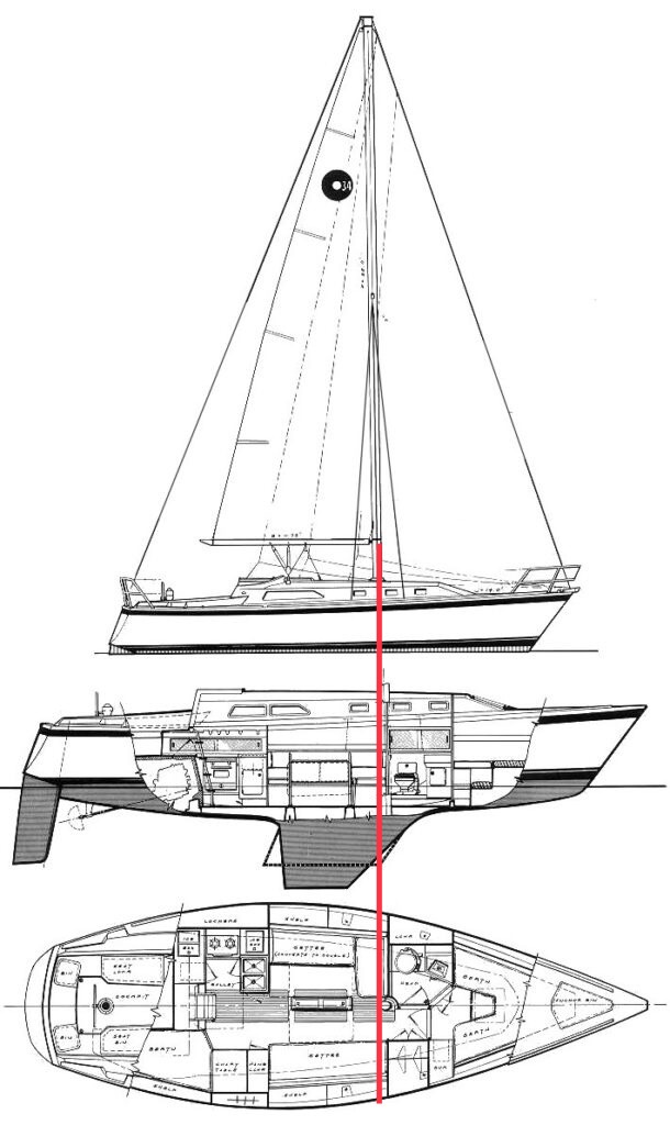

I would put my mid ship cleats aligned with the red line as shown on this image of an O'Day 34.
Note it is located in line with the mast base, between the shrouds and in front of the hull mid bulge. This locations works with the boat shape and center of gravity to provide the benefits generated by a spring line.

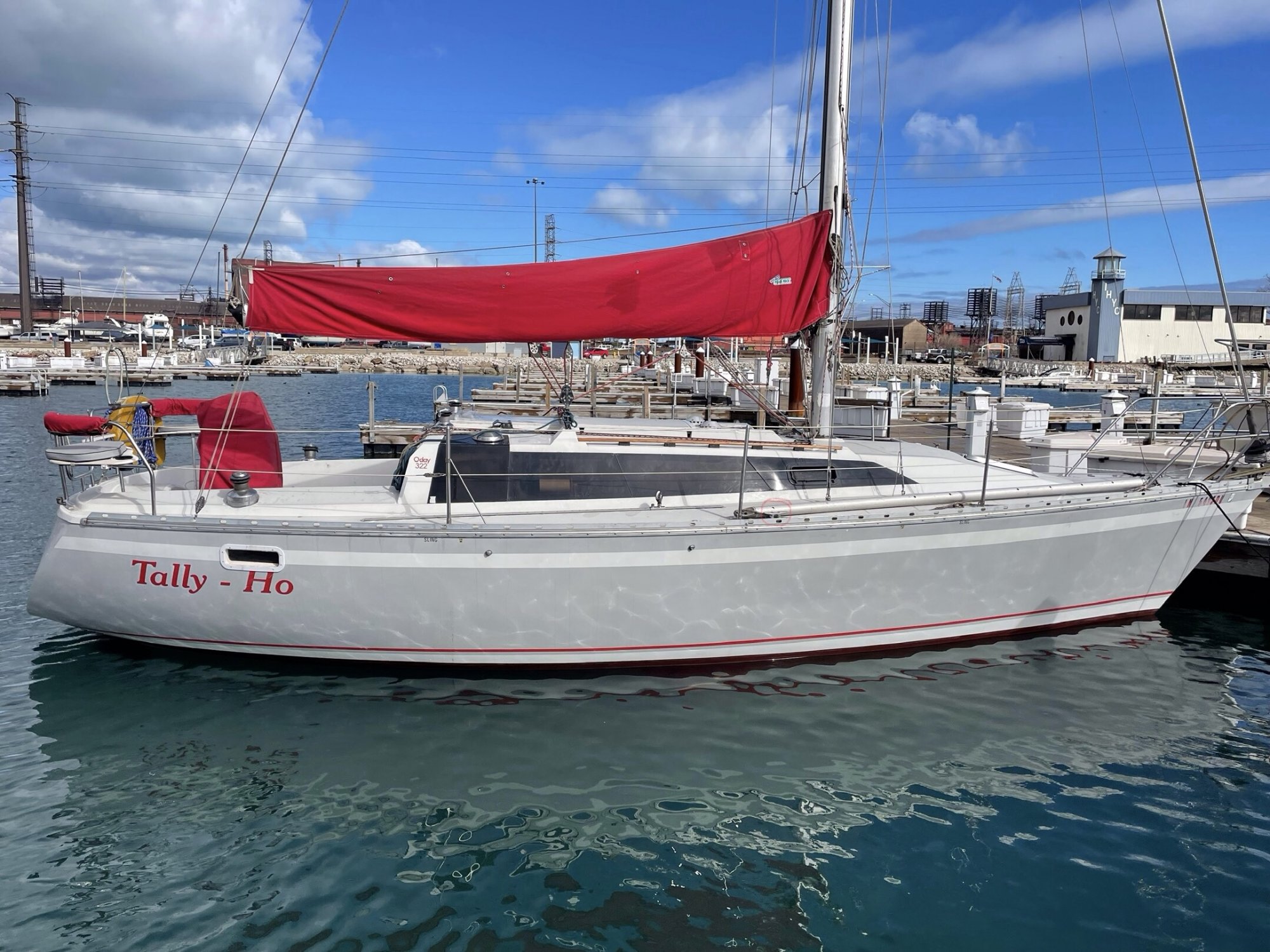

My 322 has had mid-ship cleats added. There is a spacer to raise it up to the toe rail.
if you blow this up, you can see the location by the end of the spinnaker pole.
