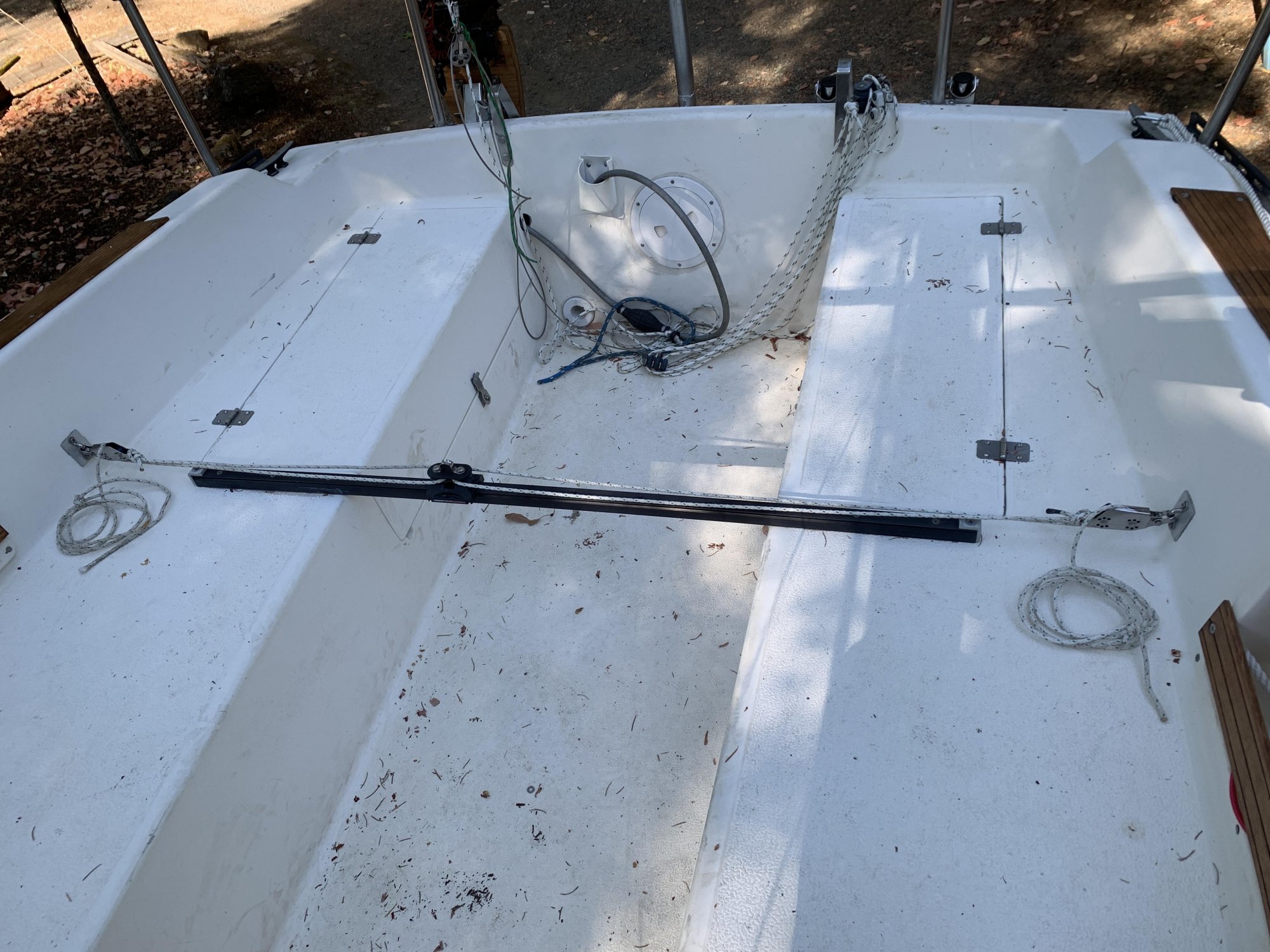

Just curious how many who have a traveler on their 20'-26' boats actually use them on a regular basis. the concept for their use is certainly a valid one, but in actual use they just seem cumbersome to me. I always single hand sail, so perhaps that factors in with so much else going on at the same time. for those that use them do you only set it when on a longer tack, or do you use it too control puffs and lulls as well? just curious.

I actually added a traveler to my Hunter 26. I also single hand and….. that was the best mod I have made on that boat.
Done right, you can keep a boat on her feet longer before needing to reef. Reefing single handed vs. setting a traveler single handed….?!?!?!?! YMMV
