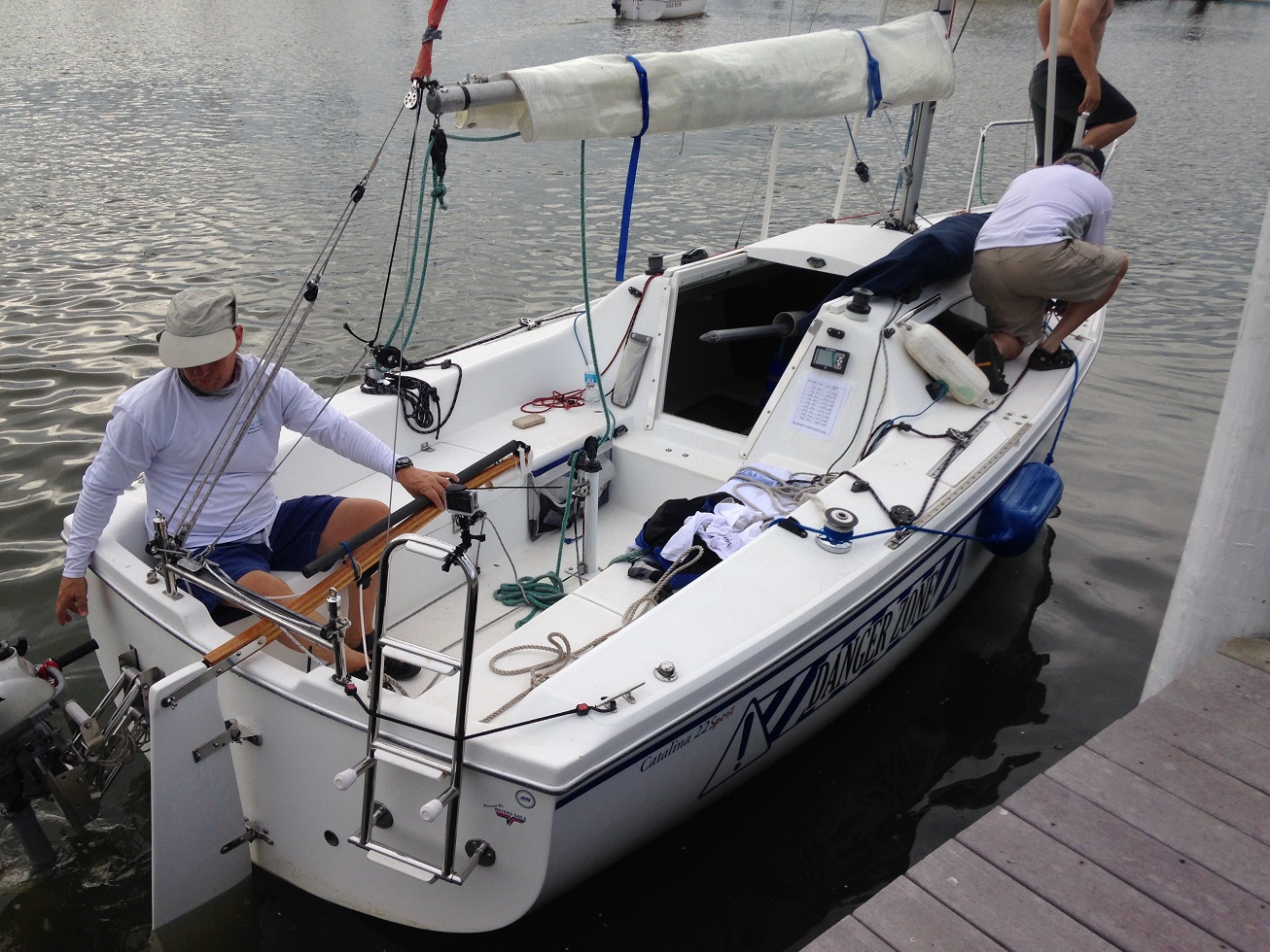

The racers usually have the main sheet set up to a barney post in the cockpit, so they do mount a turning block, usually a couple feet from the rear of the boom. . Been sailing a C-22 for many years and never seen a need for a brake on the boom, In my opinion, a lot of those gizmo's the big boys use don't always equate to a need on a C-22. When gybing I usually just hold onto the mainsheet lines as the boom swings across. Those occasional accidental gybes are usually cause by my lack of attention, and are not a big deal. I have used my vang occasionally as a preventer, one of the reasons why I have a snap shackle on the lower fiddle block. Simplicity is the beauty of a C-22. Attached is a photo of a C-22 Sport set up for racing at the 2014 C-22 Nationals showing the mainsheet system the racers normally use.

Good suggestion about a snap shackle on the vang. I'll have to try that (it would make it a little quicker to raise the pop-top too!) That's an attachment point pretty far forward of even the racers' mid-boom sheets. And, at least @CaptDon01 hasn't lost the boom yet. I don't know if I'll get around to rigging up anything new, but I have a couple more ideas now.
