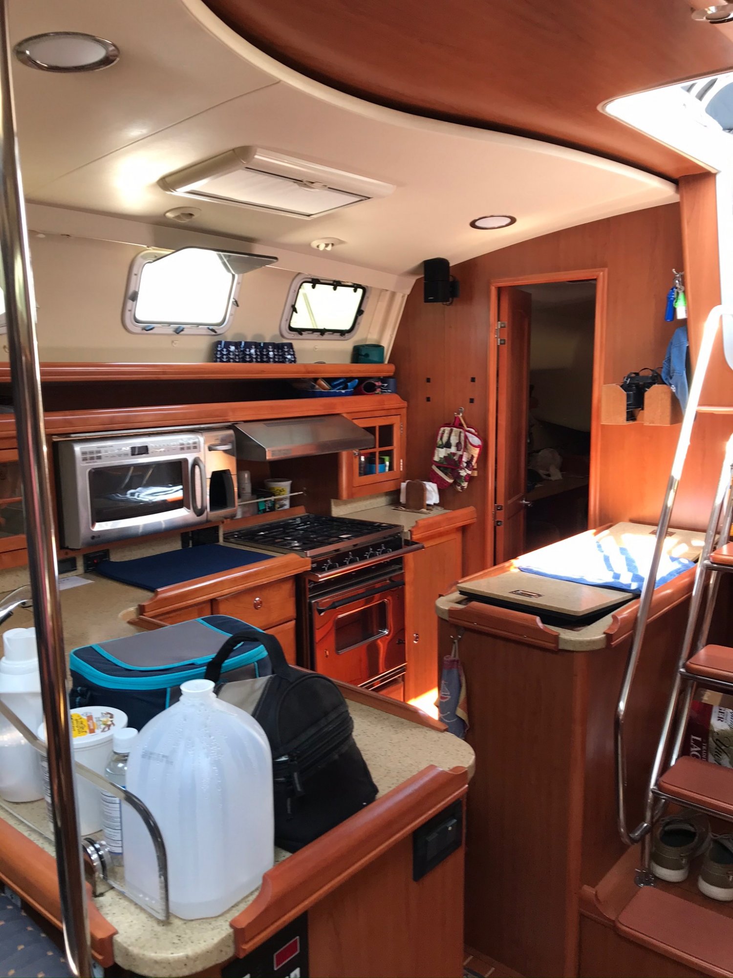

I have a 2008 hunter 49 ,and my microwave is not working properly. When doors is closed it still running.
anyone have same problem. Also has anyone removed and replaced same ,how to remove.

I have a 41DS, wouldn't be surprised if it's the same microwave or a substantially similar installation - can you post a picture?
I have replaced mine a couple of times.
Never had one keep running on its own though.

Will get a picture But it’s the one with coffee pot on side
